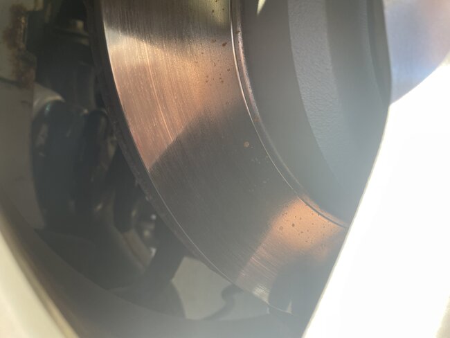

I just changed new brakes and rotors all around on my vehicle listed above Laredo, and I have these slight grooves on the driver side front of the car on the rotor. Is this normal to happen on one side only or does it happen at all when you first change brakes and rotors?

They are barely deep; my nail doesn’t go through it but if I rub my finger against it, I just feel them.

That sounds like something you'd never be aware of if you weren't looking there. You'll find those on almost every other car you look at. I don't think you have anything to worry about.

If there was something major wrong causing the groove, you'd be hearing it as a grinding sound, and the groove would get worse over time. If you're still worried, post some photos of it from a couple of angles.

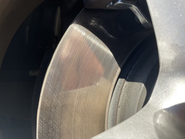

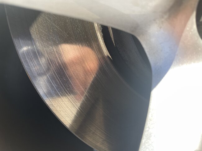

That last photo is the back rotor.

Dandy photos. There's nothing unusual there. In fact, in the second photo you can see some remaining sideways scratches that were put in with sandpaper to develop a non-directional finish. That breaks the grooves down that get cut in by the cutting bit on the brake lathe. Machined rotors end up looking like the grooves in a record album. We always try to take a very light final cut to minimize the depth of those grooves. They will wear down smooth over time, but if we leave them too deep, it can cause a pad to act like it's running on a screw thread. It will walk as far as it can, then snap back and start all over again. You never hear that because we don't let a rotor leave with that deep of a cut.
