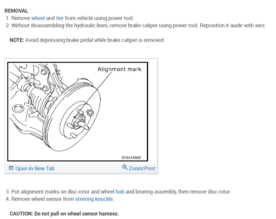

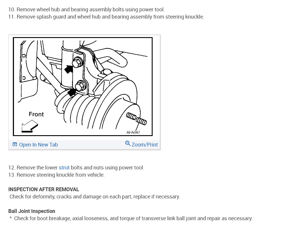

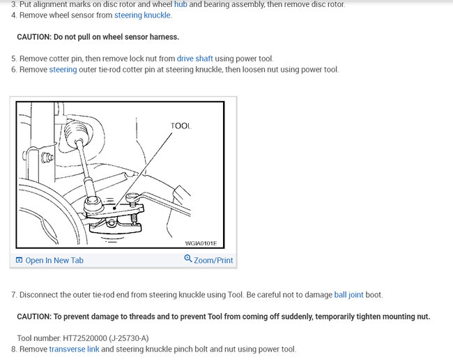

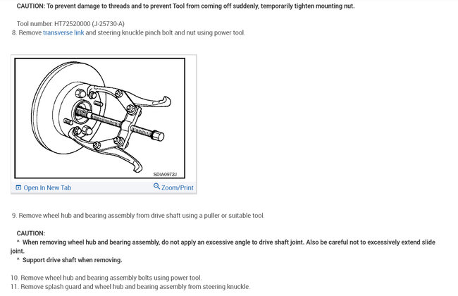

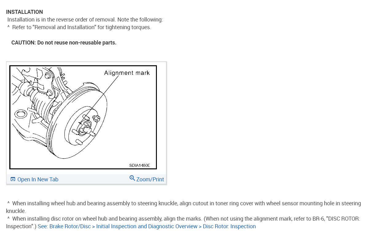

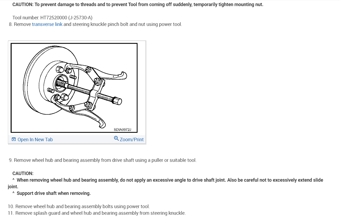

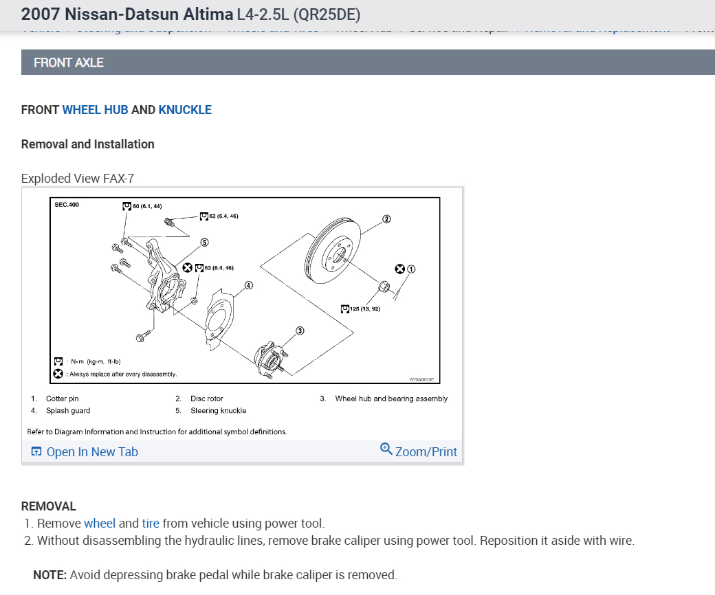

Did you do the brakes on both sides or just the one? Also, when you drive the car does the noise change when you are steering right or left? If so, I would say you have a bearing hub going out which is common. try to hear which side the noise is coming from and replace the bearing hub here are instructions in the images below. Check out the images (below). Also please start a new question for the trouble codes because we only handle one problem per thread. Let us know what happens and please upload pictures or videos of the problem so we can see what's going on.

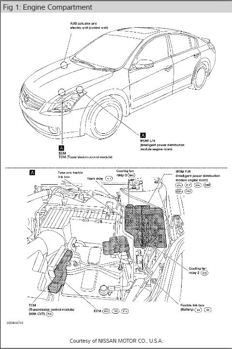

I have added an image of the location of the TCM for your reference.
My thought is the TCM wasn't getting enough power and could have caused issues in the transmission. I will say it is strange it happened 3 days after getting tires put on.

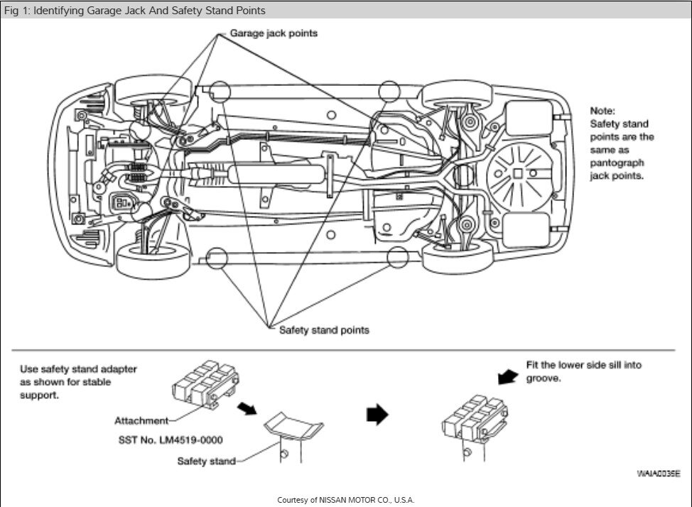

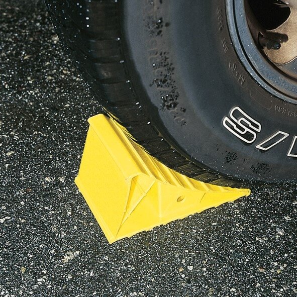

Next, I would chock the rear tires, jack up the front, and place jackstands underneath the vehicle. With the vehicle in neutral spin your tires by hand and see if you can hear if the noise is coming from one side or the other. I have added a diagram on the best lifting points for your vehicle.
Then I would grab the tires at 9 o'clock and 3 o'clock and move it and see if any play. If so this could indicate a bad tie-rod or wheel bearing. Usually, a bad wheel bearing will make noise at anything above 5 MPH and get worse as speed increases. But I feel it is a good idea to check all of this to prevent unnecessary replacement of parts.
Then grab the tire at 12 o'clock and 6 o'clock position and check for movement the same way and see if there is any play. This could indicate a ball joint issue.
A bad ball joint or wheel bearing can cause the rotor to drag on the caliper bracket and make noise.

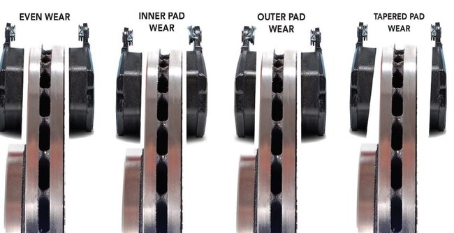

How did the brakes look when you took them off?
Where the pads worn evenly? I will add an image to help identify possible brake issues.
