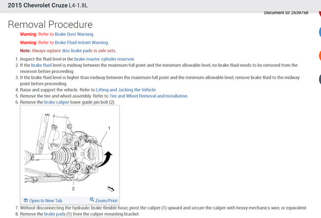

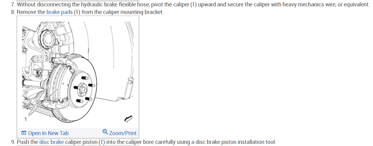

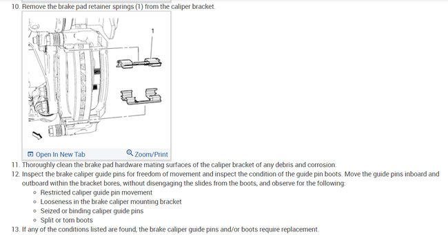

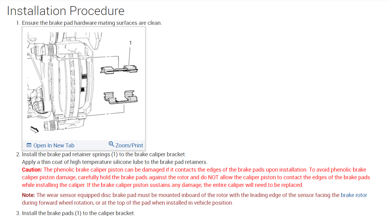

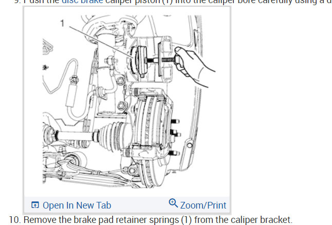

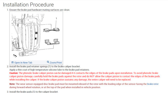

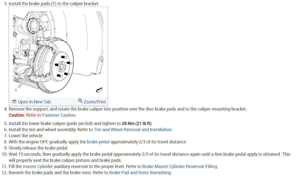

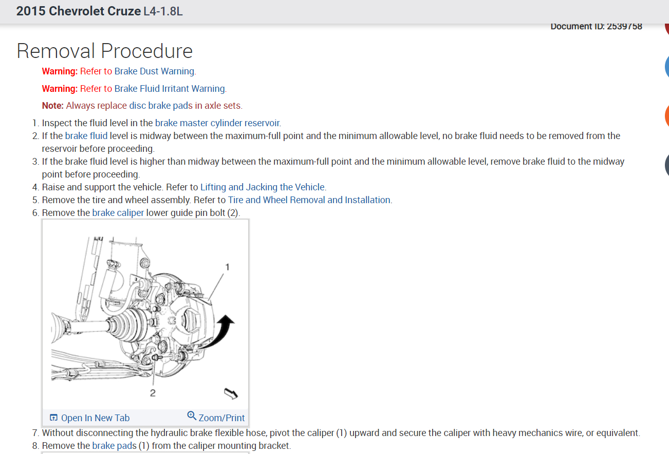

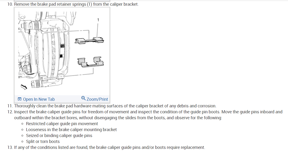

This sounds like it could be the engine mounts. To be sure can you please shoot a quick video with your phone so we can hear the noise? that would be great. You can upload it here with your response. Here are the instructions to do the brake pads and rotor so you can make sure the job was done correctly. Here is a guide to help you step by step with instructions in the diagrams below to show you how on your car:
