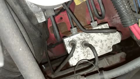

It is making an aggressive grinding sound coming from the driver side and it sounds like its coming from the back of the hood. Driver side further back if that makes sense. Let me know if you need clarification. What could be causing this and hopefully its a quick fix?
My buddy said it sounds like the solenoid is going but the starter isn't actually turning? He isn't a mechanic and he said he's not positive, he's mediocre but knowledgeable for sure. He could be wrong.
Any feedback? Would you like me to take a video of the noise?

Can you upload a video of the noise for us to hear?

You got it.

Okay, thanks. That is the ABS self-test. It is a bit loud but that is okay.

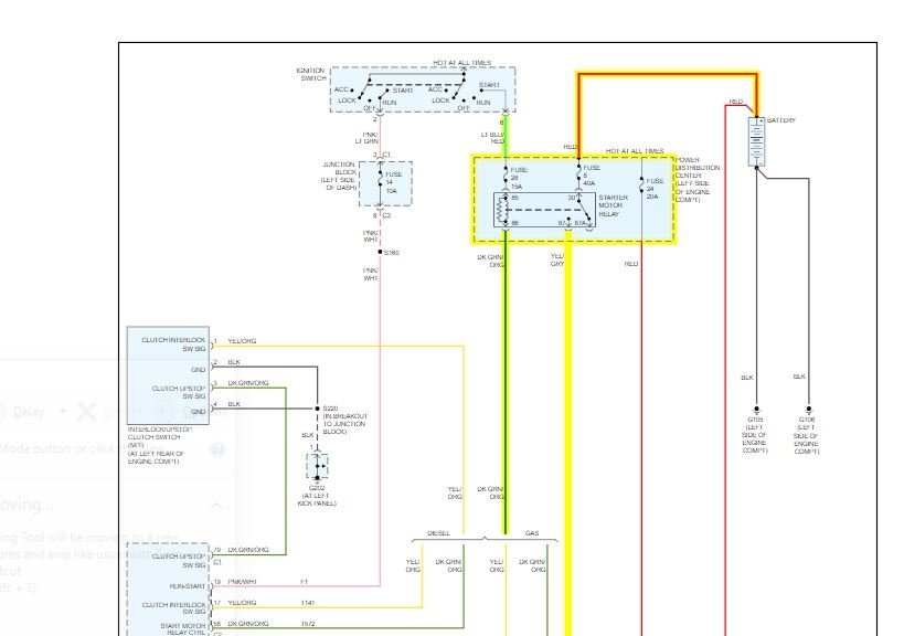

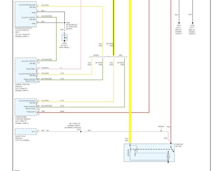

I attached a wiring diagram of the starting system. If you have a voltmeter or test light, we can do some checks.

We need to do some testing with the meter you have. Verify power to the fuse in the diagram I sent you.

Thank you, Roy. I can't read that very well, it's pretty blurry. Would taking my battery to get tested at Advanced Auto help?

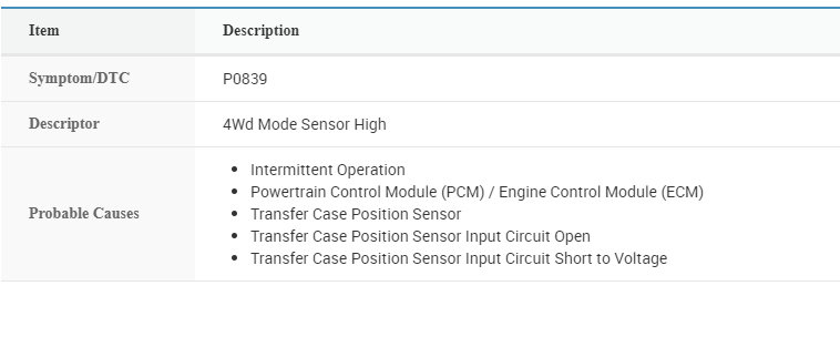

Charging my battery at Advanced Auto seemed to do the trick. My cars running, had to add some transmission fluid from the leak. The only code its giving me now is P0839. This is the code I am getting when I turn my key on three times, not from a code scanner.

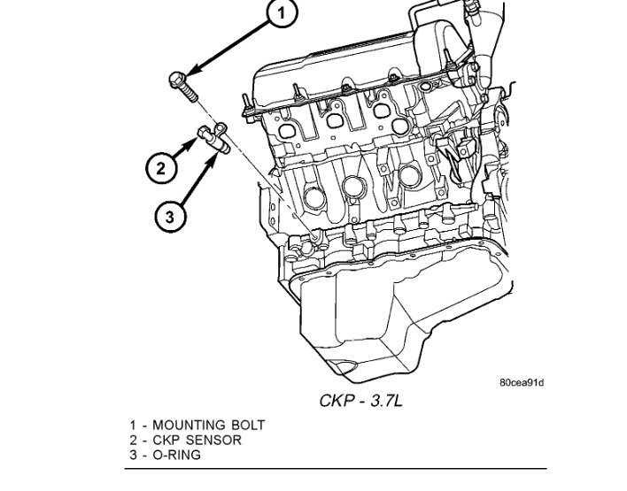

I was previously getting the crankshaft sensor code, is it possible that was an error code that is fixed now that I replaced an ignition coil?
I bought the crankshaft sensor so I have it new, I just don't know if I should replace it or if I could return it now that I am not getting that code. Thanks!

I would keep it and if the code returns, replace it.
The 839 is for the 4 wheel drive unit. I posted the possibilities below.
