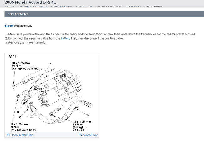

Yes, it's warm weather so it's not from the cold. For the past month or so, sometimes when I start the car it makes a grinding noise that lasts from 1 to 3 seconds and then starts and runs just fine. Just today I started the car, no problem. Got back in the car to go home and had that grinding noise. Not sure if it's the starting gear, battery, or something else. It seems like if I keep turning it on and off the grinding noise is shorter and then completely gone but what the heck do I know.
May 22, 2023 at 11:23 AM
  • 54,832 POSTS

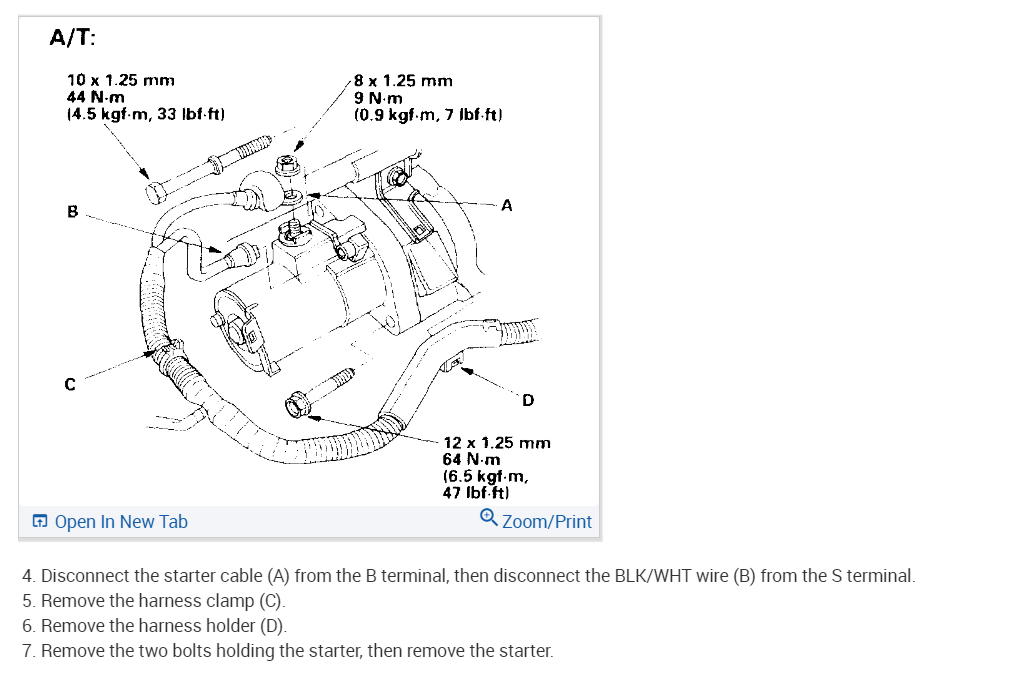

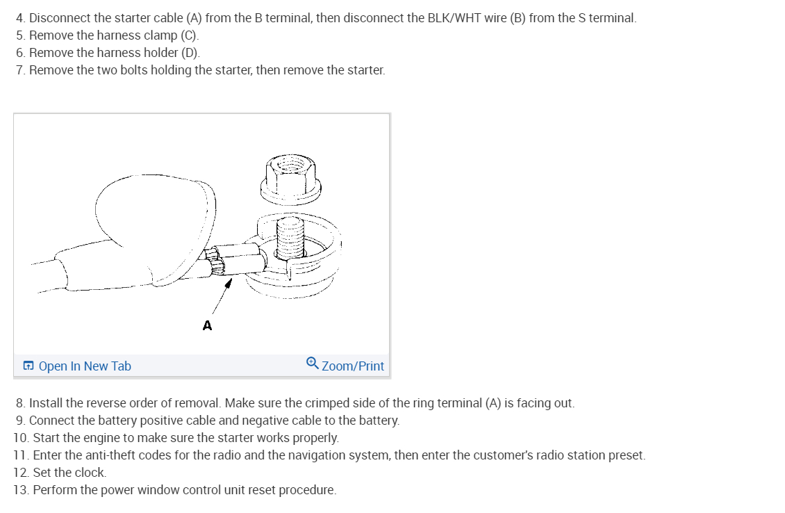

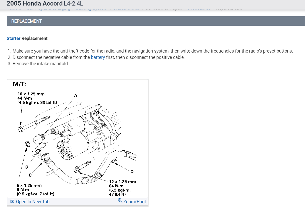

Can you please shoot a quick video with your phone so I can hear the noise? That way I can tell for sure what's going on. You can upload it here with your response. It sounds like the starter is going out here is how to replace it in the images below.
This guide can help walk you through the steps:
