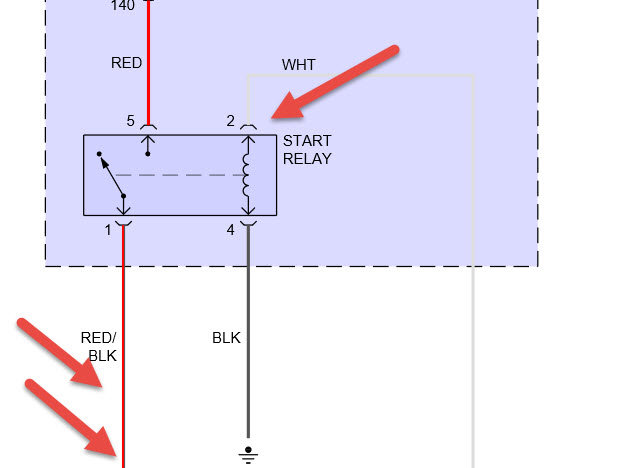

07 Tucson.. Grinding noise in park and neutral. But goes away in drive or reverse..also starts when ignition is in run position.. Sounds like the starter is engaging when it shouldn't be.. Replaced ignition switch but never solved the problem.. Any ideas anyone?.. Thanks!!

check starter relay for staying engaged or being bad then have starter checked as it may be the starter drive isn't going back like it should. also try giving a quick rev in neutral/park see if it goes away. see link.

Yes.....Starter is not disengaging..whatever it is it keeps burning up the starters...I tried another ignition switch but never solved anything..ill try the relay. Thanks!!

Replaced starter and ignition switch but never solved anything.. Never had a chance to check relay in the fuse box yet.. That's my next move.. Anything else this could be?

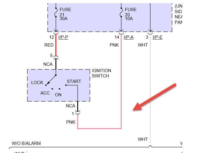

Whatever it is it's sending power to the starter when the ignition is in the run position when it shouldn't be. Is there a diagram on how to check the switch with a meter..Thanks!!

see pics if lwht wire is sending power to relay and pink is not sending to trans switch then the trans switch may be the culprit. dual arrows on one pic go from relay to starter. one arrow on same pic comes from trans switch.

With key on I assume?
Jul 30, 2017 at 6:05 AM
HMAC300
  • 48,601 POSTS
yes or in start position for one wire
