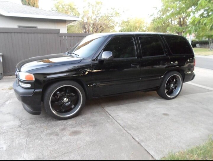

Seller is asking $7,500 for a 2004 GMC Yukon in good condition with almost 150k miles? They are open to offers.
They did black it out. I am unsure of the KBB value as I do not have all the details about the vehicle.

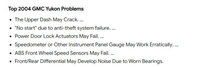

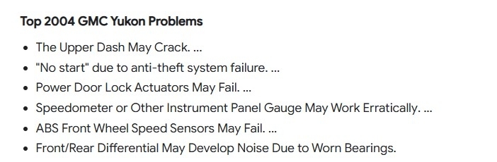

I couldn't tell you what kind of issues it might end up with, anything can break. Im not going to reference any other websites but do a Google search "issues that might happen with a 2004 GMC Yukon with 150,000 miles" and it will come up with a list of the most common failures for that year and mileage. As for me, I wouldn't buy one, but the search will give you an idea, this is the beginning of the list.

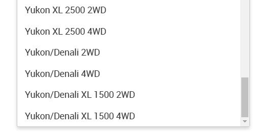

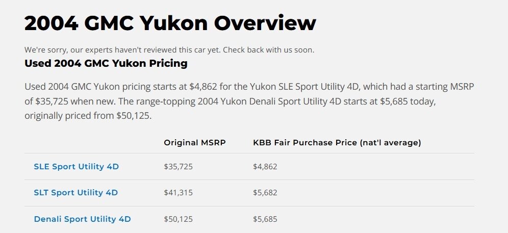

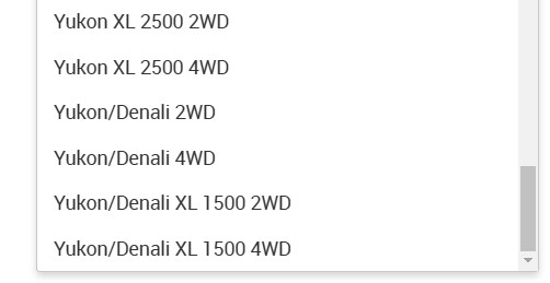

So, this is a basic KBB value I searched for, it varies a bit depending on the options the vehicle has, such as entertainment systems, it looks to come with two different V8 engines a 4.8liter and a 5.3liter. But this is the KBB national average $4800-$5600, so 7500 is above average for sure, as for someone coming with you, that I'm not sure of. It would be best if you knew someone who actually works on vehicles to come with you, since they would notice things, others might miss. The Yukon's come in quite a few different models (2nd list below) there's even a couple models that come with a V8 6.0liter and a V8 8.1liter which is a huge engine. But it might be tough to get the seller to come down by $2k. This is the info I found on KBB's website.
