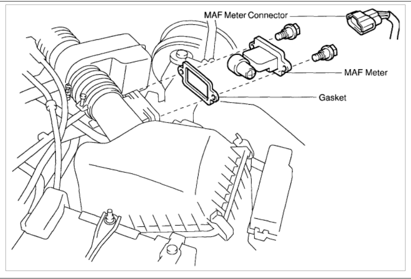

Have replaced; fuel injectors, fuel pump, fuel filter, air filter, PVC valve, spark plugs, plug wires, cam position sensor, all three ignition coils, all oxygen sensors. I have removed and cleaned the MAF sensor and the idle air solenoid valve. I have checked the codes with my code reader and have not gotten any. But I continue to have rough running and coughing from idle to acceleration. Seems to buck and surge when cruising at steady speed. Intermittent symptoms. Will easily rev to 6000 rpm's and have rocket-like acceleration after stumbling until about 2000 rpm's. I am going crazy trying to figure this out! Please help me!

It sounds like the MAF sensor is out. Cleaning these only helps sometimes if they are too far gone they will not come back. Here is a guide to help other see what you must do to fix the problem.
https://www.2carpros.com/articles/how-to-replace-a-mass-air-flow-sensor-maf

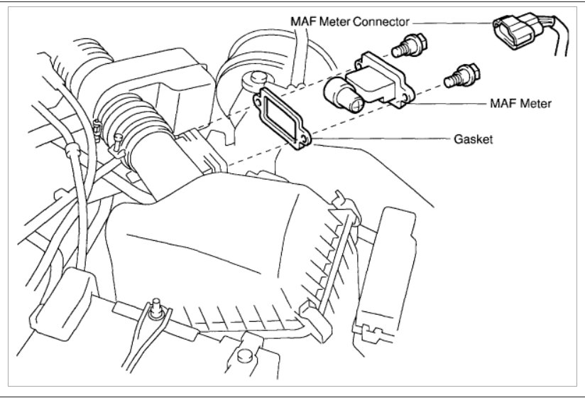

I replaced the MAF sensor with NO apparent change. I was hopeful when I discovered that the MAF sensor was not gasketed and I couldn't tighten it any further since it has shoulder bolts holding it in place. I tried sealing the old MAF with a gasket and a little sealant (silicone rubber). That didn't do anything. I then replaced the MAF with the gasket and that also made no difference. The car is running even worse, grey smoke when starting (not every time), hesitation, sputtering, coughing, surging. I'm at my wits end! Would you please tell me how to send you a video if you think that it would help.
