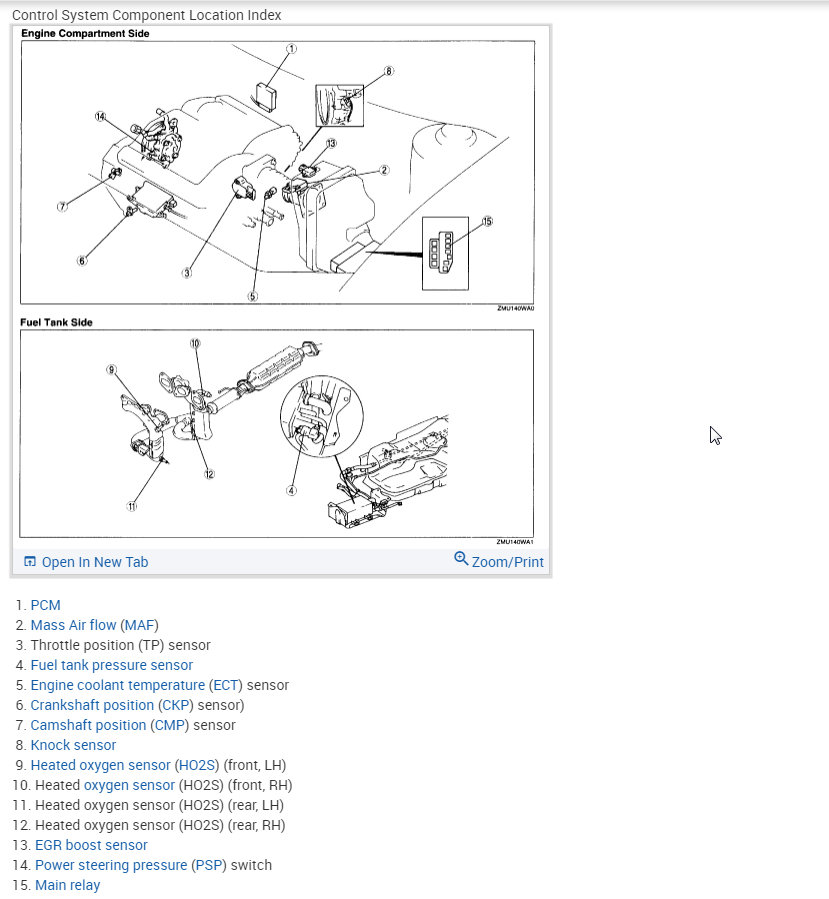

Okay, more than likely the o2 sensor is the issue. Before we get into testing these different systems, I would just swap the upstream o2 sensors from side to side. Once you swap them, clear the codes and drive it again and see if the codes switch to Bank 1. If they do then we need to replace the o2 sensor.
Clearly we can test them but this way is so much easier and definitive. Let me know if you have questions.

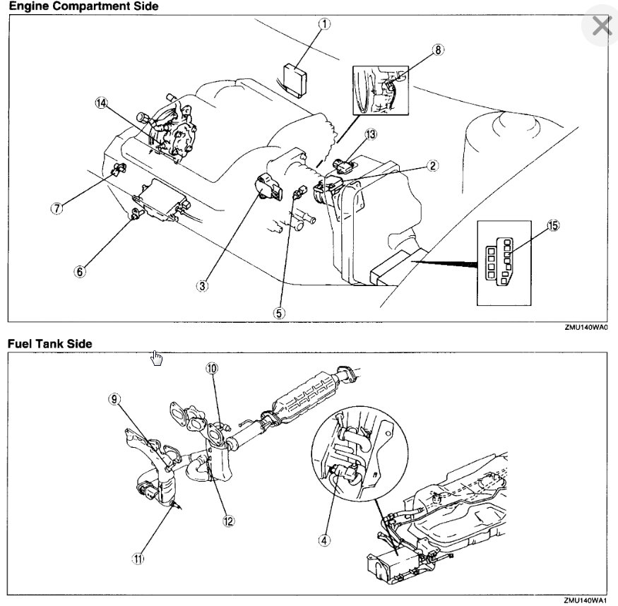

I got this done today:
Oct 17, 2019 at 11:19 PM
