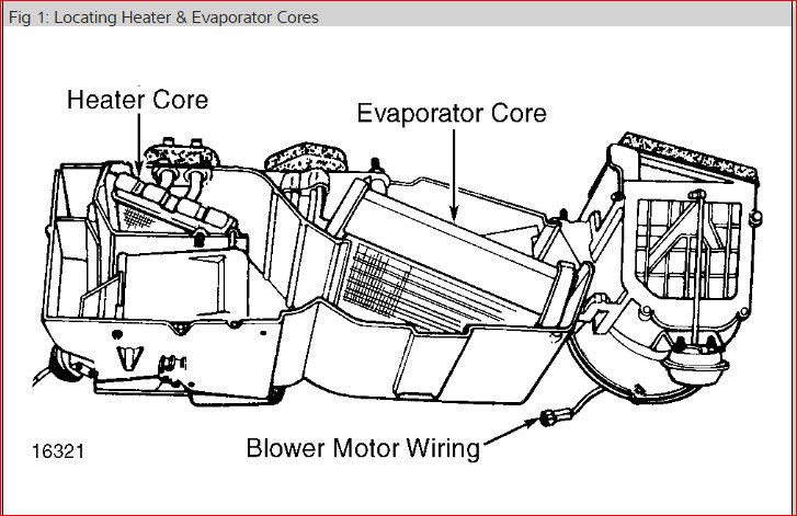

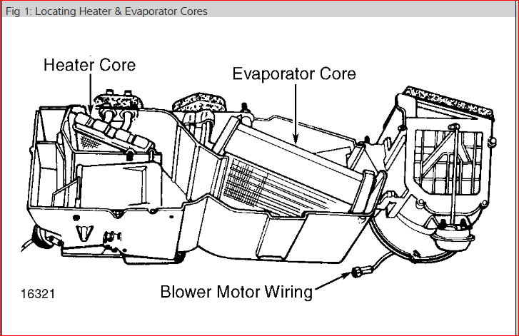

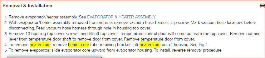

I need to replace the heater core in the vehicle listed above. I have disconnected negative battery cable from the battery, the heater hoses, and the A/C lines connection at the fire wall under the hood.

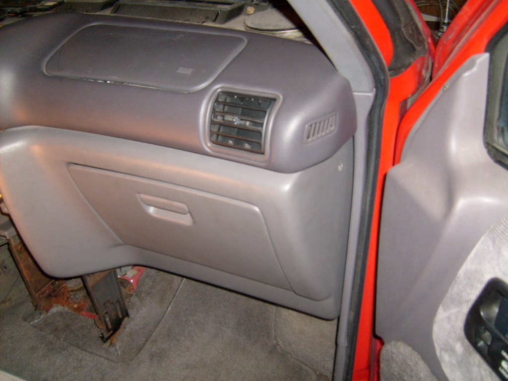

The struggle is removing the lower right dashboard to get access to the other fasteners for the removal of the heater-A/C box. I have the lower right and center bezel parts for the dashboard panel loosened, but there is something unseen holding the upper part of the lower dash panel. I am absolutely stymied.
More information: There are two panels to this part of the dashboard: The upper panel which houses the airbag; and the lower panel, which includes the glove compartment. I am trying to remove the lower panel from the upper. I have all the visible screws removed, and the lower panel is very loose, except that where the lower panel meets the upper panel, something unseen is holding it, preventing the lower panel from coming off. I am very sure these are two separate panels, as there is about a 32nd of an inch seam opening between the two. Any help would be appreciated.

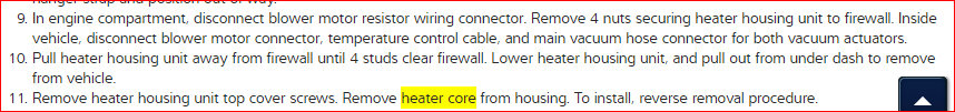

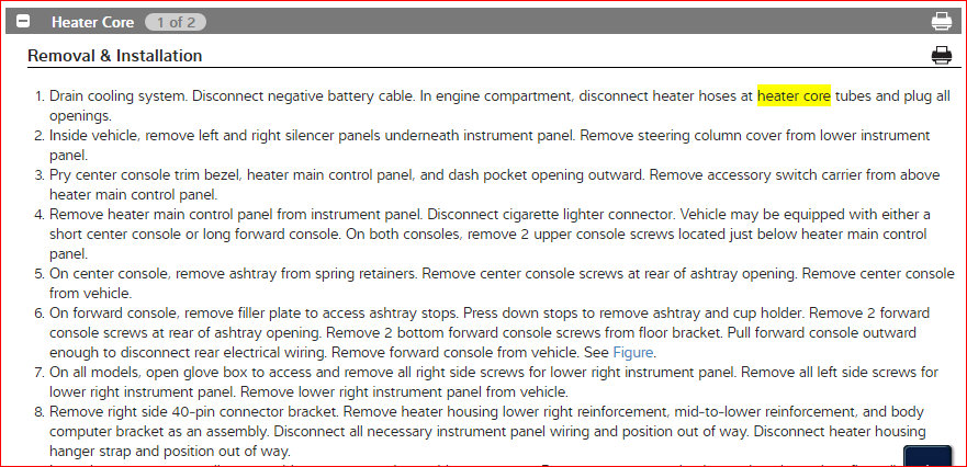

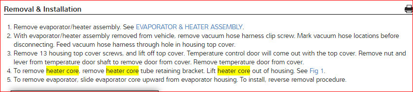

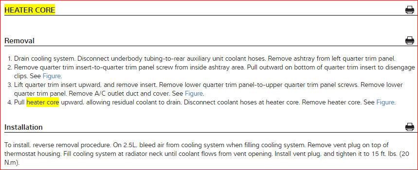

I've attached a tutorial and step-by-step pictures on how to remove and replace your Heater core. Hope this helps and feel free to ask any questions if needed.Thanks for using 2CarPros.
Danny-
https://www.2carpros.com/articles/replace-heater-core

Thanks for your help with this. I've read and re-read your answer and all the info that was attached to the answer. It's clearly presented, and I understand all the steps. Unfortunately, it doesn't answer my original question: How do I detach the lower right panel that has the glove box from the upper right panel that has the passenger side airbag. Because without doing this, the whole process of getting access to the HVAC box is stopped.
Oct 24, 2018 at 10:05 AM
  • 55,694 POSTS
Remove the glove box door and you should see the main bolts that hold the dash to the car did you remove the upper screws as well? Please send more picture of question and I will walk you through it. Cheers, Ken
