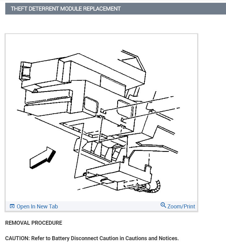

This morning I found that the battery (fairly new Interstate...) had run down to nothing and my keyless entry wouldn't open the doors. I manually opened the drivers door and could hear a clicking noise under the dash. I have traced this down to the RCDLR module. I was able to disconnect the unit, my door locks still work with the door buttons. I had removed the battery from my fob / transmitter to make sure it wasn't malfunctioning. So basically, the cigarette lighter, lumbar adjust, gauges and everything on the circuit still works, I've just lost the ability to remote lock / unlock. My question is, are these particular modules known to fail, or is it more likely that a bad actuator is sending a faulty signal to it causing it to cycle? The "clicking" was about as rapid as if I had the flashers on. Constant. Any help would be appreciated, as I can't even locate a GM part number for this part. I might also add that it's in an EXTREMELY difficult spot to get to under the dash.

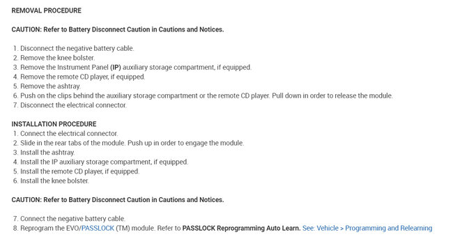

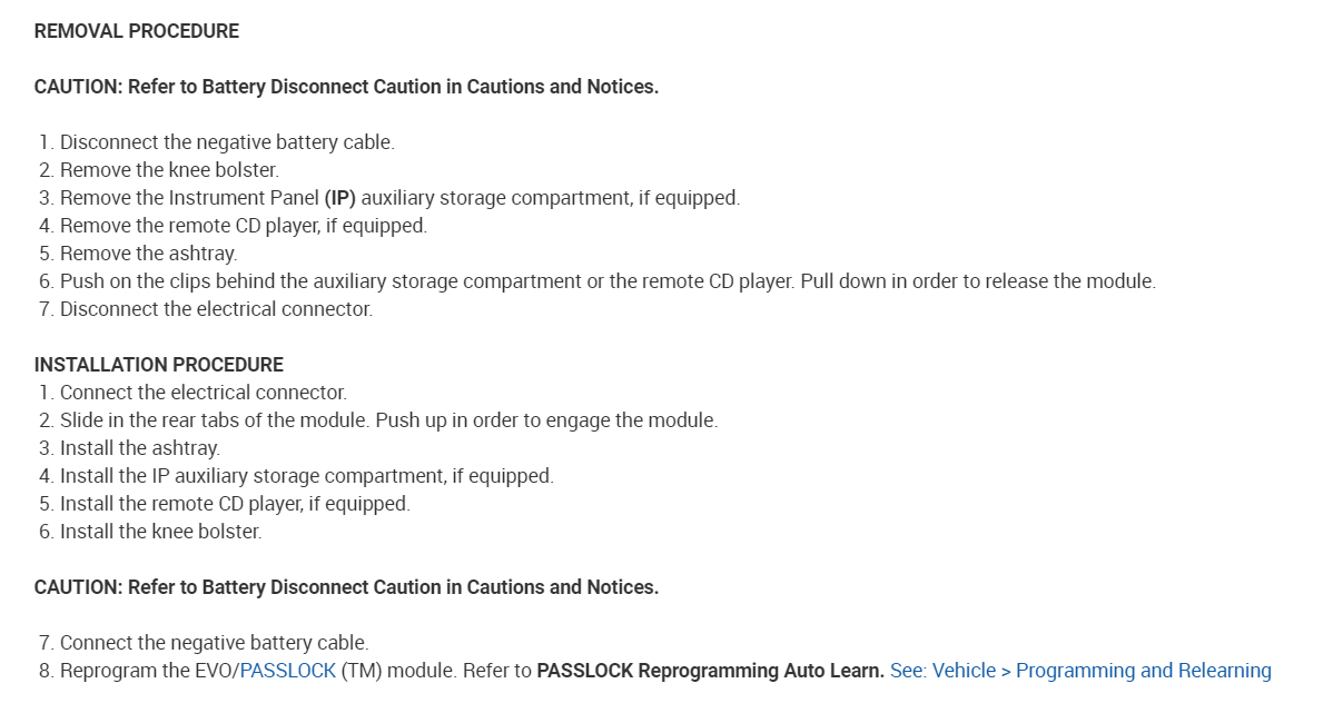

It could need to be reset, here are the instructions and how to replace it below.
