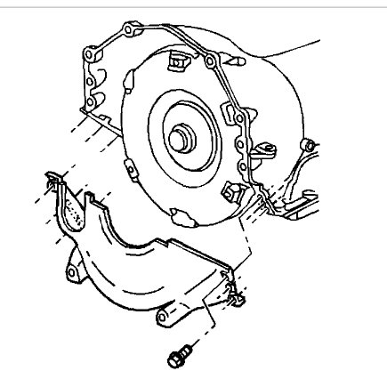

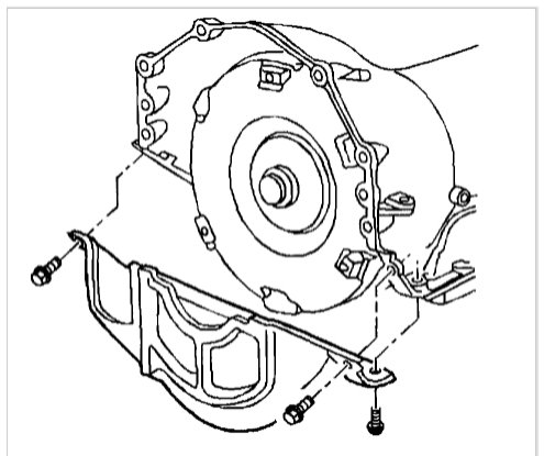

i put it in drive it just made the loud grinding noise from underneath the truck?
1998 GMC TRUCK
127,000 MILES • V8 • 4WD • AUTOMATIC
ERNSTO_1515
i was wondering if the transmission went out or it hopefully something else. i broke down a couple of days ago, i went to go see what was wrong with it and i put it in drive it just made the loud grinding noise from underneath the truck and i wont go and where unless its in reverse or in 1 or 2 gear but in those two gears it still makes a very loud grinding noise but not in reverse. Thank u for any help.
Mar 8, 2009 at 10:13 PM
DANNY L
  • 5,648 POSTS
Hello, I'm Danny.

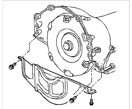

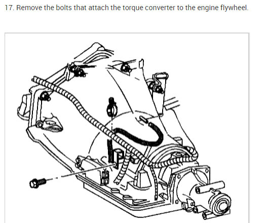

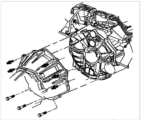

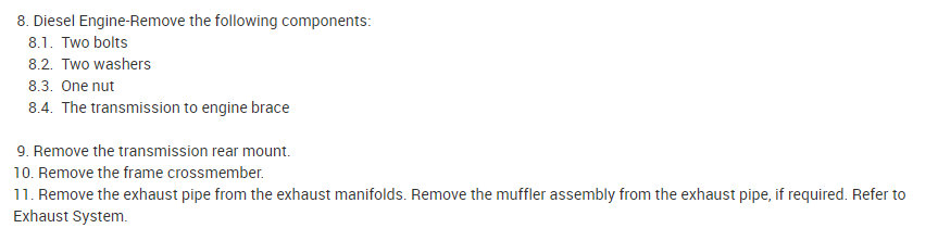

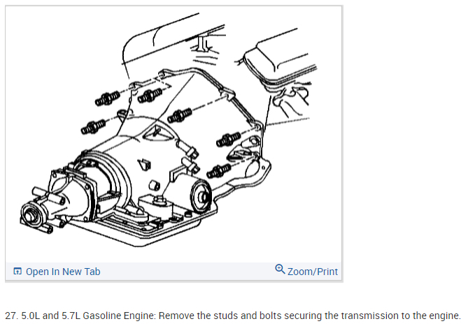

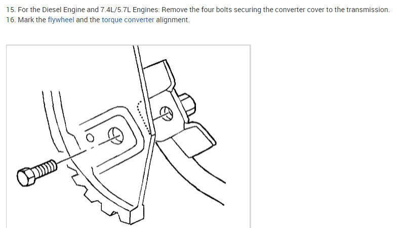

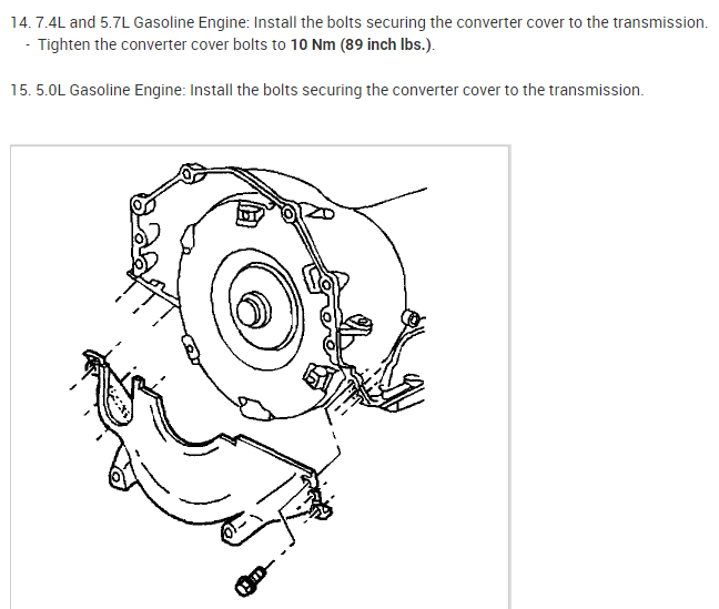

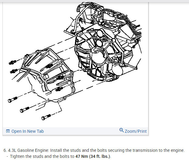

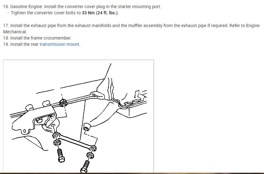

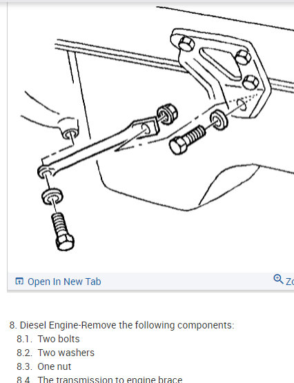

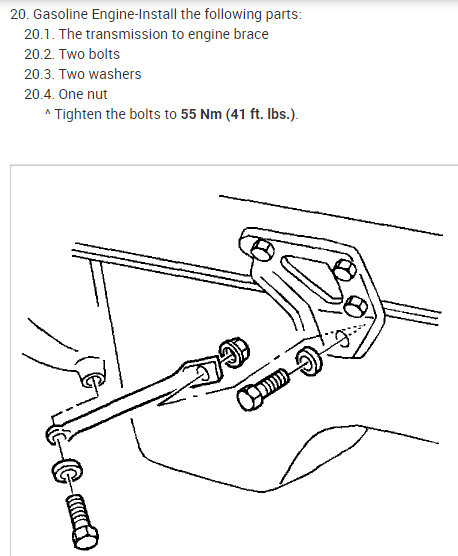

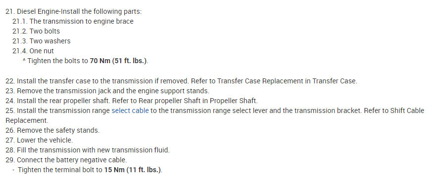

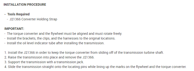

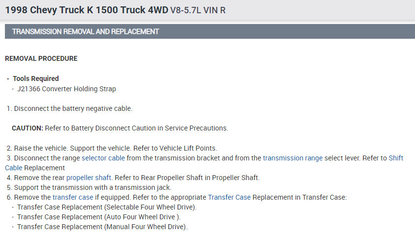

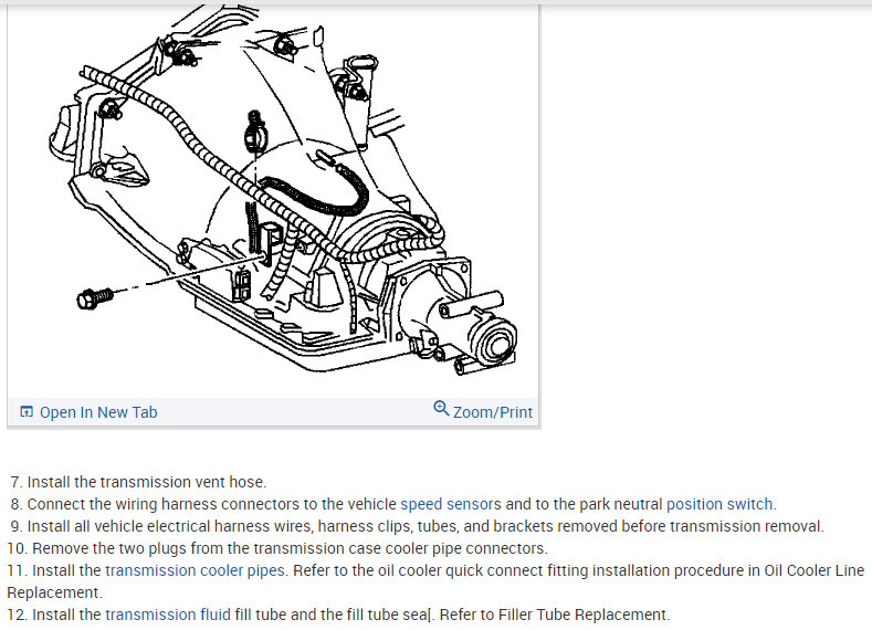

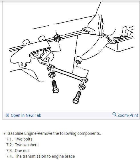

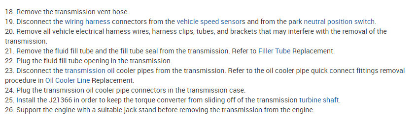

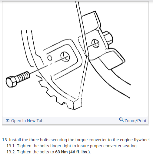

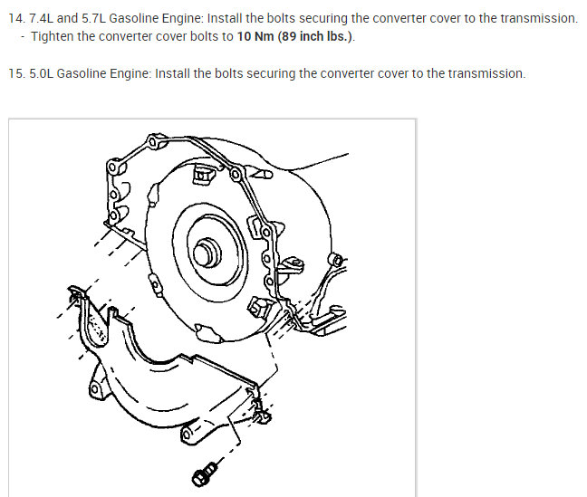

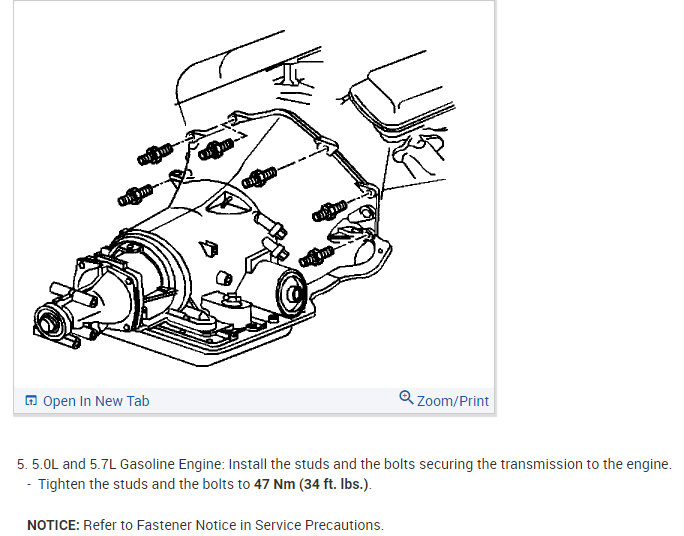

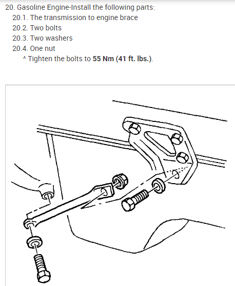

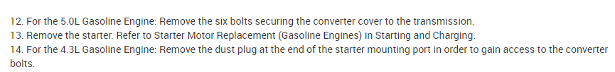

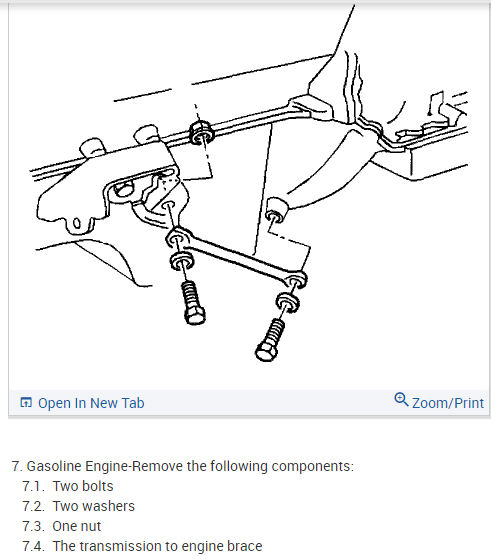

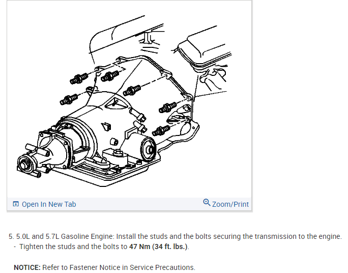

Yes, it sounds like you had an internal hard part failure. Just to give you an idea most transmission repair shops will not just do a quick fix but rather they will require a full rebuild. A transmission like your 4L60E will be in the ball park of $2,000.00 for a rebuild to give you an idea depending on your area and what kind of repair shop you take it to. Here is a tutorial showing how to remove and replace a manual transmission which is similar:
I've attached picture steps below on how to remove and replace the automatic transmission on your Silverado. Hope this helps and thanks for using 2CarPros.
