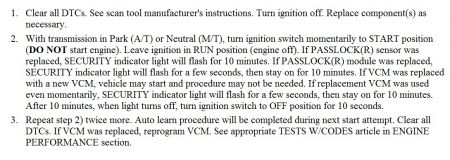

engine starts and immediatly shuts off

My first thought is the security system? Also, Use a gage and check fuel system. Any applicable trouble codes? If security issue, you can try relearn, don't know it will help?
https://www.2carpros.com/forum/automotive_pictures/170934_suburban_relearn_1.jpg
