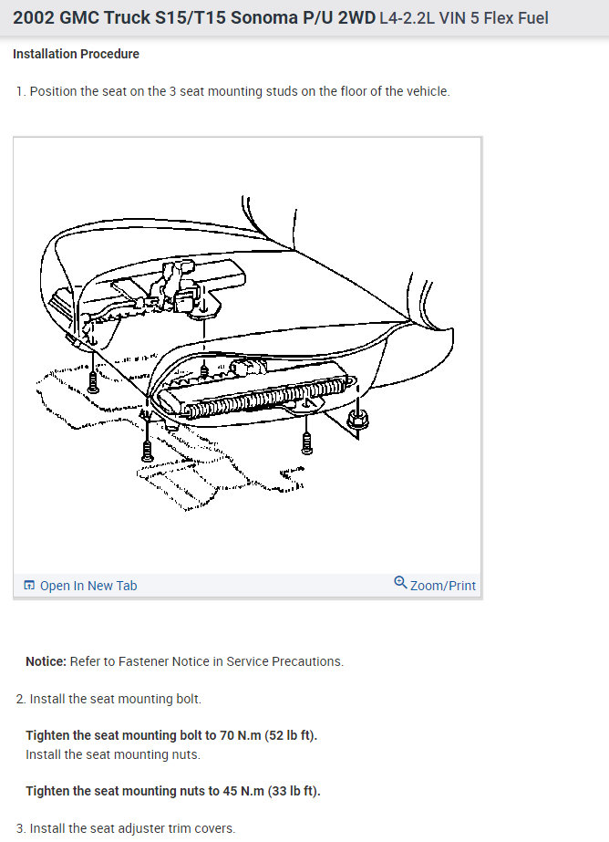

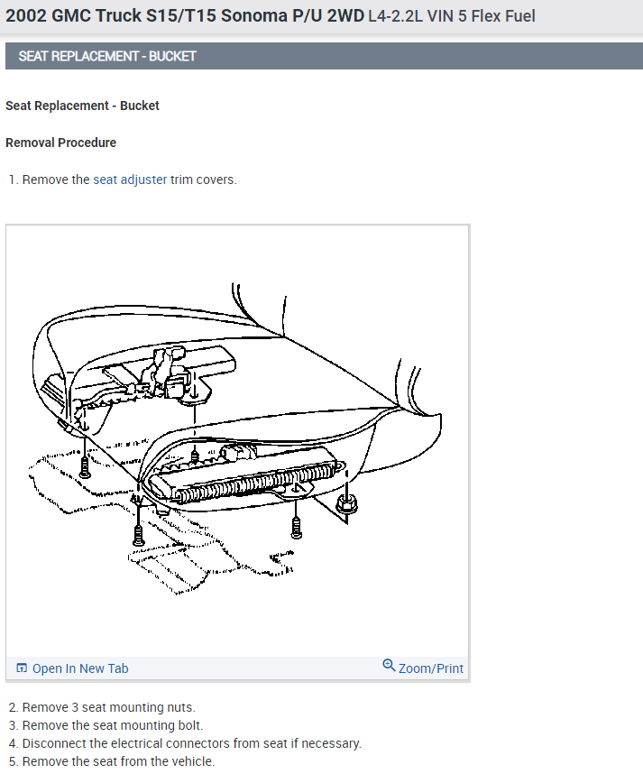

Hello my drivers seat just kills my back and I am wondering what other types of gmc seats will fit into my 2002 sonoma. I have several other gmc vehicles for work 2003 safari van/ 2004 canyon/ 2006 canyon/ 2008 canyon and all dont hurt my back but an hour in my sonoma and my back is toast. Thanks!

The seats out of any of the other vehicles are not interchangeable.
As the mounting components are different for these vehicles.
The best option you have is to get the cushions replaced with better supported materials and reupholstered.
There are many upholstery shops that do custom seats to fit their customers need. They will be able to custom make a cushion according to your preference.
