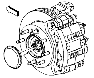

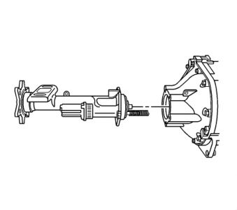

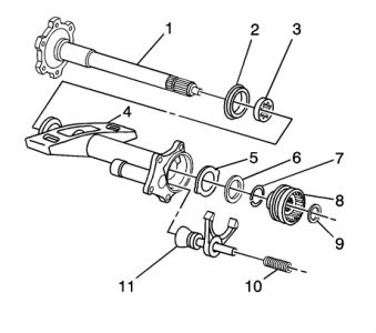

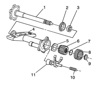

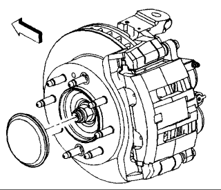

I need some help to replace my right front axle seal I read in my book it dose not sound to hard. But what is this about some spring and not to let some things fall out. Is there a clip to hold in the axle in the diff like there is in the rear diff. Anyone please help.
Oct 18, 2008 at 1:22 PM
IMPALASS
  • 3,112 POSTS
Hello Your vehicle has two different types of axles. 8.25 F4WD Axle and 8.25 S4WD and 9.25 Axles. Based off of what you said about a spring, I am could assume you know you have the 8.25 S4WD and 9.25 Axles, but I don't want to provide you with the wrong information and you have the other type. So I have attached information for both. Please make sure you verify before you take things apart so you are doing the correct one. I also included axle shaft removal. Suggestion: If it were me and I had it apart anyway and you have to get the front end aligned anyway, then I would replace the axle shafts or boots while it is all tore apart. Also, I have included a Technical Service Bulletin on the LH Front Axle Seal leaking. In answer to your question about the spring, as you see item 10 in the one figure is the spring but all of these goodies can fall out so it tells you to be careful on how you hold it. This also answers your question about things falling out. As for the clip to hold in, doesn't appear to be as it looks like it bolts up. FRONT DRIVE AXLE REPLACEMENT Repair Instructions Tools Required J 45859 Axle Remover Removal Procedure Raise the vehicle. Refer to Vehicle Lifting. Remove the wheel and tire assembly.
https://images.2carpros.com/forum/automotive_pictures/248015_1_5.gif
Remove the drive axle center cap, if equipped,
https://images.2carpros.com/forum/automotive_pictures/248015_2_5.gif

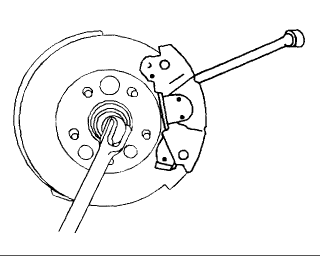

Insert a drift or a large screwdriver through the brake caliper into 1 of the brake rotor vanes in order to prevent the drive axle wheel drive shaft from turning. Remove the nut and the washer from the hub. Do not reuse the nut. A new nut must be used when installing the wheel drive shaft. Using the J 45859 or equivalent, press the wheel drive shaft from the hub.

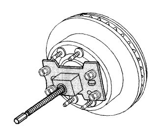

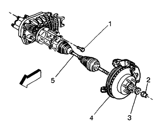

Remove the 6 bolts (1) securing the wheel drive shaft inboard flange to the output shaft flange. Remove the drift from the rotor. Remove the stabilizer shaft link from the lower control arm. Wrap shop towels around both the inner and the outer wheel drive shaft boots in order to avoid damage to the boots during removal and installation. Pull the wheel drive shaft through the lower control arm opening. Installation Procedure Wrap shop towels around both the inner and the outer wheel drive shaft boots in order to avoid damage to the boots during removal and installation. Important: Clean the steering knuckle and the wheel drive shaft splines and threads. These areas must be dry and free of grease, dirt, and contamination. Insert the wheel drive shaft splined shank into the knuckle hub. Notice: Use only a genuine GM front wheel drive shaft nut. Installation of anything but an OEM front wheel drive shaft nut could cause damage to the vehicle.
https://images.2carpros.com/forum/automotive_pictures/248015_4_2.gif
Install the washer (3) and the new hub nut (2) to the wheel drive shaft. Do not tighten the new hub nut at this time. Attach the wheel drive shaft inboard flange to the output shaft flange using the inboard flange bolts (1). Notice: Refer to Fastener Notice in Service Precautions.

Install the drive axle center cap, it equipped. Install the stabilizer shaft link. Install the wheel and tire assembly. Lower the vehicle. Inner Shaft and/or Housing Replacement - Front Drive Axle (8.25 F4WD Axle) Removal Procedure Raise the vehicle. Refer to Vehicle Lifting. Drain the differential carrier assembly. Remove the stabilizer shaft link assembly.
https://images.2carpros.com/forum/automotive_pictures/248015_a1_1.gif
Remove the wheel drive shaft inboard flange bolts from the inner axle shaft. Disconnect the wheel drive shaft from the inner axle shaft.

For the 8.25 inch axle, remove the following components from the inner axle shaft housing: The clutch fork inner spring (10) The clutch fork assembly (11) The clutch shaft shim (9) The clutch sleeve 8 The clutch gear (6) by doing the following: Clamp the inner axle shaft housing (4) in a vise. Clamp only on the mounting flange. Strike the inside surface of the shaft (1) flange with a hammer and a brass drift in order to dislodge the front drive axle clutch gear (6) from the inner axle shaft (1). The thrust washer (5)
https://images.2carpros.com/forum/automotive_pictures/248015_q9_1.jpg
The clutch fork inner spring (10) The clutch fork assembly (11) The clutch shaft shim (9) The clutch sleeve 8 The retainer ring (7) The thrust washers (5, 6)
https://images.2carpros.com/forum/automotive_pictures/248015_q10_1.gif
Remove the inner axle shaft (2). Tap out the inner axle shaft with a soft-faced mallet, if necessary. Remove the inner axle seal and the bearing from the axle housing. Installation Procedure Install the new inner axle shaft bearing and the seal to the axle housing.
