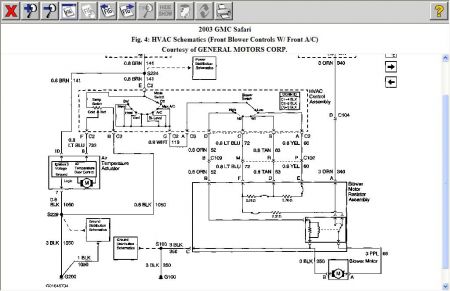

2003 GMC Safari blower motor only works on 3rd setting
2003 GMC SAFARI
160,000 MILES • 6 CYL • 2WD • AUTOMATIC
AGEVAERT
The blower motor only functions on the 3rd highest volume setting. The highest setting is intermittent at first, then non-existent, and the 1st and 2nd levels seem insufficient, but do blow some air.
Is it the relay, resitor, or something else? What other information is needed for an accurate diagnosis?

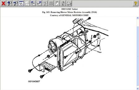

I will check the blower motor resistor then follow it with the HVAC control assembly
