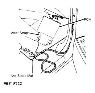

Your vehicle's powertrain control module should be located behind the right side of the dash. Is this where you already looked?

Well, I tried, I removed the four screws holding plate under Glove box, but saw nothing......just some wires.
If it is located ABOVE the glove box, then I don't know how to access. I removed the door and frame to G box, but it looks like the G box is one solid piece..
IS it. if not, could you please tell me how to get to the PCM ?????

It is under the glove compartment area, see if the pic below helps. You may need to remove some insulation / carpeting to access it.

Hi, thanks for the pic...are you saying it is under the FLOORING.....do I have to lift carpet up to access?

I am sorry, But does it have TWO wire harnesses attached to it??

I went to area , lifted carpet...nothing there. On the side kick panel there is a module attached to it. When I called an auto parts store and gave them the numbers, he said what was coming up was an "air-bag" module.....It had one connector...
Is this the PCM power train control module???
If not, then I have no idea's left!!
I have a VCM-A......is it possible that the PCM, or Control Module is built into this unit??? Or, are these two different unit all together?

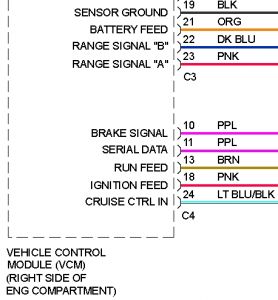

Okay, i think i know what the problem is. on this model of Jimmy, some were equipped with a PCM (powertrain control module) while others were equipped with what is called a Vechicle Control Module or VCM. If it does have the VCM, it will not have the PCM. Check on the right front of the engine compartment, near the washer fluid tank, the VCM will be located there.

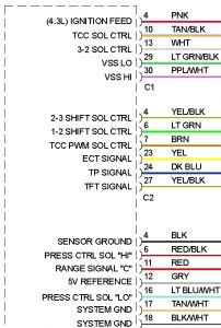

SO, last question, is there any way to find out which harness goes to the Trans Solenoids, and if so would you have a chart or pic with voltages???
I have to trouble shoot this unit to see if it went bad. It's only two years old!!

Sure, see if this helps ..i had to upload as 2 separate images so one might be slightly larger than the other, but it just pieces together..i think you can tell what i mean when you see it ..
https://images.2carpros.com/forum/automotive_pictures/261618_Noname_2402.jpg
https://images.2carpros.com/forum/automotive_pictures/261618_Noname2_779.jpg
