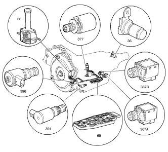

1996 GMC Jimmy, 4.3L V6, AT, 120,000 mi
It's doing some wierd stuff when trying to shift, but it is very sporadic (slipping? in and out). The only thing that is consistent is that it does not down shift on its own when coming to a stop; tries to pull out in high gear (once up to speed, it seems to run fine). Manually downshifting locks it in second, which is the default, from what I understand after replacing a speed sensor last year. After a while, it will no longer engage in reverse, however if I turn the key off and wait about 5 seconds and then turn it back on, it's fine for a short while (several minutes). I have heard that it is likely the 2-3 solenoid, but I don't know what that replacement entails.
Do you think that is, in fact, the problem, and do you think that a somewhat experienced mechanic can tackle something like that on his own?

It sounds like you are on the right track with the shift valve being the problem. You can remove the transmission pan and see all the valves. In the picture you see below the 1-2 valve is 367a and the 2-3 valve is 367b. I would pull the pan and use a volt meter to check the resistance of the solenoids. You should see that they are around 19 to 24 ohms when the motor is cool. If they are both fine then I would suggest replacing the wiring harness in the transmission.
https://images.2carpros.com/forum/automotive_pictures/86485_62792_1.jpg
I hope this helps... Cly

Drop the transmission pan and check the 1-2 and 2-3 shift solenoids for about 19-24 ohms resistance when cool. If both test good, replace the internal transmission wiring harness.
Conversation Summary
The owner of a 1996 GMC Jimmy reported sporadic shifting, no automatic downshift when stopping, and intermittent loss of reverse that returned after a key cycle. The expert advised checking the shift solenoids through the pan for 19-24 ohms resistance and replacing the transmission wiring harness if the solenoids tested good.
