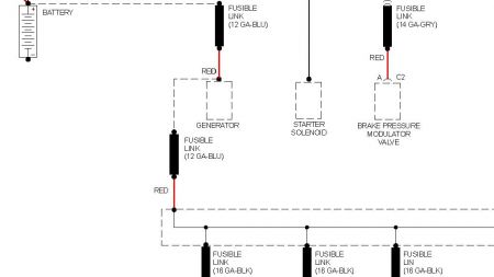

i have a 1996 gmc jimmey it has 110,000 miles on it the alternator went on it i replaced it i hooked up the new one and now i have no power electrical no nothing i check battery terminals everything, is there a fuse under the hood that could of blown any help would be appreciated.

Check the main fusible link 12 gauge Blue with Red wire both sides. No power-its blown see below
https://images.2carpros.com/forum/automotive_pictures/12900_fuse_link_1.jpg

[quote="rasmataz"]Check the main fusible link 12 gauge Blue with Red wire both sides. No power-its blown see below [img]those fuseable links have no fuses in them i mean i have nothing not even a dome light or nothing its like the whole truck is dead. any other suggestions
