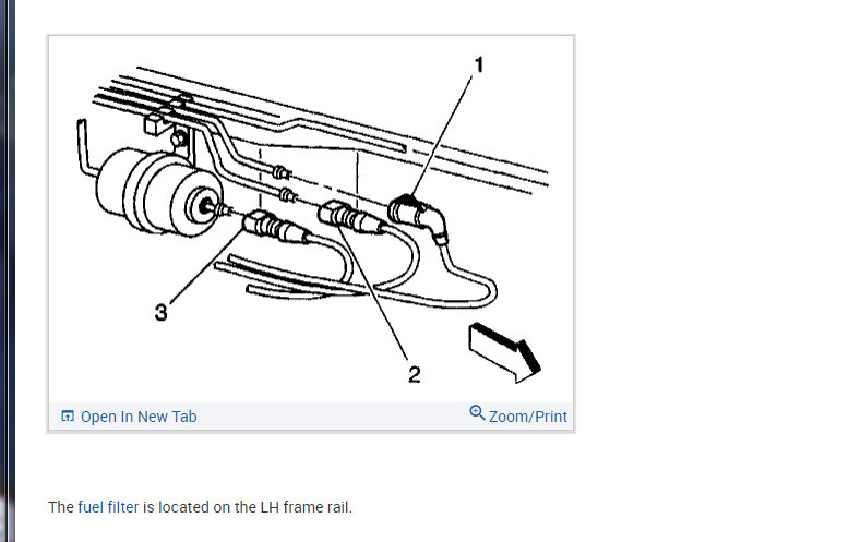

Wheres the fuel filter located at?
Thursday, October 23rd, 2008 AT 9:07 AM
This is located on the driver side frame rail just below the back side of the door. Basically if you lay on the ground and look on that frame rail you will find it.

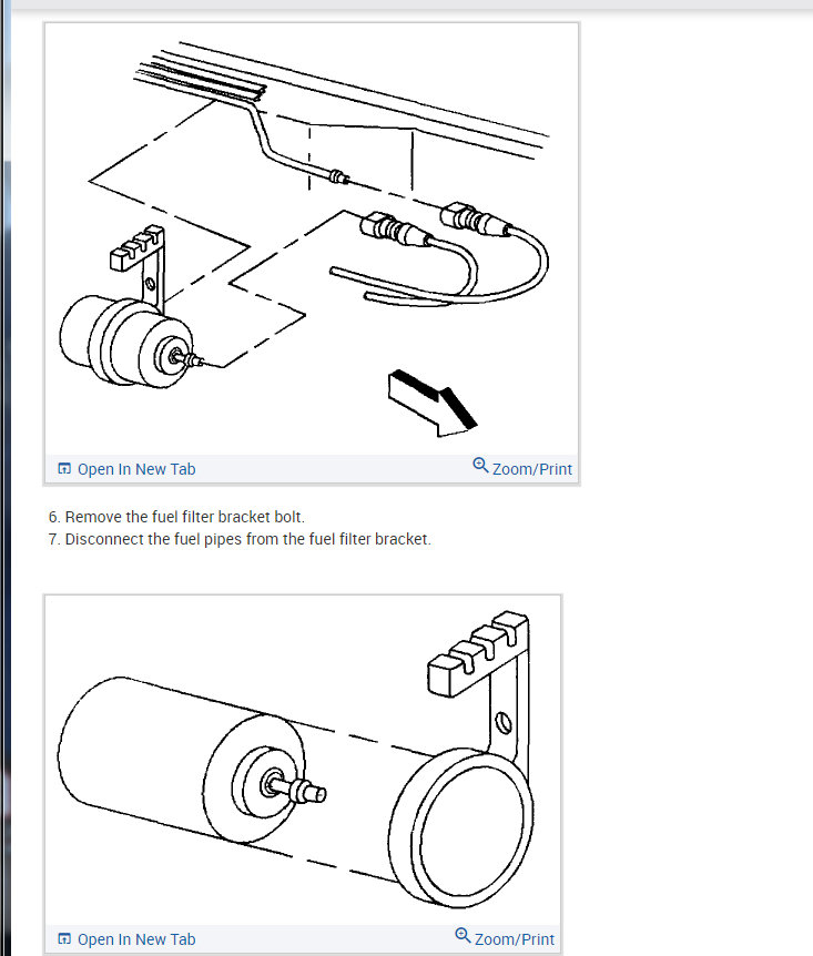

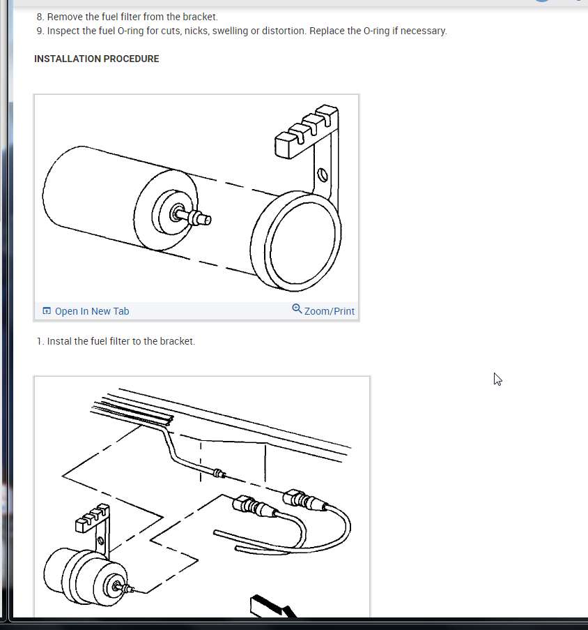

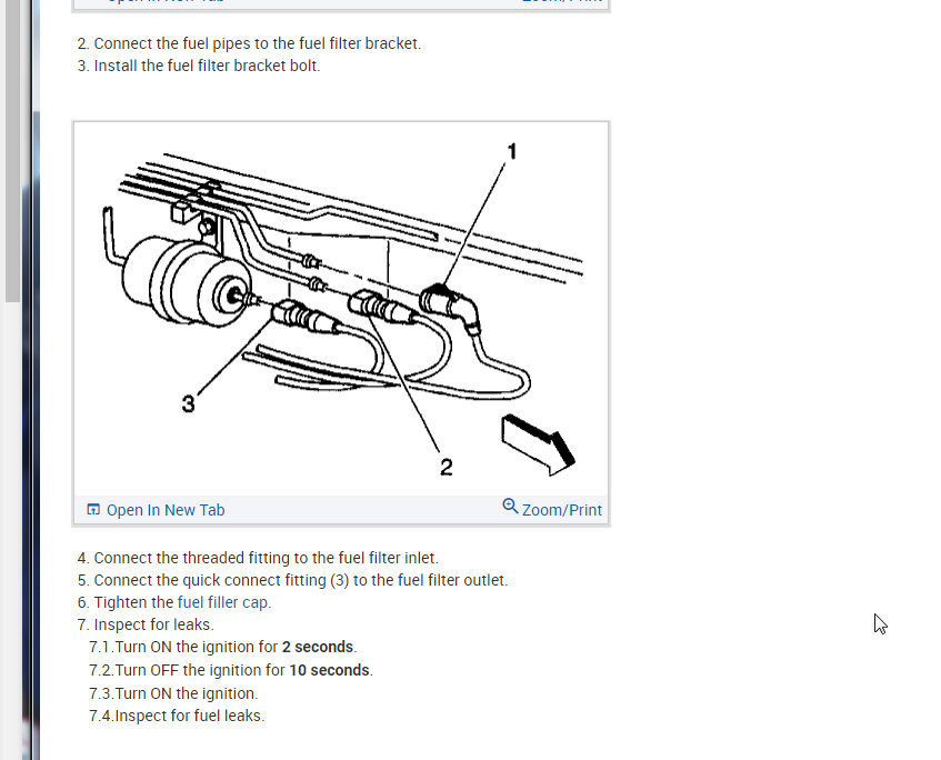

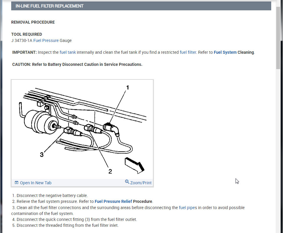

I attach process below from the manual as well.
Let us know if you have questions. Thanks
