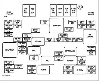

I can crank over the engine but won't start! I don't hear the fuel pump coming on anymore when I turn the key on. I checked all fuses and looked for loose wires. Checked my security system to make sure its working right.
There is a Fuel Pump module (fuse). ECM B in the fuse distribution box under the hood. I don't see a relay that deplics anything to do with fuel control.
Isn't there a fuel pump Re-set button anywhere on this truck? Still lost!
I thing there's something wrong with the power going to the fuel pump, but that's my guess and I don't know how to check it! Help![img:c2549eec67]http://www.2carpros.com/forum/automotive_pictures/432803_P6120244_1.jpg[/img:c2549eec67]

Welcome, do you have spark at the plugs, engine cranking? Also, use a gage and check fuel pressure. There should be a fuel pump relay in the power distribution center, under the hood. Voltage for the load side of relay is hot all the time, voltage for the coil side of relay goes hot with engine cranking and a couple of seconds when you first turn key on, no crank. This guide should help us get started https://www.2carpros.com/articles/car-cranks-but-wont-start
https://images.2carpros.com/forum/automotive_pictures/170934_99_gmc_jimmy_1.jpg
My info showed the above for underhood fuse block. no reset that I'm aware of.

Mod shows fuel pump test connector, if there is one, in the underhood bussed electrical center. I don't know why the ecm B fuse isn't hot, have to track the circuit. There is a 175 amp mega fuse, one of the positive battery cables, lead to it, Don't have exact location. That fuse serves several circuits, including ecm b fuse.

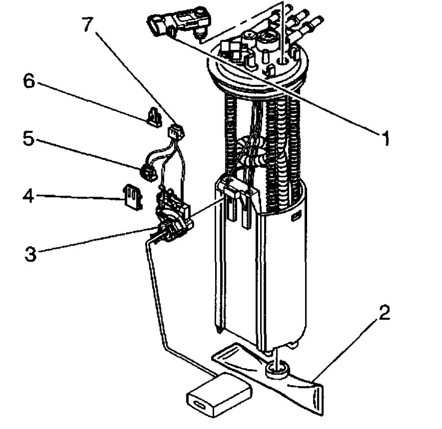

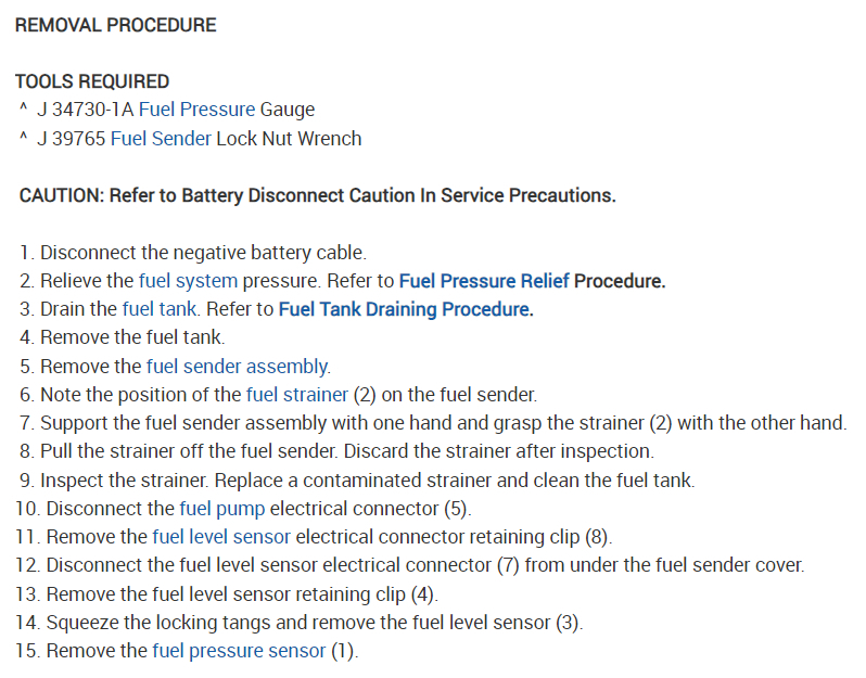

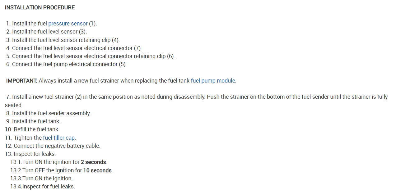

Yep, you should be okay, but I can tell you I would drop the tank and replace the fuel pump, one time the pump will not work even with tapping the fuel tank. Here is how to do the job is done in case you want to fix it:
https://youtu.be/bCcueO4ALxQ?si=0zIhliEyQYcLfuKv
Check out the images (below). Let us know if you need anything else.
