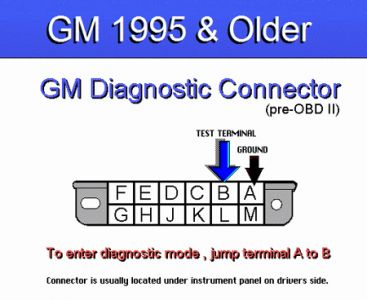

I am wondering if there is a cpu hookup under the hood in my jimmy, someone cut the on in the cab under the steering wheel. Someone told me there is usually another under the hood.
this is for the s 15 jimmy
thanks

https://www.2carpros.com/forum/automotive_pictures/12900_GM_ALCL_24.jpg

What are the wire colors for a&b my connector is gone, if I had the colors I can jump those. Thanks for the info.

Do you see an orange and black, and a white and black wire?

No, there is a orange wire and a black wire, but not a orange/black or black/white. Will they be a small wire like a 20 awg or a 14 awg.
