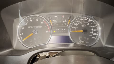

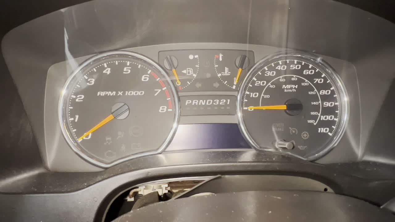

Here is the start cycle from the dashboard...
What I find odd is right after I release the key from the start position, it seems as though the dashboard resets.
As opposed to just seeing the last screen display just before start.
Make sense?

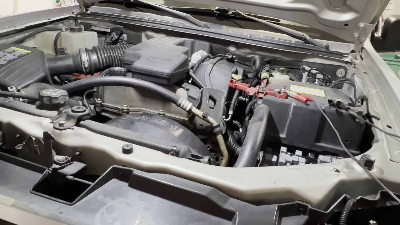

Here is the start cycle from the engine...

Confirmed the crankshaft does rotate freely and the AC compressor and alternator/generator pulleys work.

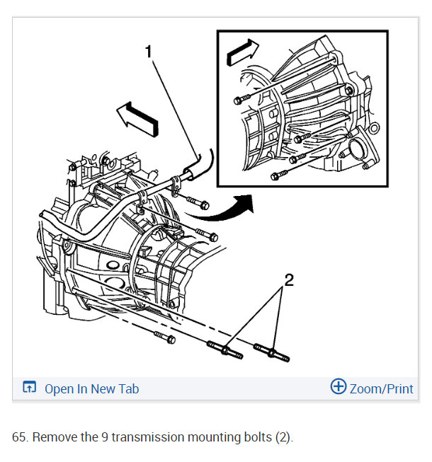

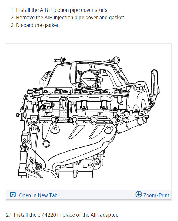

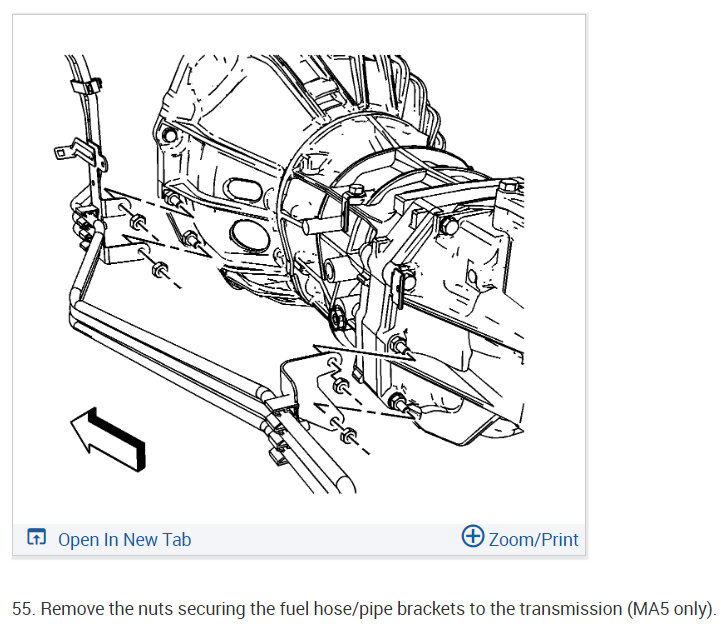

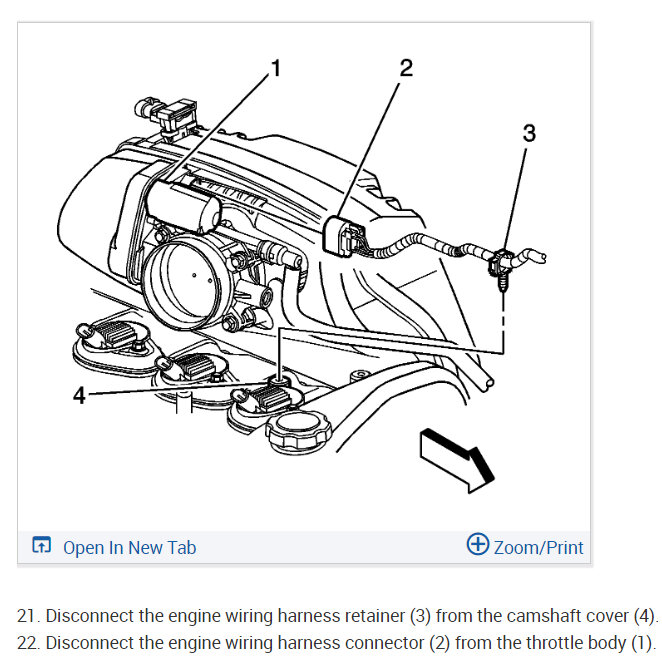

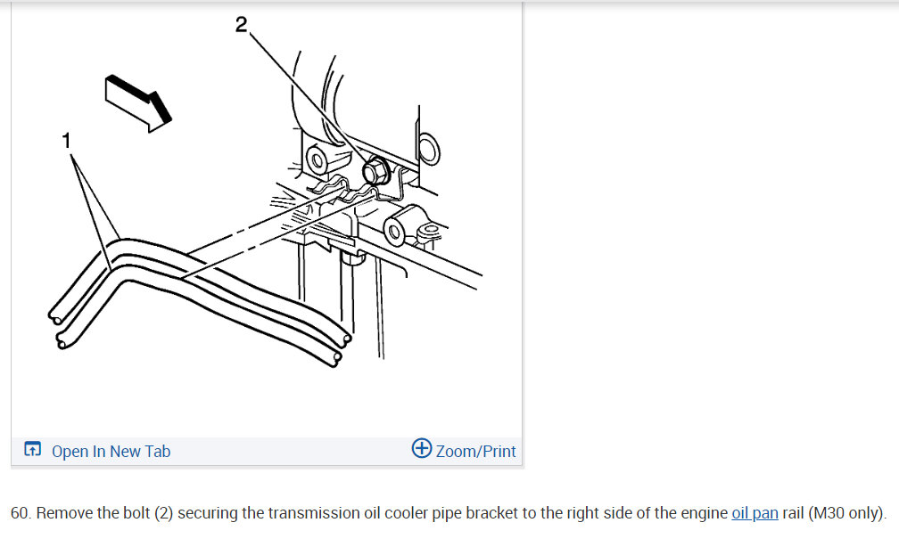

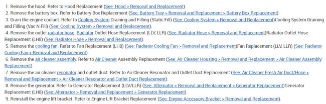

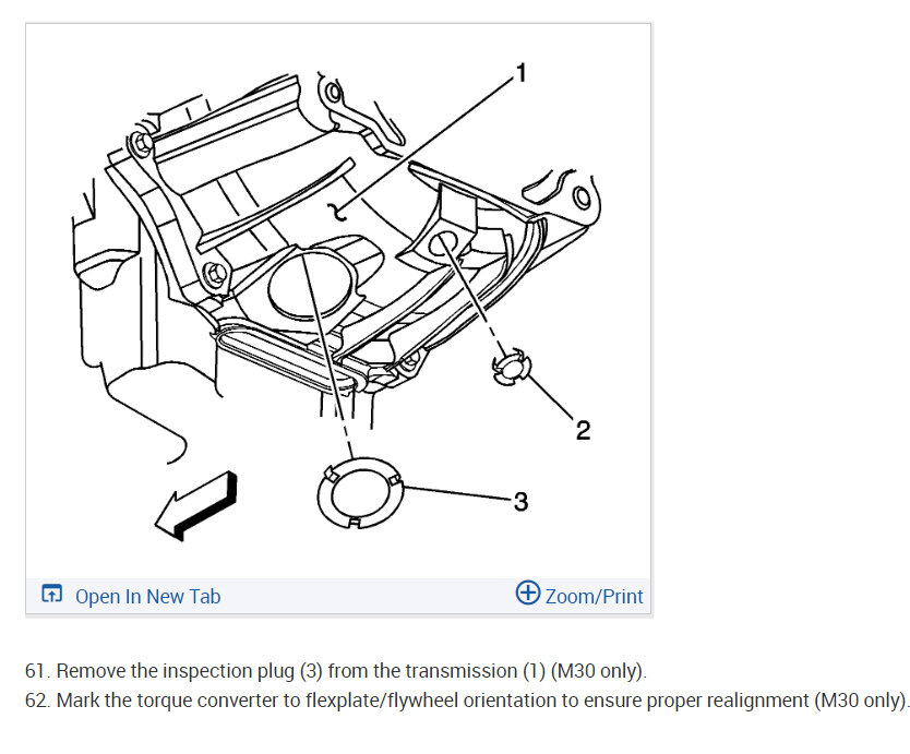

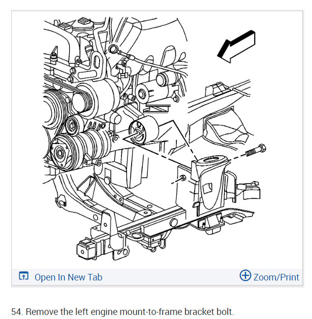

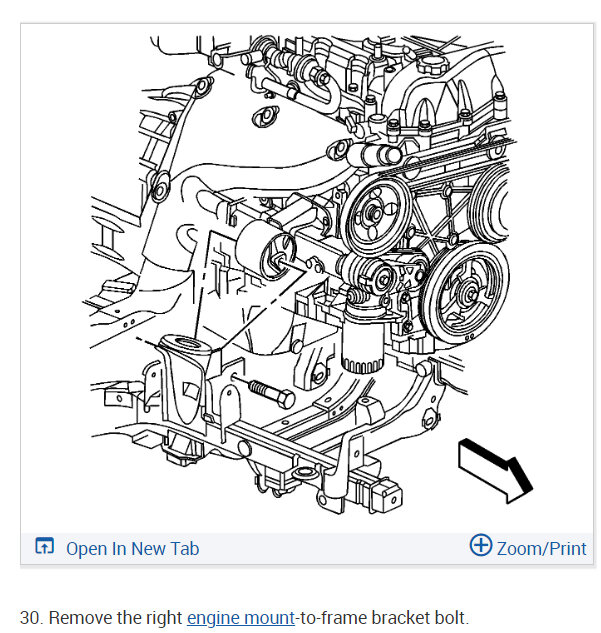

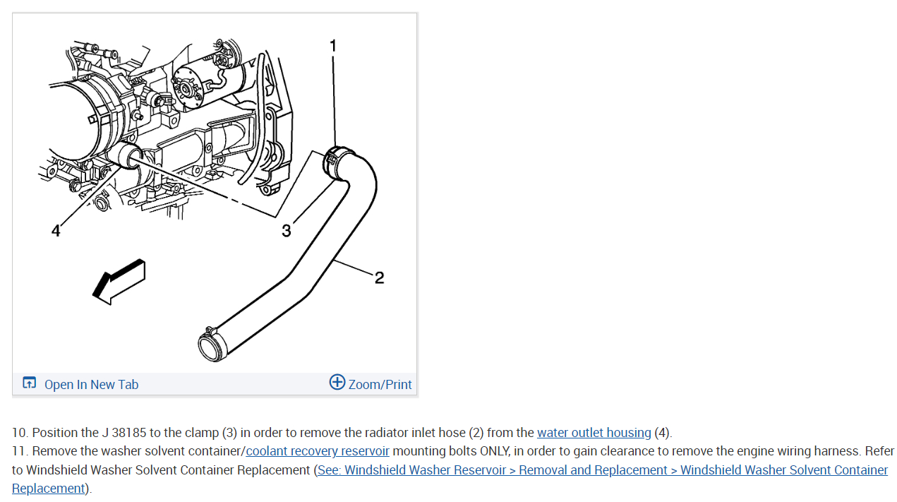

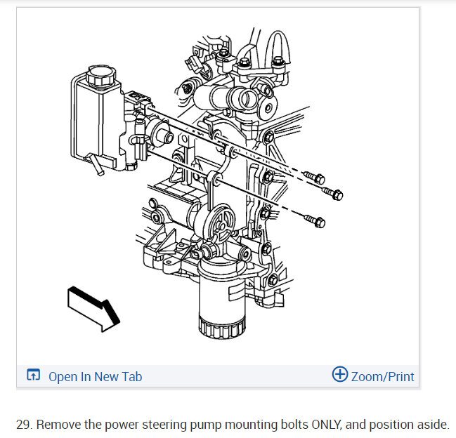

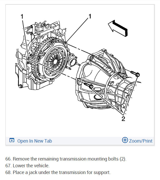

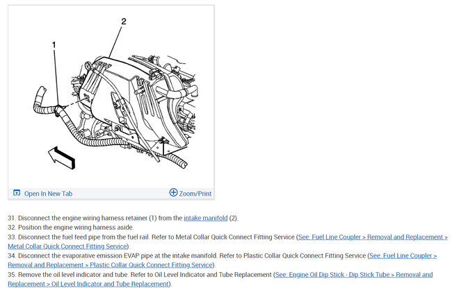

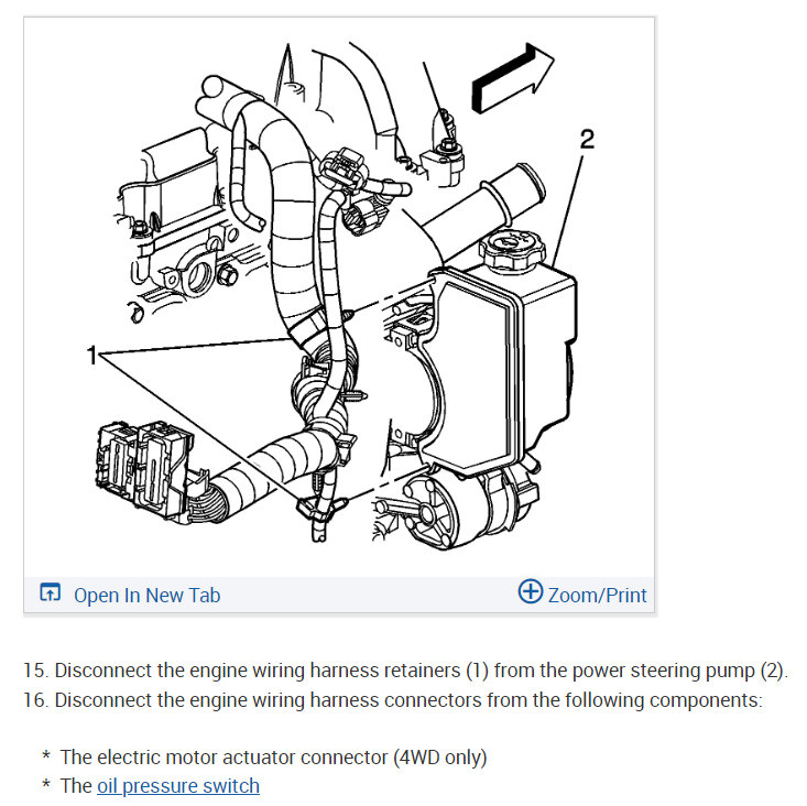

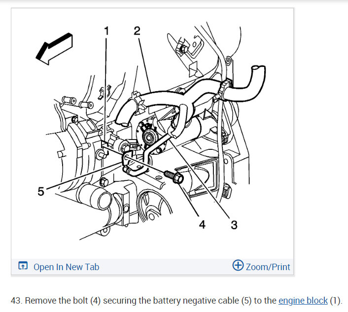

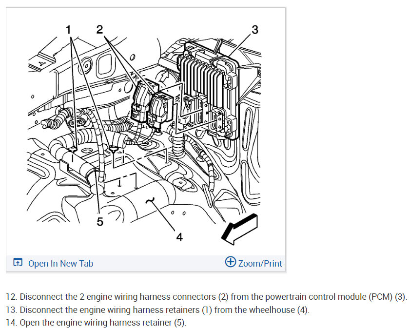

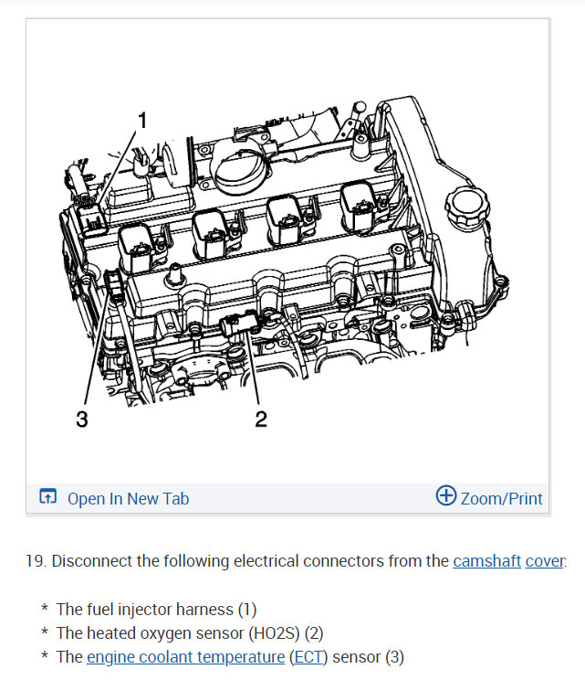

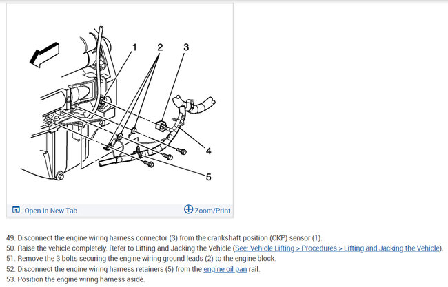

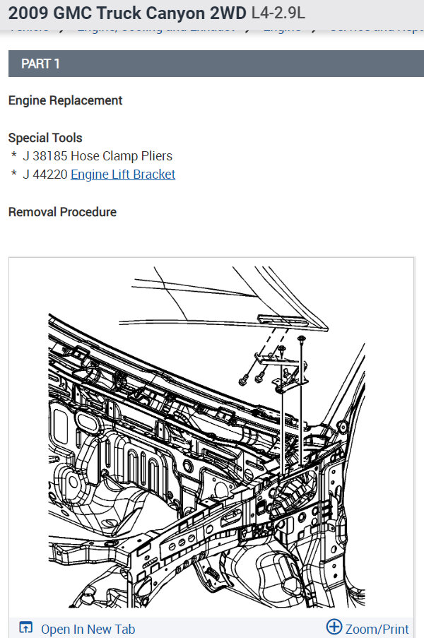

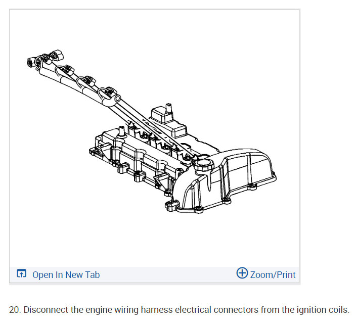

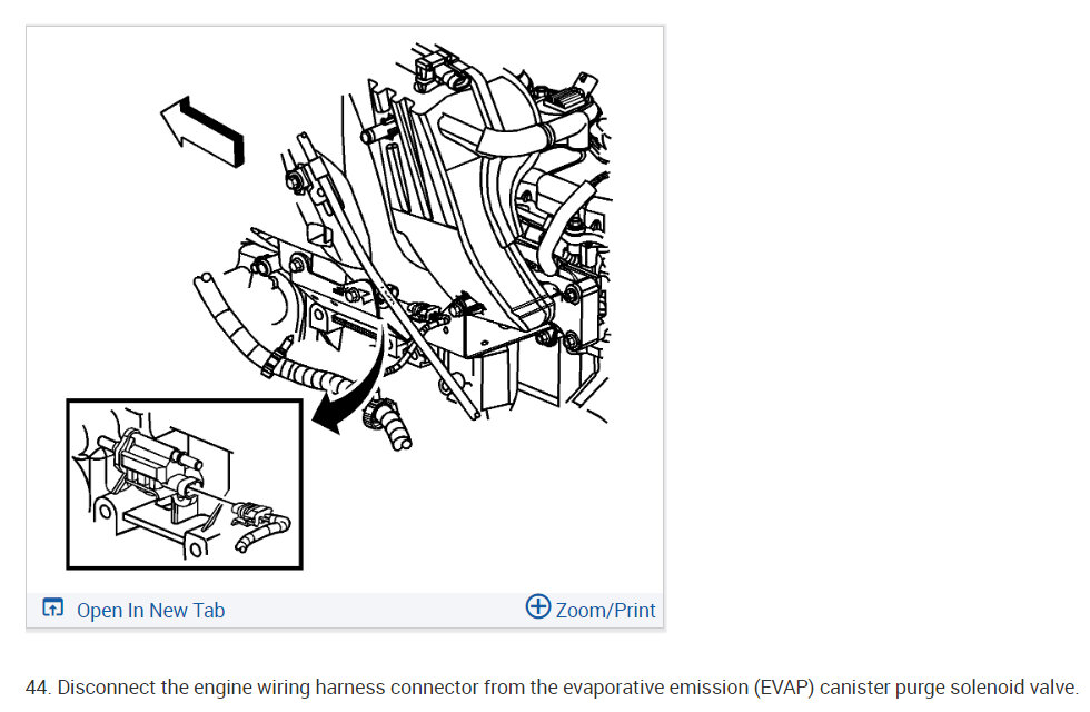

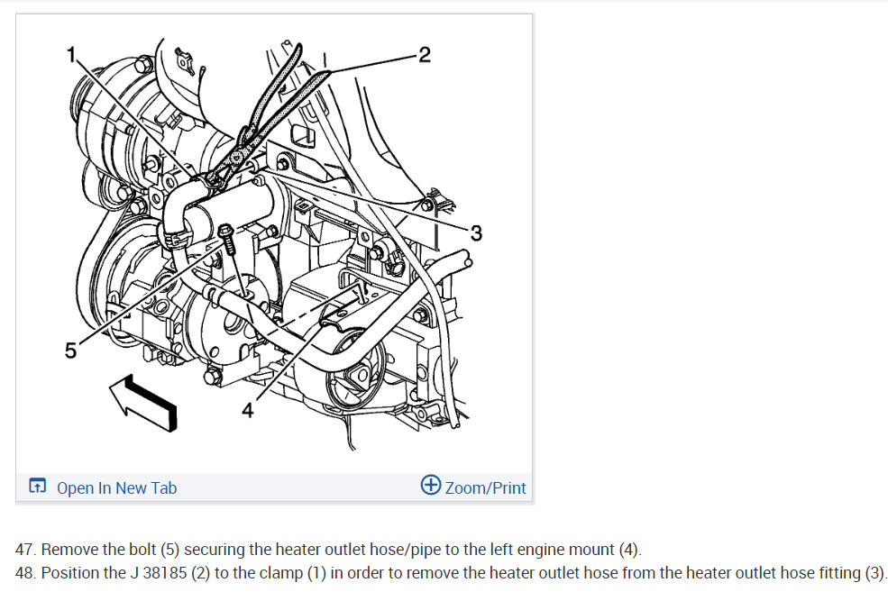

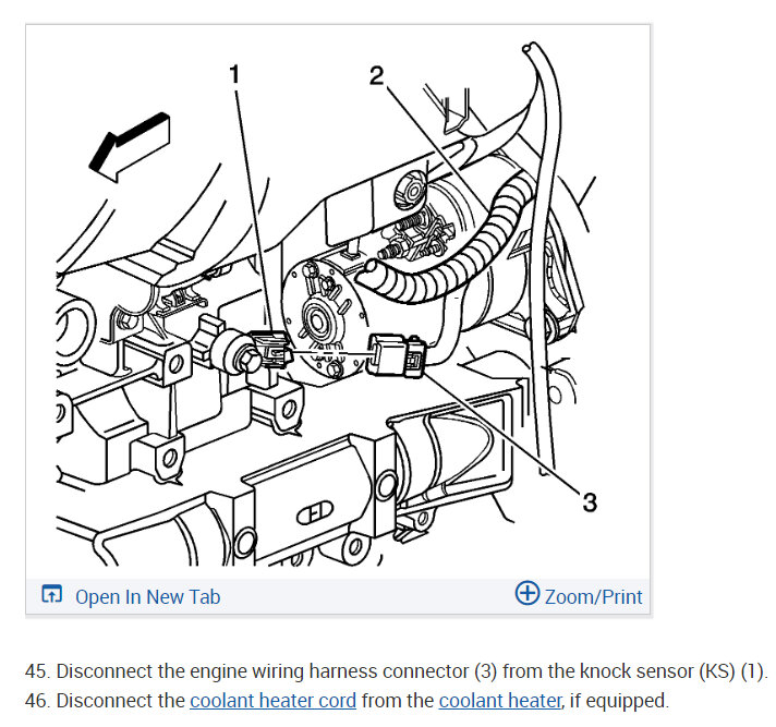

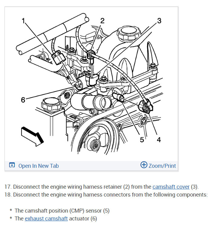

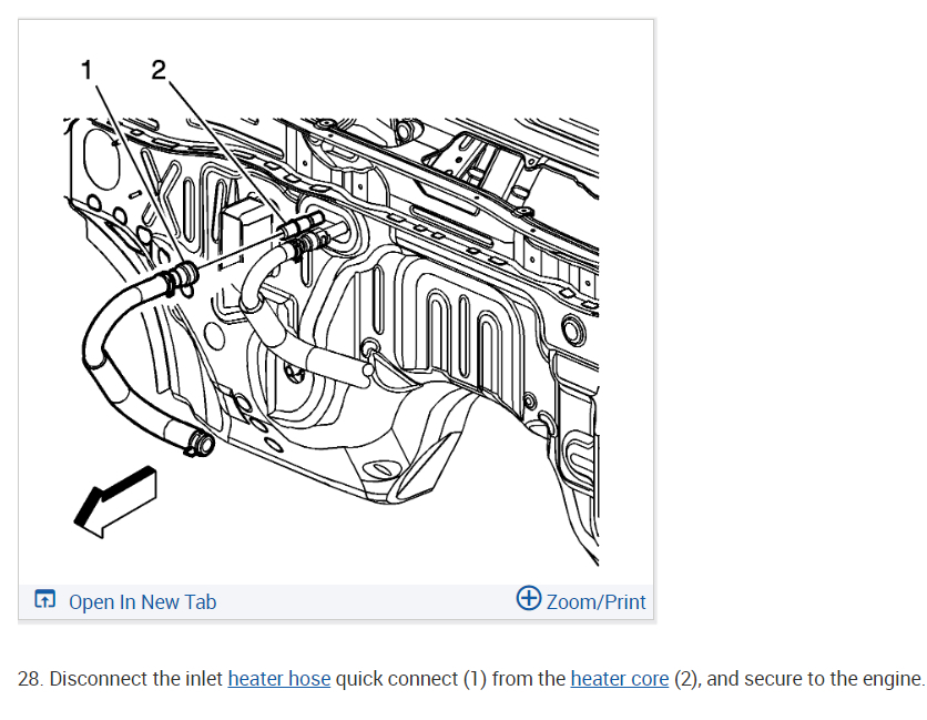

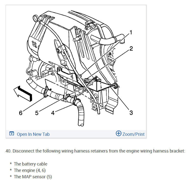

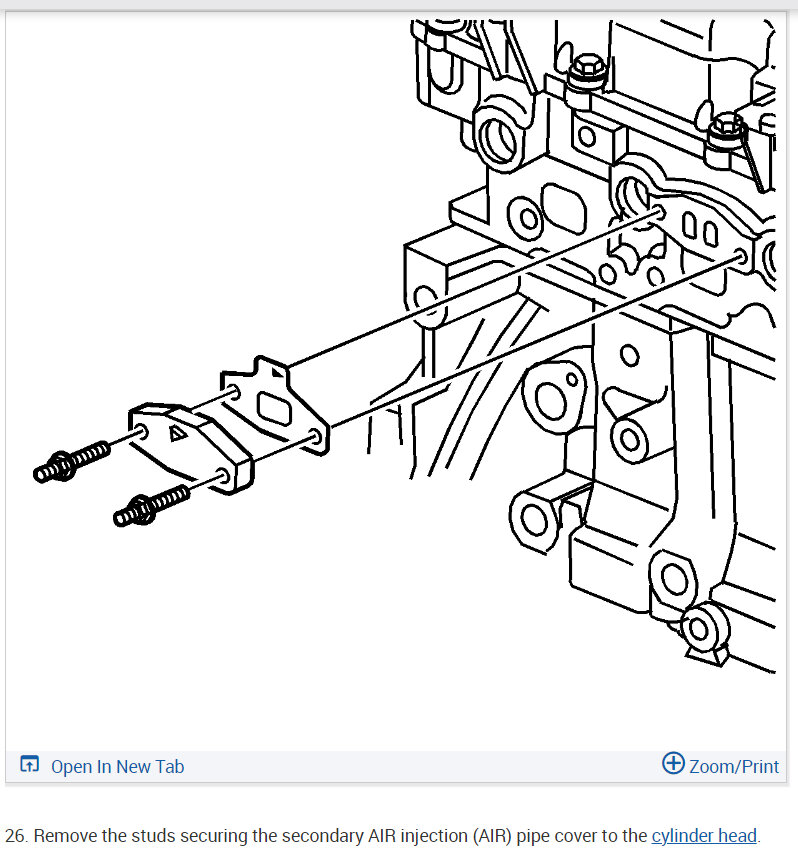

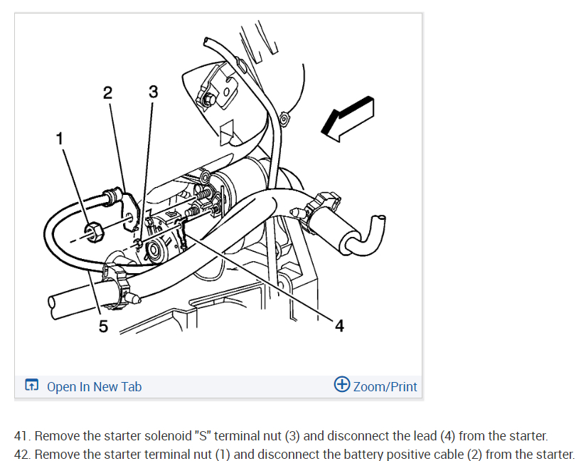

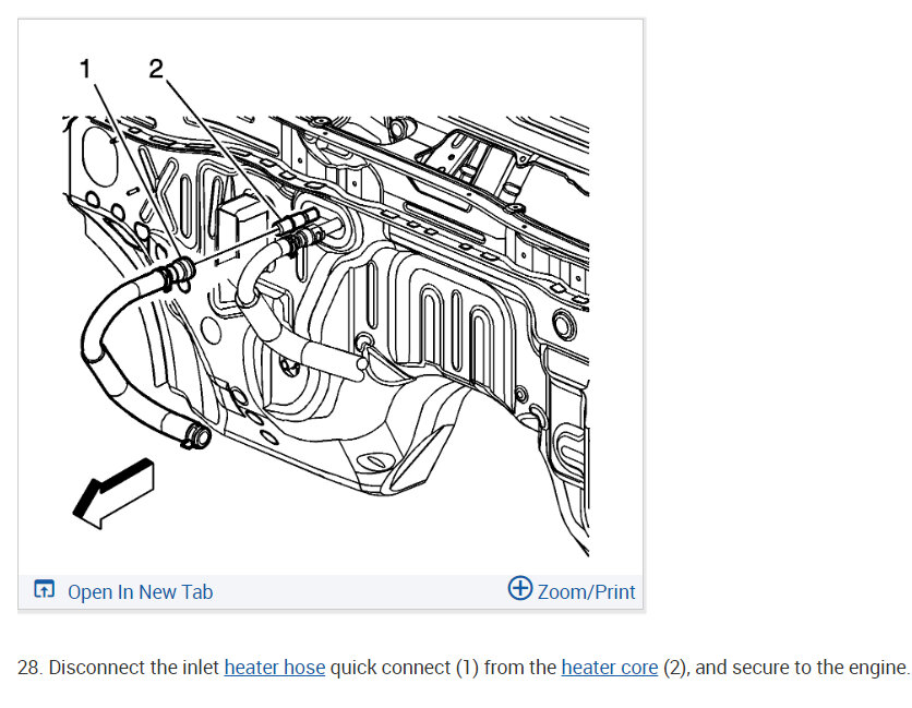

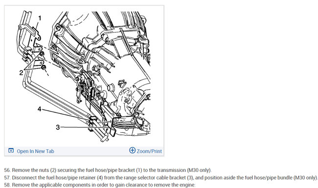

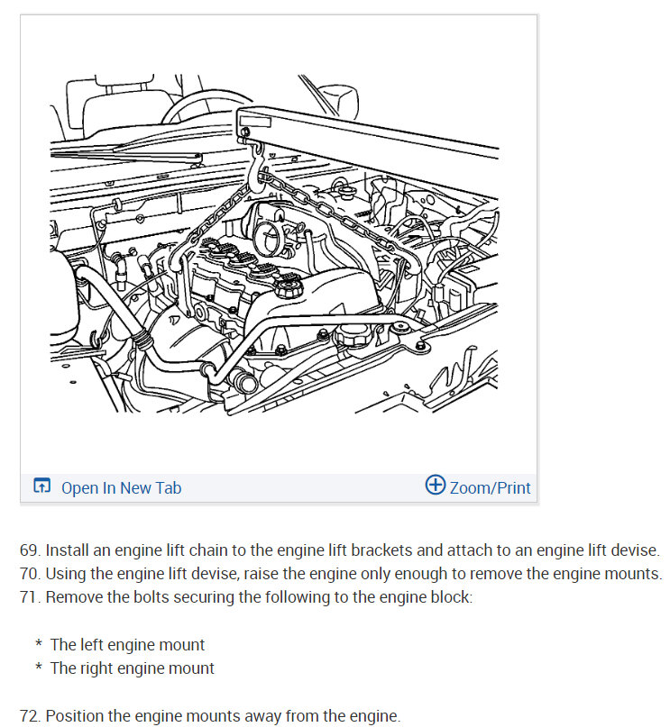

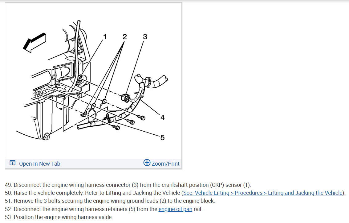

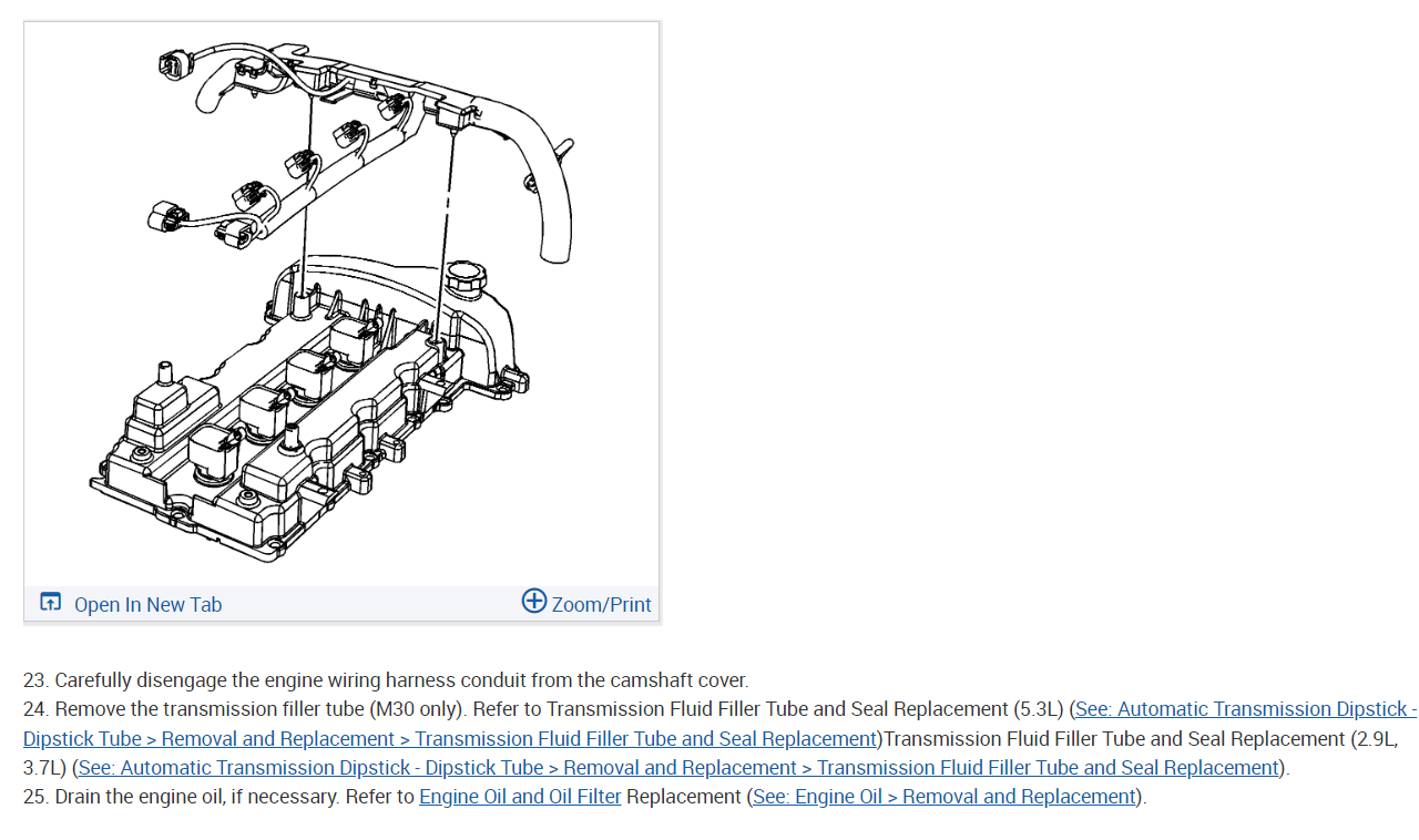

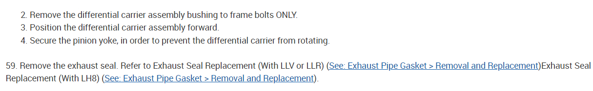

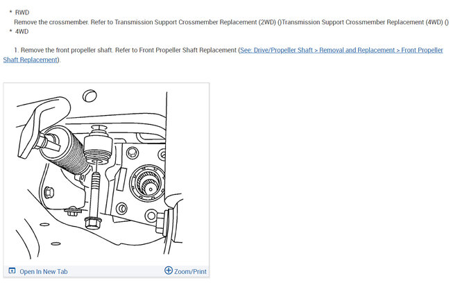

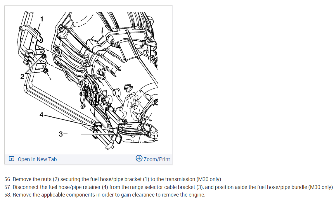

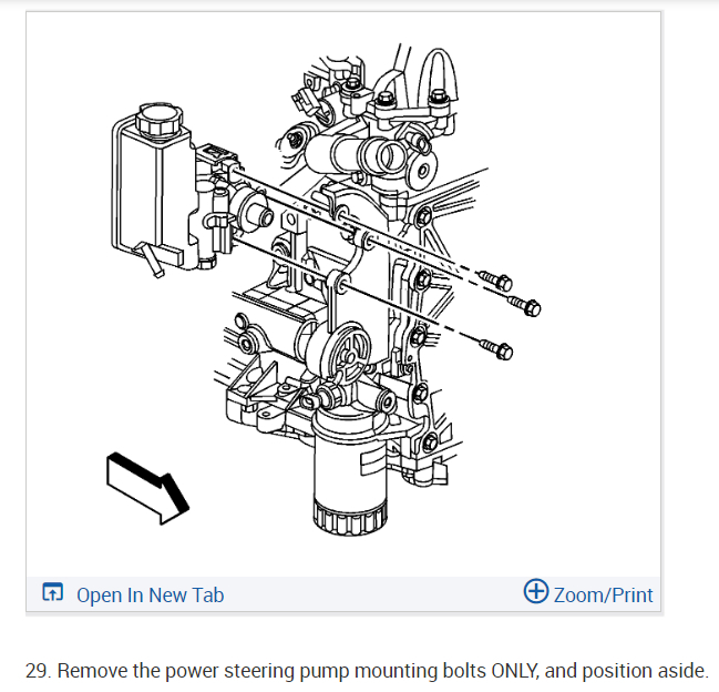

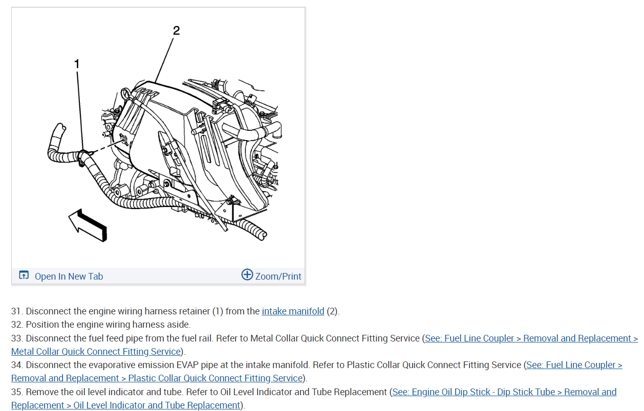

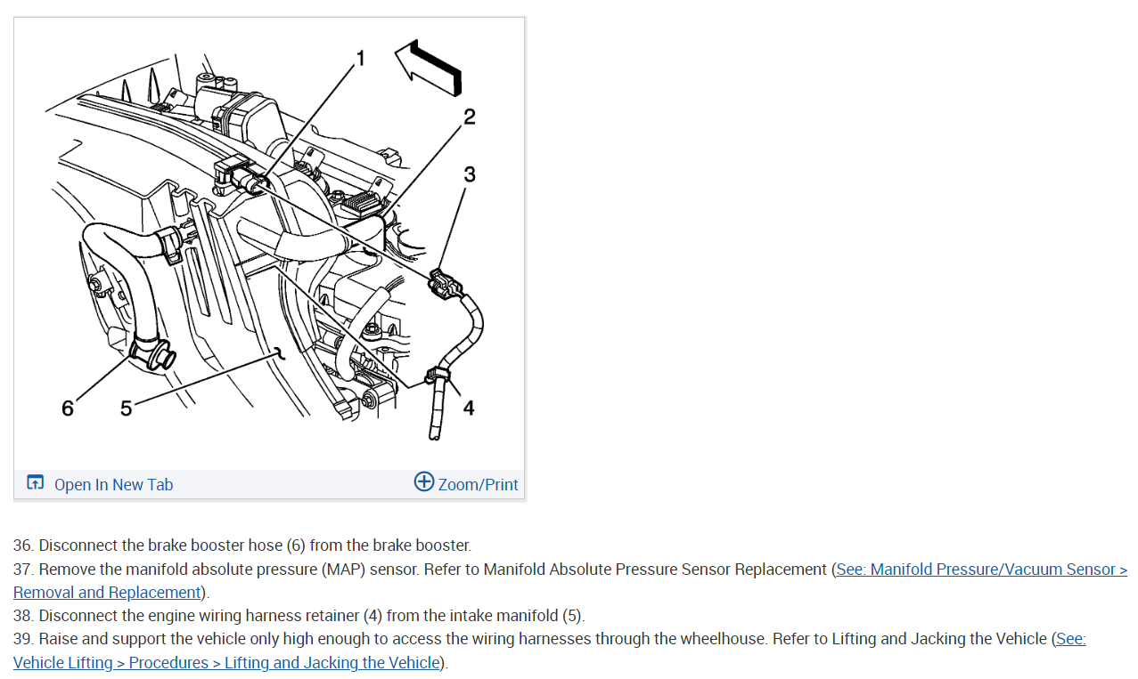

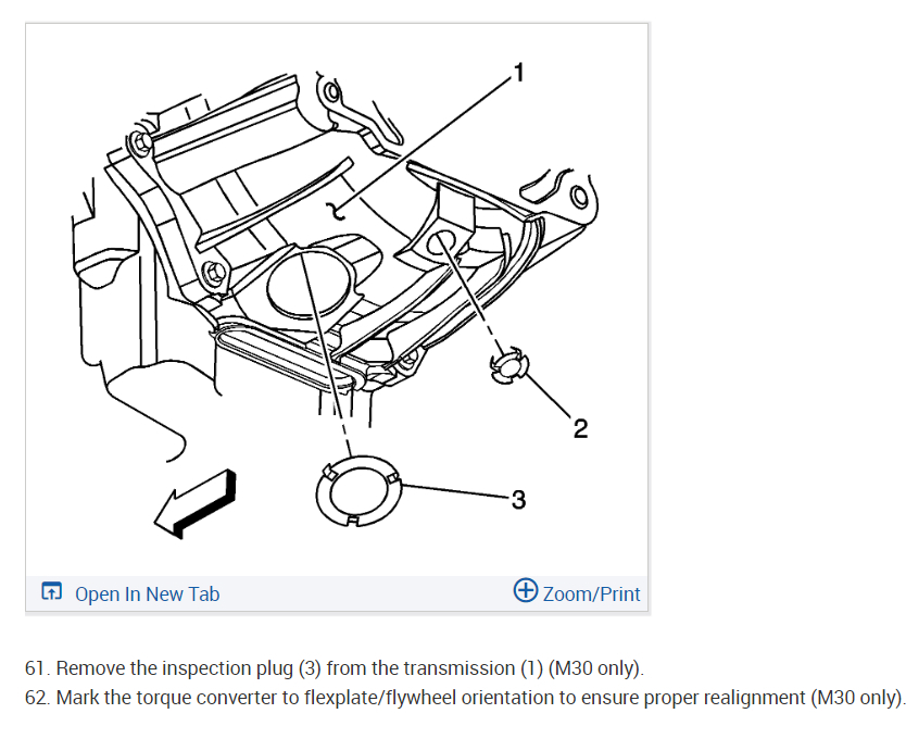

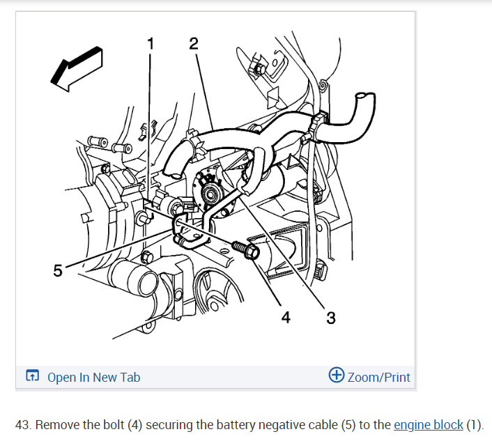

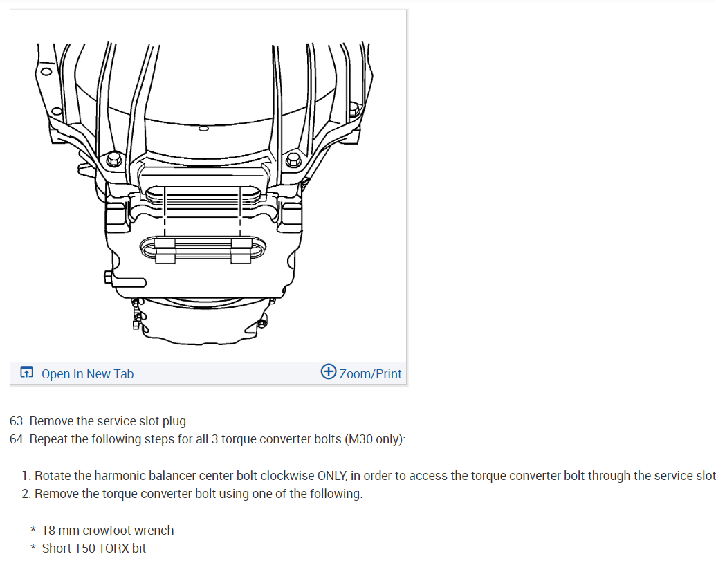

Yep, this engine has come apart internally. Thanks for the video. With this many miles on it I would get a rebuilt engine from GM. Here is how to remove the engine so you can install a new one. Check out the images (below). Let us know how it goes.
