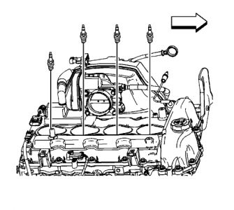

I would like to change my spark plugs in my truck because it has been driven about 5 times in the passed year because I have been deployed. I have been looking under the hood and can't even find the spark plug wires. Thanks for your help.

SPARK PLUG REPLACEMENT REMOVAL PROCEDURE
https://images.2carpros.com/forum/automotive_pictures/12900_s_4.jpg
1.Remove the ignition coils. 2.Clean the spark plug recesses with low pressure air. CAUTION: Wear safety glasses when using compressed air, as flying dirt particles may cause eye injury. NOTE: Clean the spark plug recess area before removing the spark plug. Failure to do so could result in engine damage because of dirt or foreign material entering the cylinder head, or by the contamination of the cylinder head threads. The contaminated threads may prevent the proper seating of the new plug. Use a thread chaser to clean the threads of any contamination. 3.Remove the spark plugs from the cylinder head. NOTE: Allow the engine to cool before removing the spark plugs. Attempting to remove the spark plugs from a hot engine may cause the plug threads to seize, causing damage to cylinder head threads. 4.Inspect the spark plugs. INSTALLATION PROCEDURE 1.Measure the spark plug gap on the spark plugs to be installed. Compare the measurement to the gap specifications. NOTE: **Use only the spark plugs specified for use in the vehicle. Do not install spark plugs that are either hotter or colder than those specified for the vehicle. Installing spark plugs of another type can severely damage the engine. **Check the gap of all new and reconditioned spark plugs before installation. The pre-set gaps may have changed during handling. Use a round feeler gage to ensure an accurate check. Installing the spark plugs with the wrong gap can cause poor engine performance and may even damage the engine. 2.Install the spark plugs to the cylinder head. NOTE: **Be sure that the spark plug threads smoothly into the cylinder head and the spark plug is fully seated. Use a thread chaser, if necessary, to clean threads in the cylinder head. Cross-threading or failing to fully seat the spark plug can cause overheating of the plug, exhaust blow-by, or thread damage. **Refer to Component Fastener Tightening Notice in Service Precautions. Tighten the spark plugs to 18 N.m (13 lb ft). 3.Install the ignition coils. https://www.2carpros.com/kpages/auto_repair_manuals_alldata.htm
