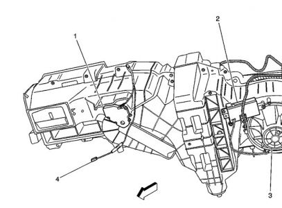

my a/c runs for awhile than all of asudden the heater starts blowing on the driver side. why ?

oneof your actuators on theheater box isn't working correctly or the control unit is making it do that. This picture is similarto what you have. they can be electric or vacuum
