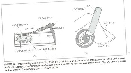

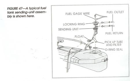

A sending unit is usually inserted into a fuel tank through large hole at the top of the tank. It’s held in place with either a series of bolt or a large, round retaining ring. However, in most case the fuel tank has to be removed before the sending unit can be removed and replaced. It usually located near the top of the fuel tank. Therefore, you won't be able to reach the retaining bolts or have enough room to pull the sending unit up out of the tank. Once the fuel tank is removed, you can remove the sending unit and using the fuel gage wire test the fuel gage as I have described it before: If you think it's complicate to do,take your car to a shop ask them what do you want to be tested before replacing anything. Good luck
