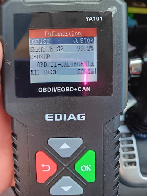

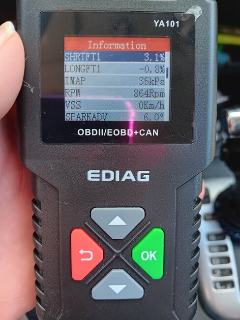

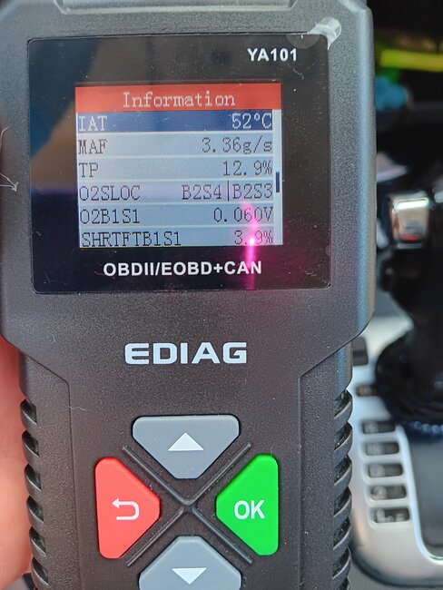

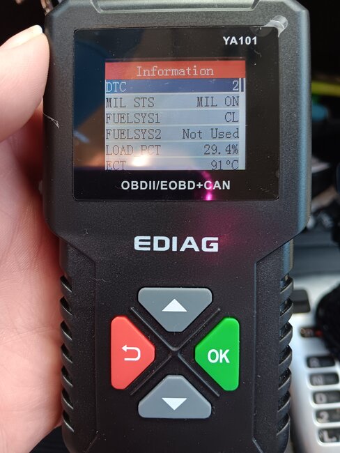

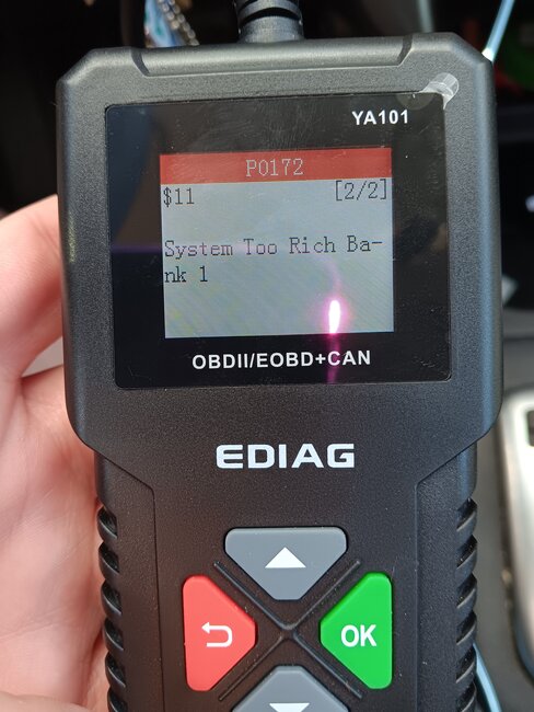

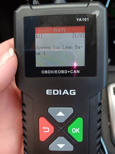

My vehicle listed above SX model has started throwing the above codes. They both pull bank 1. I didn't notice any difference in driving at first, but it's starting to feel as if its having issues accelerating. I took pictures of the codes, as well as live scan. Just looking for ideas on what could be wrong before I go dumping too much money into it with the mechanic.

Here is what is said about the codes:
The codes P0171 and P0172 refer to a problem with the fuel mixture in the engine.
P0171 is a "System Too Lean (Bank 1)" code,
P0172 is a "System Too Rich (Bank 1)" code,

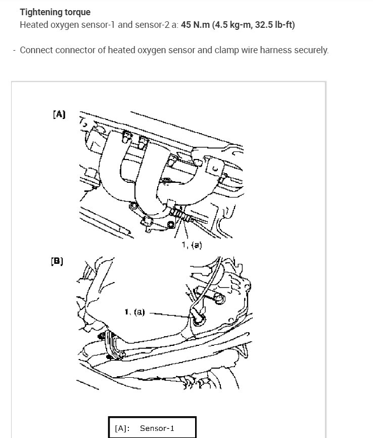

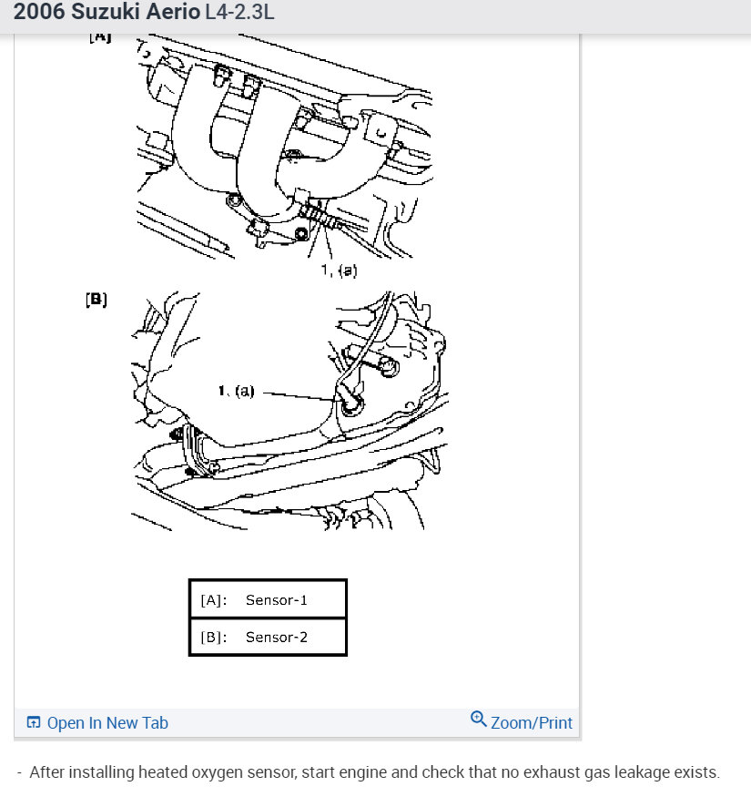

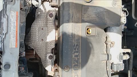

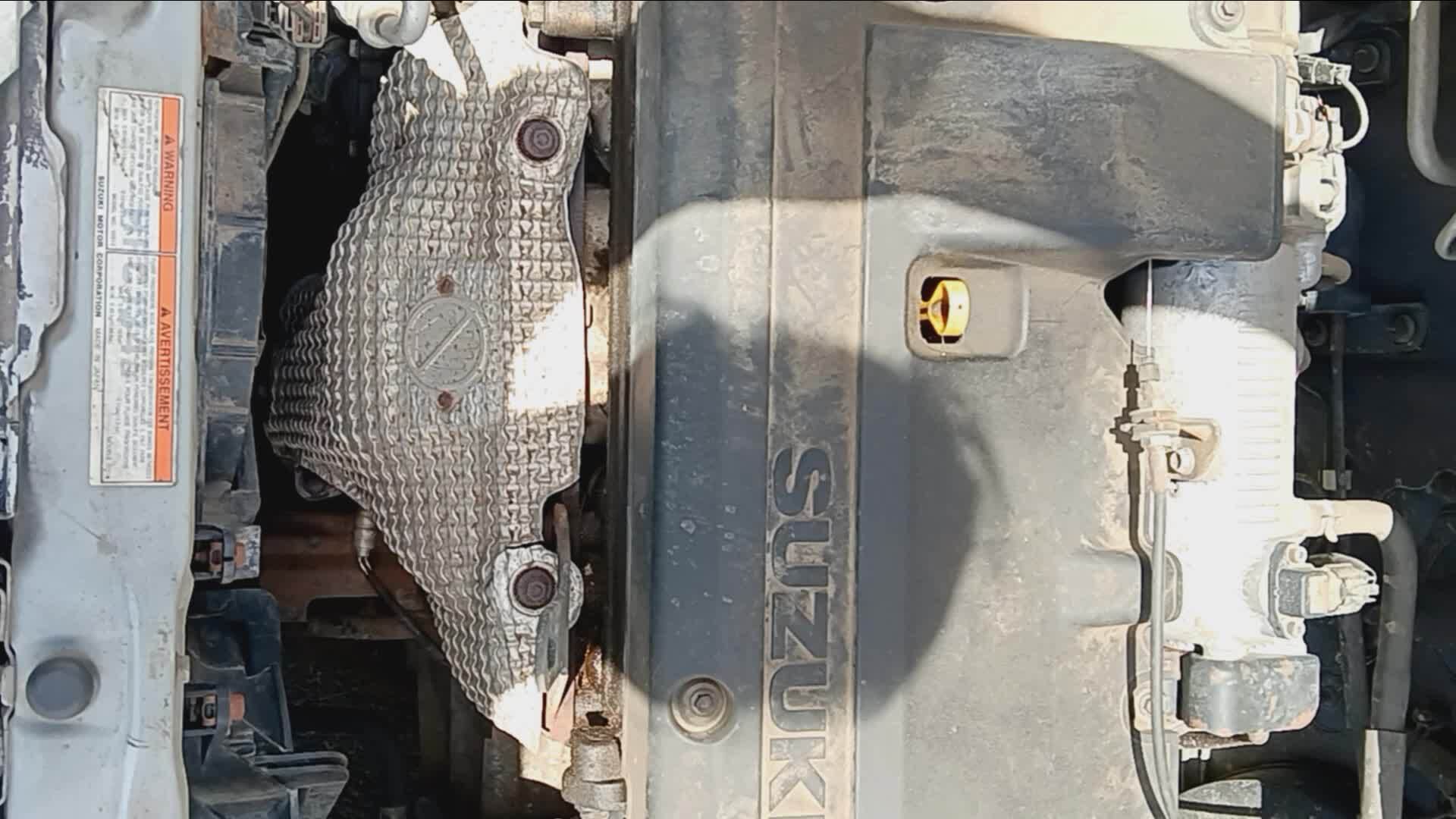

The fact that it goes from to rich to the lean I need to ask of the exhaust system is in good shape no leaks. If so, is the engine misfiring? Can you upload a short video of how the engine is running? If everything is okay, I would replace the primary oxygen sensor. Here is the location, Check out the images (below). Please let us know what happens.

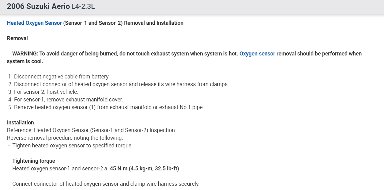

Okay, because the system goes from rich to lean, I would replace the oxygen sensor (primary).
Here is a guide to help walk you through the steps:
https://www.2carpros.com/articles/how-to-replace-an-oxygen-sensor
Please go over this guide and report back.

Just wanted to respond now that I feel safe with the answer. I replaced the air filter because it was pretty gunked up, and then cleaned the MAF sensor. I cleared the codes, and it seems to be good to go.
Thank you for your help!
