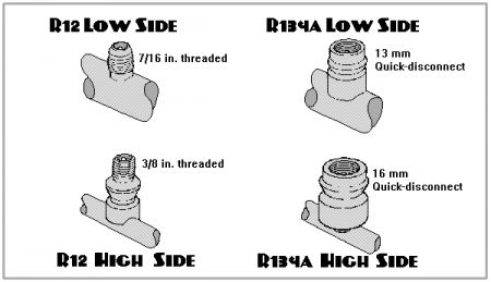

Find the 13mm low side port its between the compressor and evaporator
https://www.2carpros.com/forum/automotive_pictures/12900_ac_service_fittings_36.jpg

Thanks for the reply.
I recharged it and now it blows freezing cold air. :)
