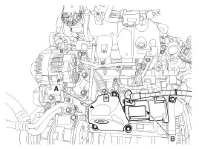

4. Lift up the engine assembly slightly by using a jack to get access to the side of engine.
5. Remove the engine support bracket (A). And then remove cable and connector from starter (B).
Tightening torque :
49.0 - 63.7 N.m (5.0 - 6.5 kgf.m, 36.2 - 47.0 lb-ft)

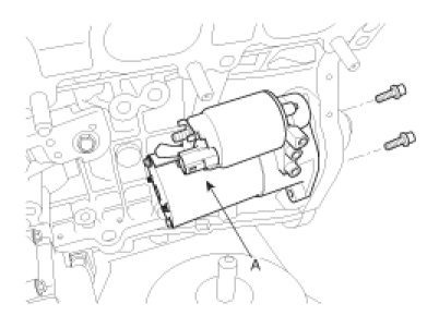

pic 3
6. Remove the bolts and starter (A).
Tightening torque :
42.1 - 53.9 N.m (4.3 - 5.5 kgf.m, 31.1 - 39.7 lb-ft)
pic 4
7. Installation is the reverse of removal.
