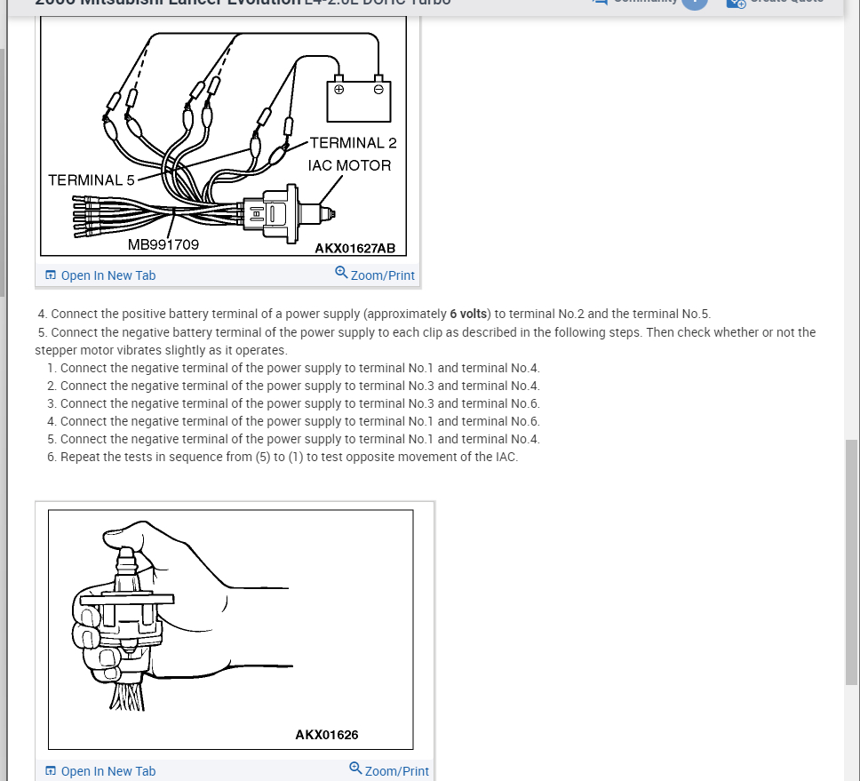

Hello, I have the car listed above which keeps shutting off on me after a few seconds of being on. Any tips on how to diagnose this issue? Could it be fuel cut related?

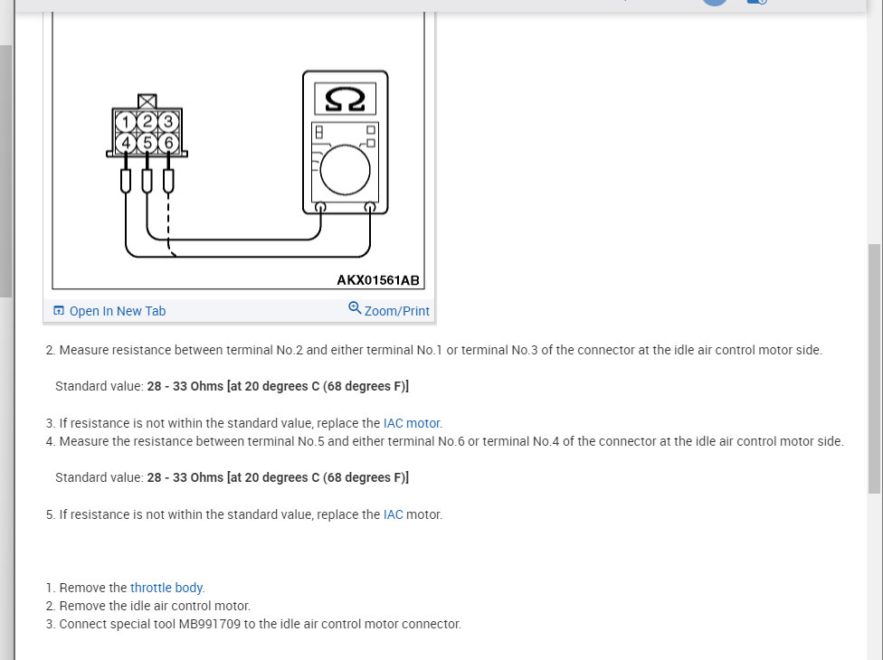

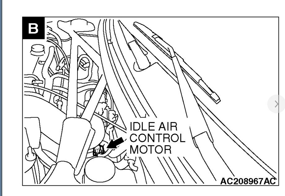

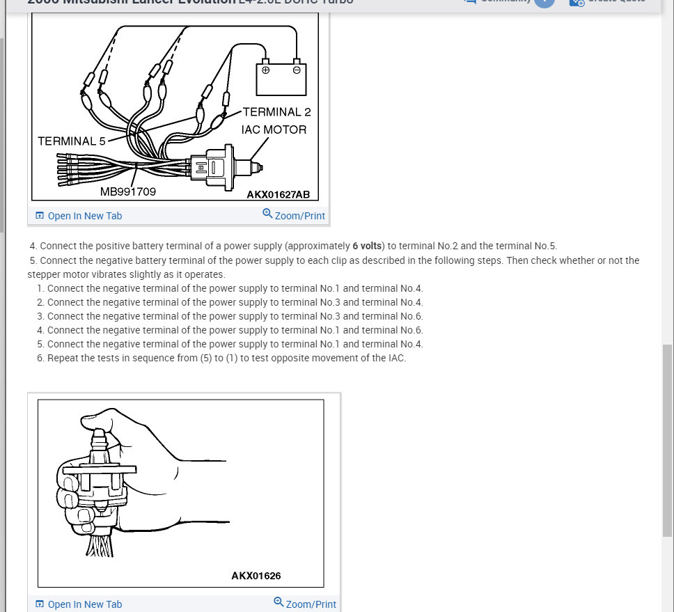

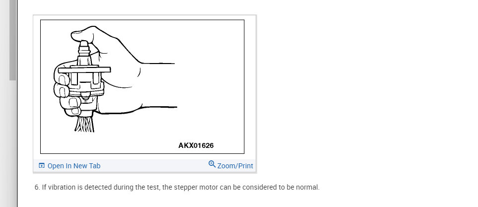

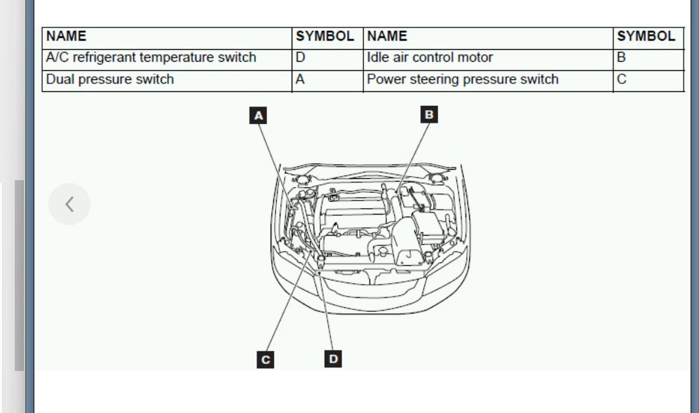

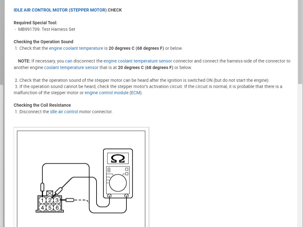

The last thing that would make sense is an idle air control valve.
I would suggest replacing it but here are a couple guides for this as well as I am attaching the info below on how to test it:
https://www.2carpros.com/articles/idle-air-control-valve-service
https://www.2carpros.com/articles/how-to-replace-an-idle-speed-control-motor-iac
Please run through this info and let us know what you find. Thanks
