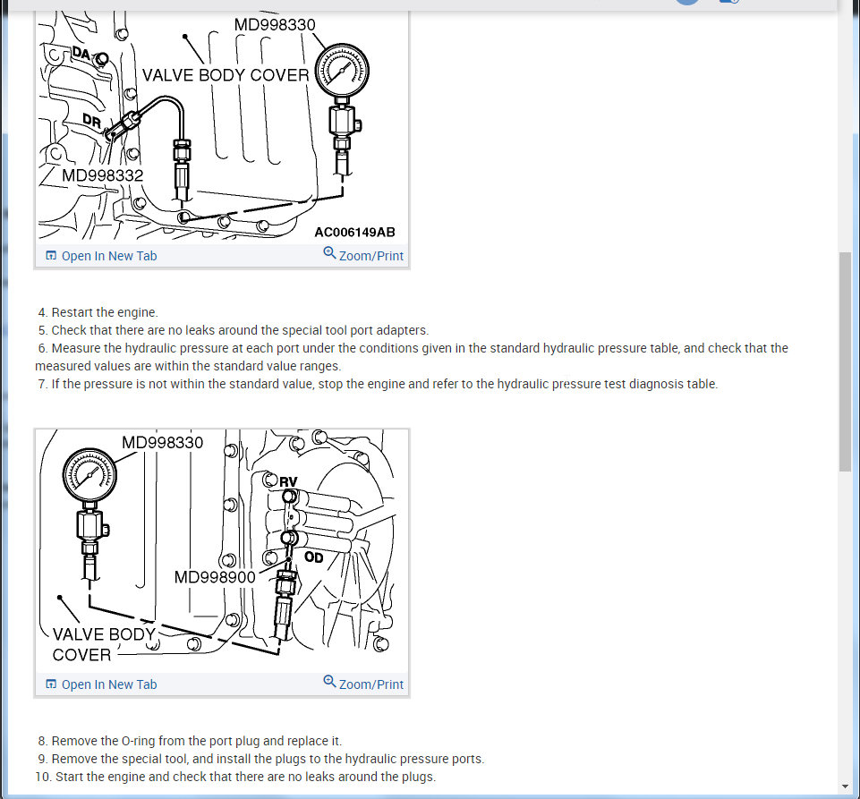

Driving down the street I noticed car felt like it was holding back. Glanced at dash and the Neutral, N, was flashing. Like i had it in neutral. Then I noticed when I came to a stop it wasnt shifting gears , staying in low and the rpm was almost at 3. When I got to my destination I turned it off. Took care of my business then when I left it wasn't doing it anymore. App the computer has reset on it. Haven't had anymore trouble with it. But want to make sure this isn't going to be a big problem or just a computer glitch. Checked transmission fluid is full, not black or dirty/trash in it. I have noticed also lately when I first take off in drive it feel like i am dragging something or that feel like a tire locked up and not rolling but it only last couple seconds then stops. Had transmission changed about 6 years ago. Not long after that change I noticed it has a hard shift when shifting out of first to second. Been doing that for years.

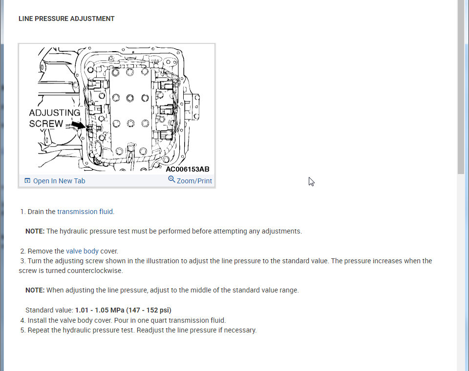

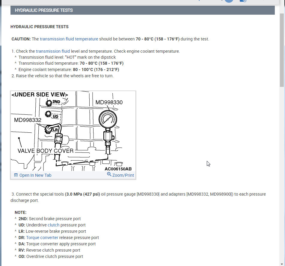

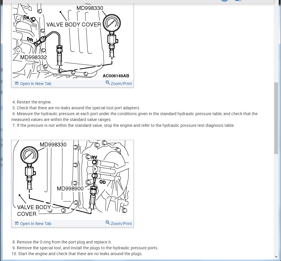

The next step if there are no codes is to check the pressure. This is not an easy thing to do but would be what we need to find out. I attached the process for your review.

That would be impossible for me to do, for one I do not have an pressure gauge. And taking it to mechanic is probably a no go, (depending on what they would charge to do it for me) I'm sure more than I could afford. Thank you anyway Kenny. You have been helpful. Sincerely,
