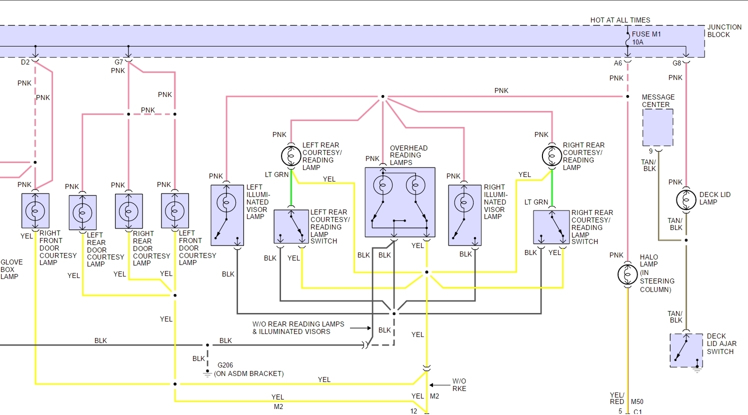

I have no tachometer, fuel, temperature or speedometer. Dash lights up fine. No courtesy lamps come on with drivers door opening, not sure if that is related. If anyone is familiar with this problem? I would love to here from you. I just do not know where to start.

Start with checking all fuses, if they are okay the cluster has gone and and might need replacement.

Thanks for responding. All fuses are fine, hi beam indicator works, turn signals work. I don't know weather to attempt a cluster swap or the 'BCM' I believe it's called, I've also heard ignition switch. These are all big undertakings for me, so I'm looking for what might be the most logical place to start? My only resources have been Google and YouTube so far lol.so I'd very much welcome and appreciate the opinion of an expert. Thank you

There is a fuse that runs both the interior lights and the BCM, here is a guide and diagram to help you.
