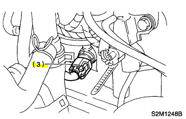

When you first turn the key on to the run position (engine cold) does the gauge immediately indicate the engine is hot? If so, then suspect there is a short in the wiring to the sensor.

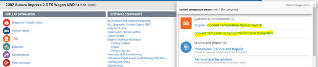

However, there are two coolant temperature sensors on this vehicle. One is for the cooling fans and the other is for the computer/gauge. Take a look at the pic below and let me know if that is the one you replaced.
Also, take a look through this link and let me know if you have any of the symptoms:

I believe it was the engine coolant temperature sensor.
And it doesn't go immediately to hot but within a couple min. even if the car itself is still cold. As I said, nothing indicates the car is actually overheating.

Okay. Here is an interesting thought: The sensors (two of them) are both called coolant temperature sensors. If I recall, the one for the fans is on the radiator. The other is on the engine. Do you recall where the one was you replaced?
Also, this still could be a head gasket-related problem. Did you look through the link I attached above?

I'm pretty sure it was on.
May 30, 2022 at 12:34 AM
TJALDRICH22
Oops, it was on the engine.
I didn't do it myself. My mechanic did it all.

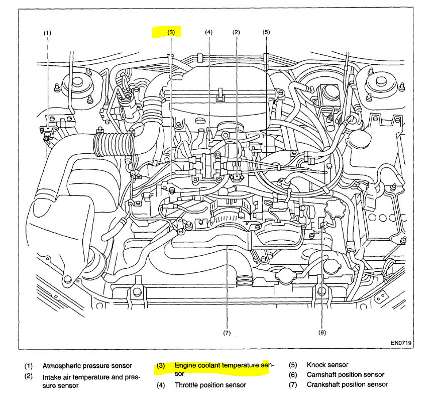

Okay, if there are no mechanical issues (sensor, head gasket, timing, restricted exhaust) then it has to be electrical. The sensor functions with electricity from the engine control module. Has all wiring been inspected including the connectors?
See pic below. This is from my manual.
