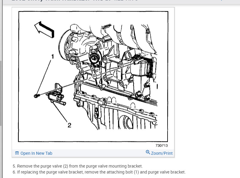

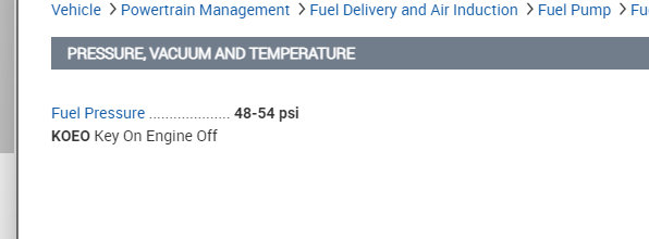

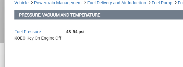

What I would suggest is starting with checking the pressure of the fuel and see if you even have a leak.
I am attaching the spec below because if you have a decline in fuel pressure pretty quickly then you have an external leak or an issue with the regulator.

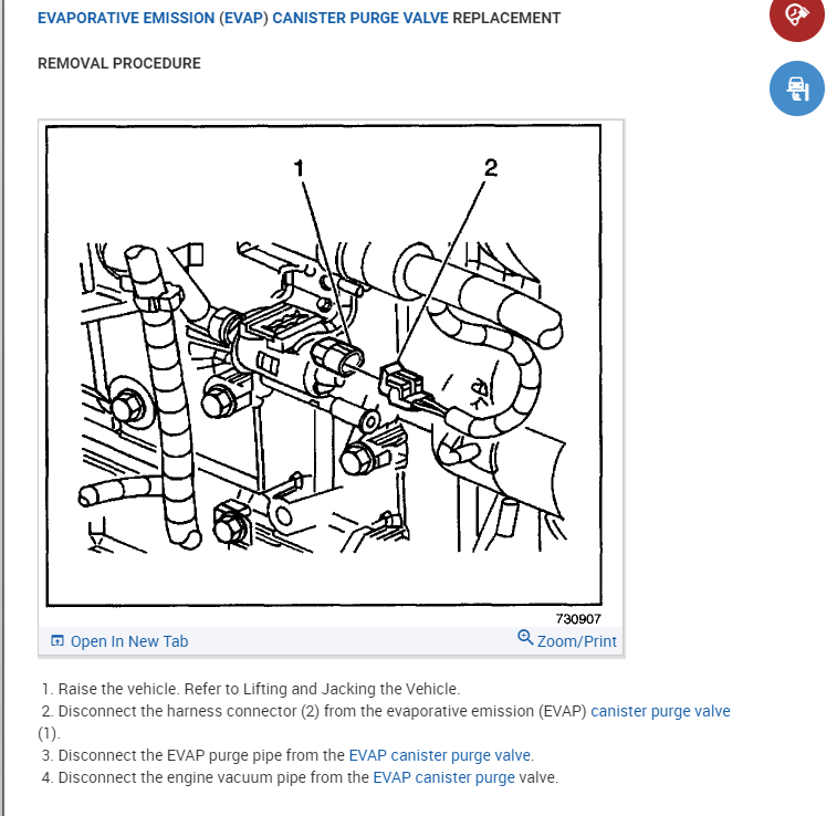

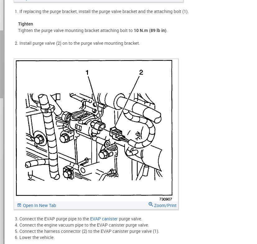

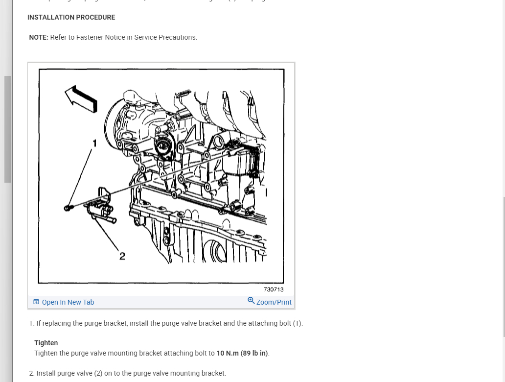

If you do not and the pressure remains steady with the engine and key off, then you most likely have a stuck purge valve that should be closed when the key is off.
Basically, the purge valve allows fuel vapor into the intake so that you can keep emissions down.
https://www.2carpros.com/articles/how-emission-control-systems-work
Take a look at the info attached and let us know what you find with this. Thanks
