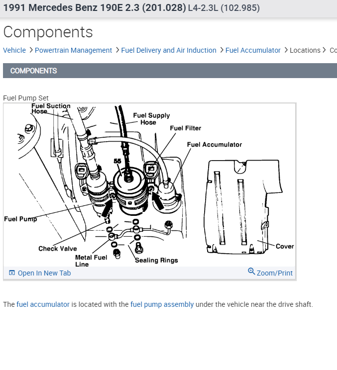

Where is the gasoline accumulator located?
1991 MERCEDES BENZ 190E
120,000 MILES • 1.8L • 4 CYL • 4WD • MANUAL
ENRIQUE UNO
Gasoline accumulator location needed for the vehicle listed above.
Jan 8, 2022 at 12:42 PM
SQM
  • 6,383 POSTS

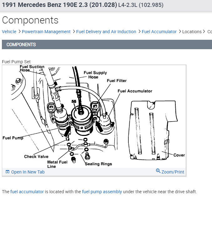

The fuel accumulator also known as the fuel pressure regulator is located with the fuel pump assembly under the vehicle near the drive shaft (see diagram below).

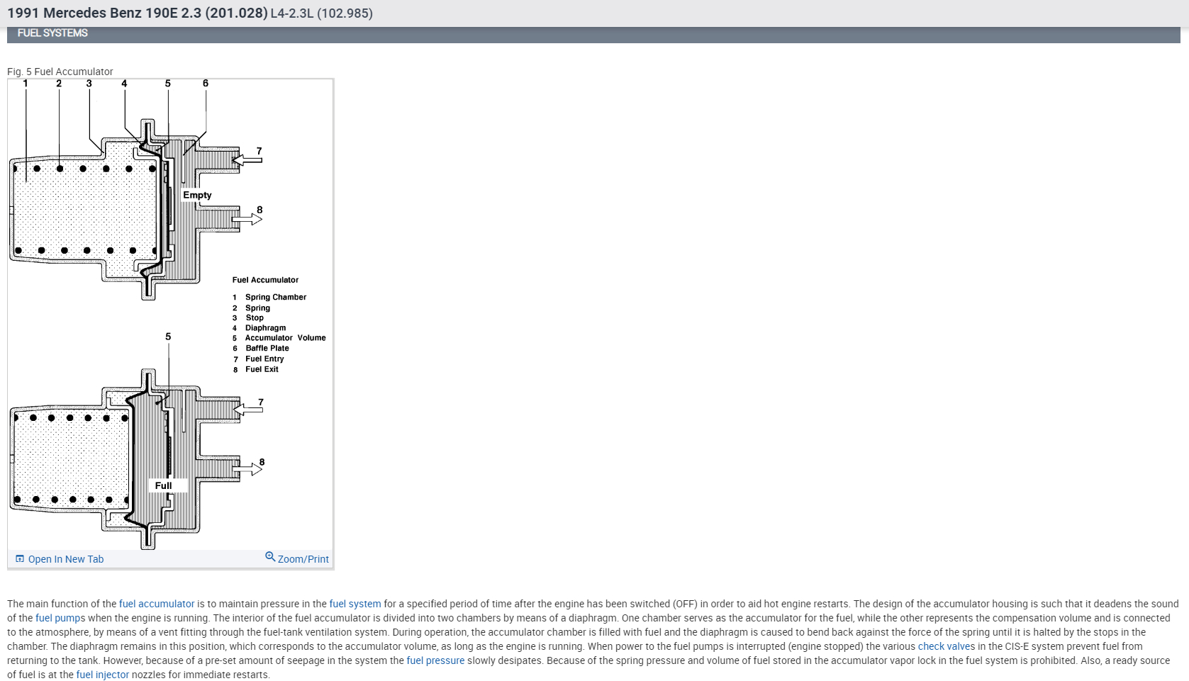

The main function of the fuel accumulator is to maintain pressure in the fuel system for a specified period of time after the engine has been switched (off) in order to aid hot engine restarts.

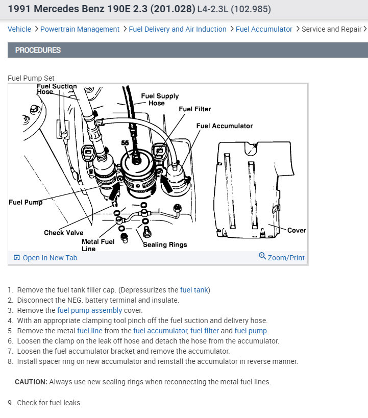

I have attached the replacement procedure for your reference.
