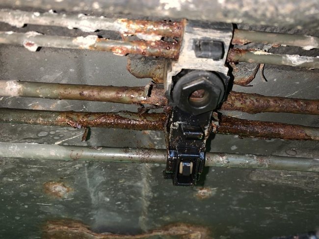

My son did as you said, and it was coming from the second from the bottom pipe that you see in the picture. Whatever needs to be replaced, do you think an amateur would be able to do this? From the video that I just saw, maybe I should mention that the amateur is a plumber who deals with pipes.
Aug 9, 2020 at 7:50 AM

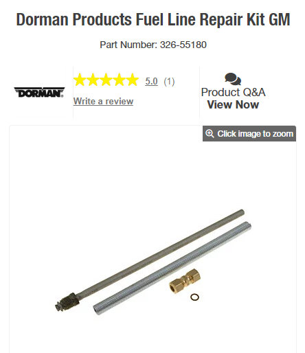

Oh my. Yeah that is the cause. Clearly this is something you need to decide if you are comfortable doing. If you are a plumber then this is nothing new but the only difference is this is a fuel line.
I am attaching a picture of a repair kit that basically you cut out the rusted line and splice in this new line. Otherwise you have to replace the entire fuel line and I would do each of those lines where the rust is. So to replace all those lines, that is a pretty extensive repair.
If you feel good about using this type of repair line then I would go for it because the principal is no different then repairing a drain line that has a crack in it. You don't cut the walls open and replace the entire pipe. You cut out the crack and use two connections and put a new piece in.
Let me know if you have more questions on this.

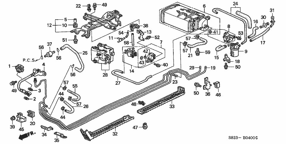

I found one diagram on the internet but I think it's for a 2.3. I have a 3.0 if that matters. This is the diagram from that. He says I need # 19, 23, and 29. Is that correct and what are the actual names so I can order them?
Sep 8, 2020 at 3:52 AM
These lines are called the fuel supply and return line. I attached some diagrams for your vehicle.
If he wants to, he can just get some straight fuel lines and remove the old then bend the lines to match the hold ones. This is much easier then it sounds and much cheaper.
If not, then just sourcing fuel lines, supply and return, would get you the parts you need. Let us know if you have other questions. Thanks
