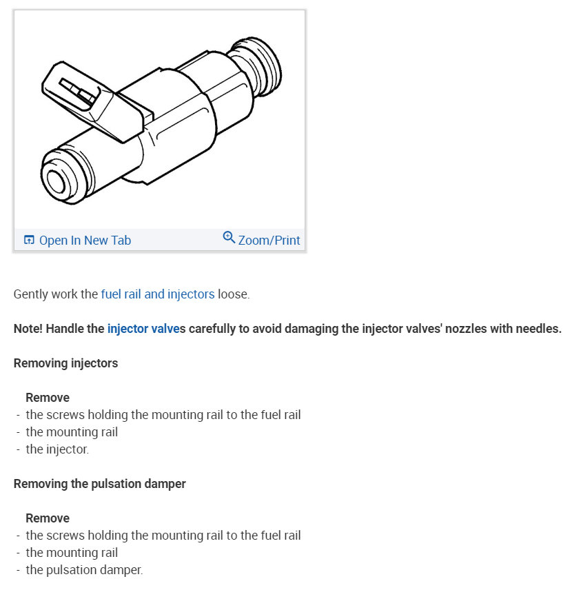

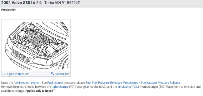

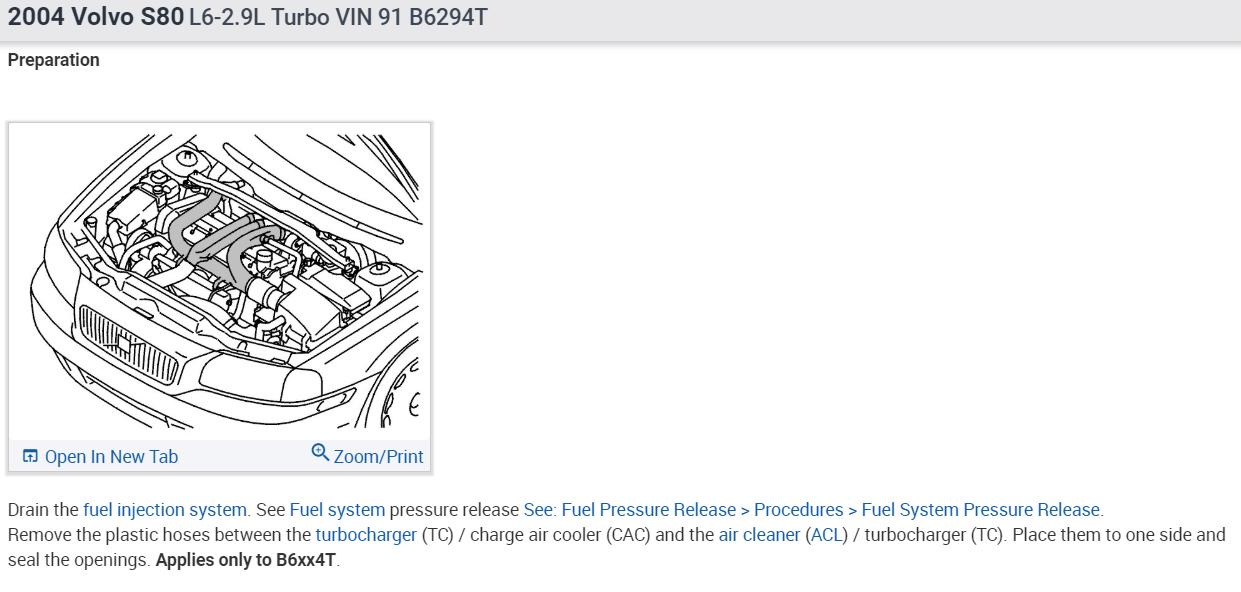

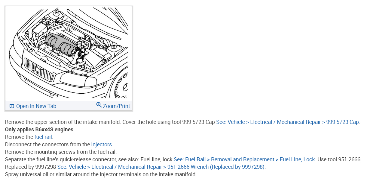

It sounds like you have a fuel injector leaking can you raise the hood and remove the engine covers so you can see in the fuel injectors. Use a flashlight to inspect. Let me know what you find. If the injectors are leaking. here is a guide to help walk you through the steps with diagrams below to show what it will be like on your car:
https://www.2carpros.com/articles/how-to-replace-a-fuel-injector
Check out the diagrams (below). Please let us know what you find.
