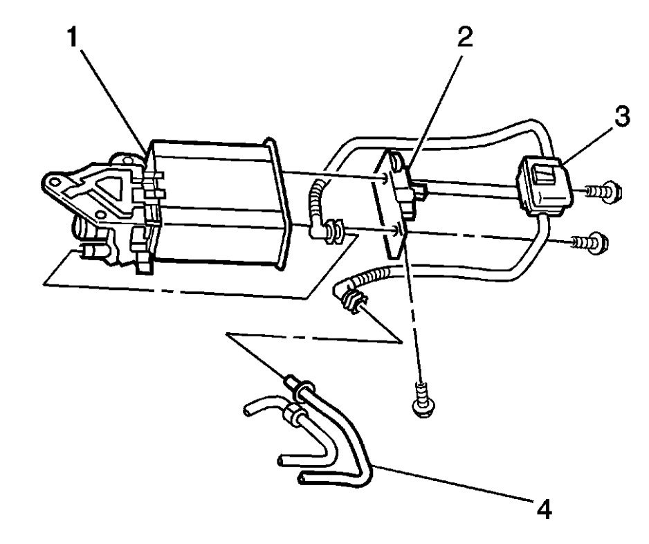

Okay, reduced mileage and pressure in the tank are related. I would check both the EVAP vent valve and the canister. Do you ever top up the tank? IE add gas after the pump clicks off.
If yes suspect the canister, if not then the vent line has a problem. The canister on these is known for failing and dumping the charcoal into the lines causing them to get blocked.
I would start at the vent valve, it's under the car and has two lines on it that connect between the charcoal canister and the filter. If you remove the line and find small black pellets the canister has failed. Replacement isn't hard but it's not a cheap part. You go to the canister under the rear driver's side, remove the hoses and electrical connector. Then use compressed air to blow out the lines and clear the charcoal. Also clear the line from the air filter. Then unbolt the canister and bolt in the replacement. Reconnect the lines and electrics and drive it.

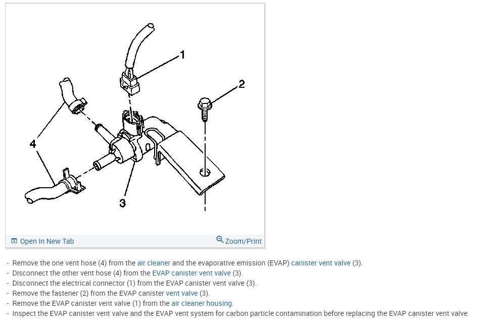

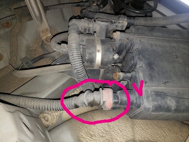

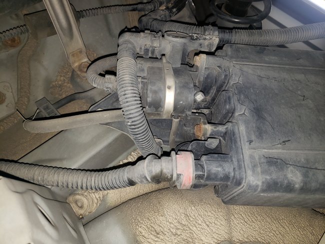

Which lines go to the vent valve? I can't tell when I actually get under the car and look. Everything is so close together.
Aug 29, 2022 at 3:53 AM
STEVE W.
  • 15,352 POSTS
This is the vent line.
