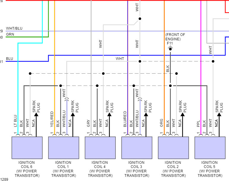

Car listed above is a FX35. Customer changed spark plugs, then noticed not running well; stated may have mixed up coil connections.
I think I have a coil connection right, but still running rough at idle, and smokes at higher RPMs.
A p0300 comes up after about a minute.
Scanner shows STFT bank 2 pegged at 25%, bank 1 is normal.
New plugs 2, 4, and 6 seem dark and fuel fouled.
Tried a smoke test but could find no leaks (assuming an intake manifold gasket failure).
Not sure where to go next, any help or ideas would be greatly appreciated.
Thanks

you would think so, but i would recommend doing a back pressure test on both cats to see if one banks cat is bad. Because this has a mass air flow sensor, sometimes because of low air flow on one bank the ECM may overcompensate. I mentioned this because there's a case study of this happening, no cat codes, and same situation. And also, because you have a whole bank affected by this issue. It was a case study by John Thorton, I think it was named fuel trim imbalance. The other shops couldn't figure out what was happening, they even pulled the cat down and inspected it but missed the melted cat somehow. So, checking the either the back pressure, or dropping the exhaust and inspecting them, but the back pressure test is easier, 1 PSI is the max on a converter back pressure. It's worth checking out, especially since you have a bank that is completely pegged out.
Here's the Coil wiring diagram to check that if needed:
it's also odd that the 02 is reading full rich at .7v and still 25% fuel trim. With that reading the ECM should be going completely the other way.
https://www.youtube.com/watch?v=hmFozmTf7xg&t=35s
