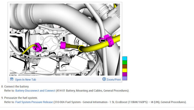

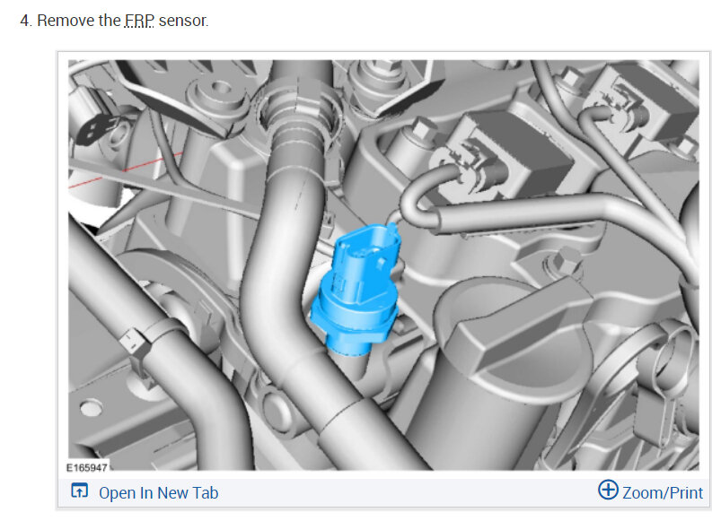

Yep, this sounds like the fuel pressure sensor is going out, but we should run the codes to see which ones are stored, this guide can help:

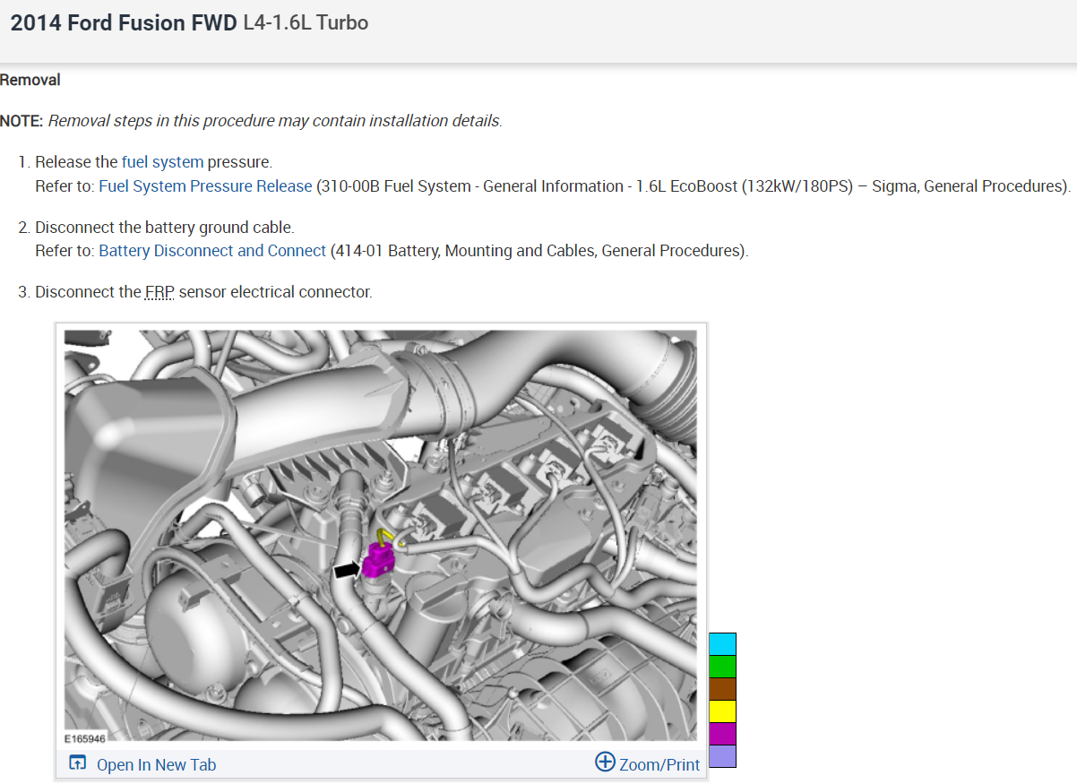

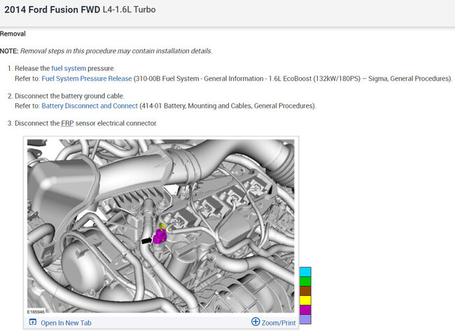

Here is the location of the fuel pressure sensor in case a code comes up for it. Check out the images (below). Let us know how it goes.

My reader gave me P0087 fuel rail/system pressure too low and to replace fuel pump. The second possible fix showed as replace fuel pressure sensor. I will try the sensor first and go from there.

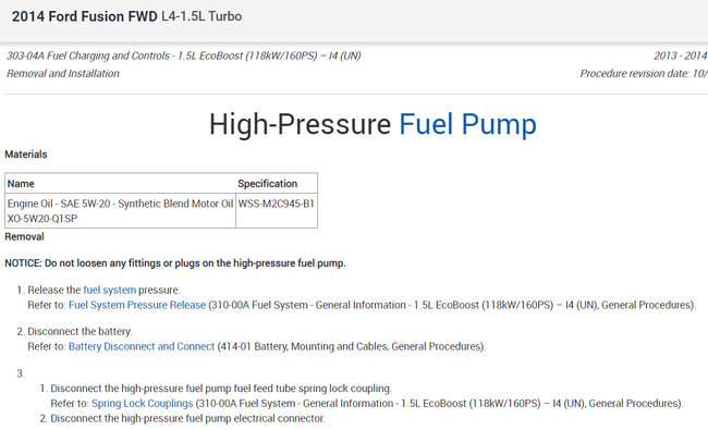

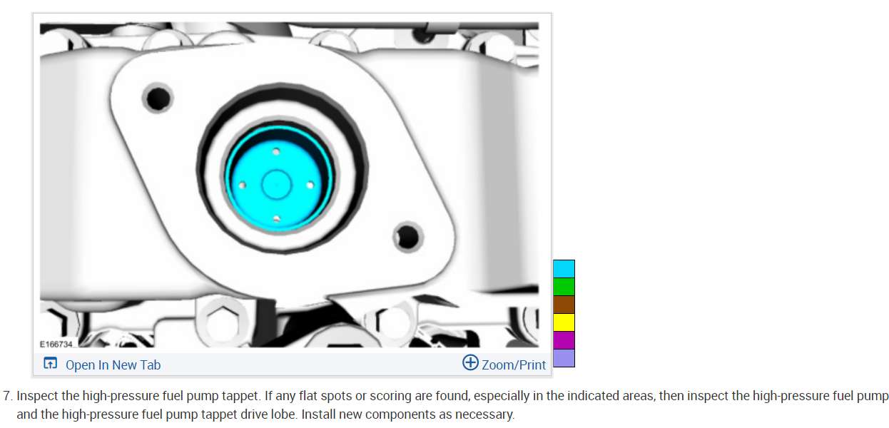

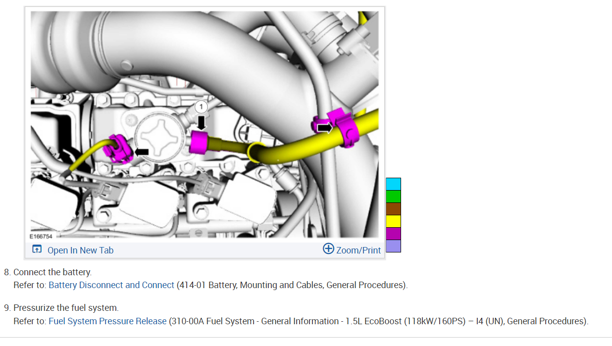

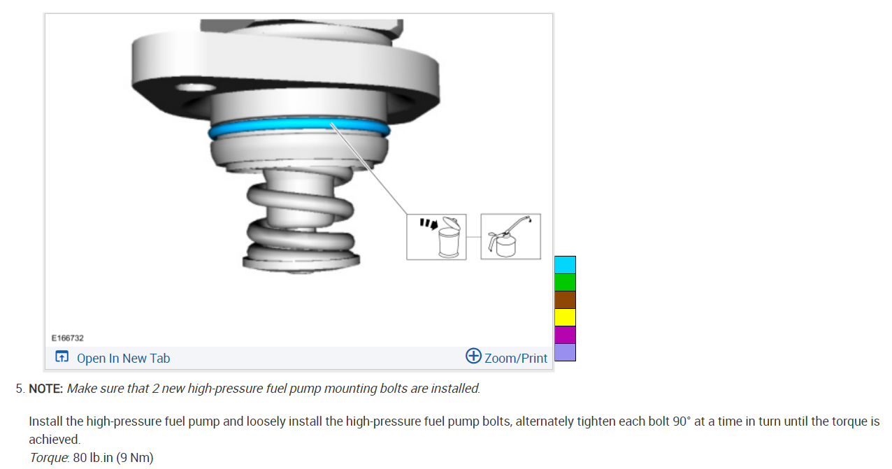

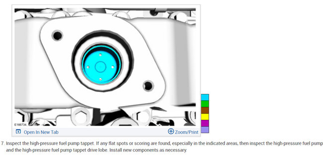

Just a final update, hopefully. It seems to have been the high pressure fuel pump.
Oct 16, 2024 at 10:17 PM
  • 55,423 POSTS

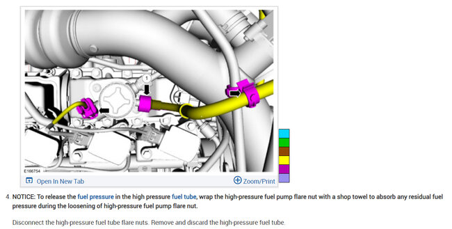

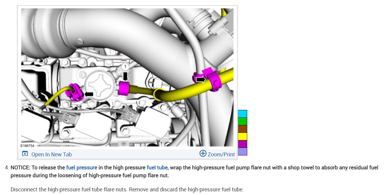

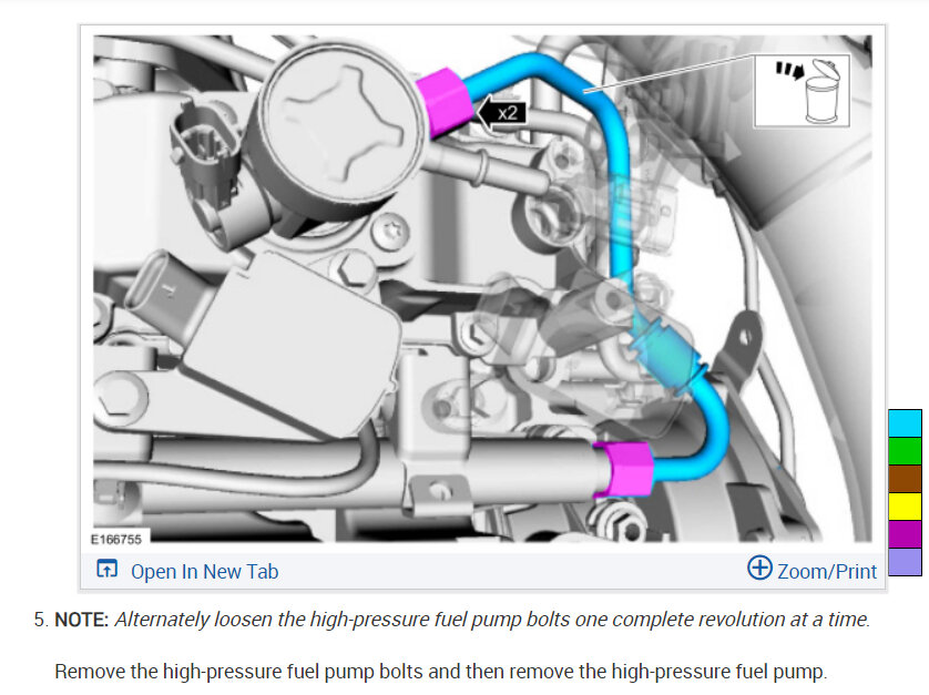

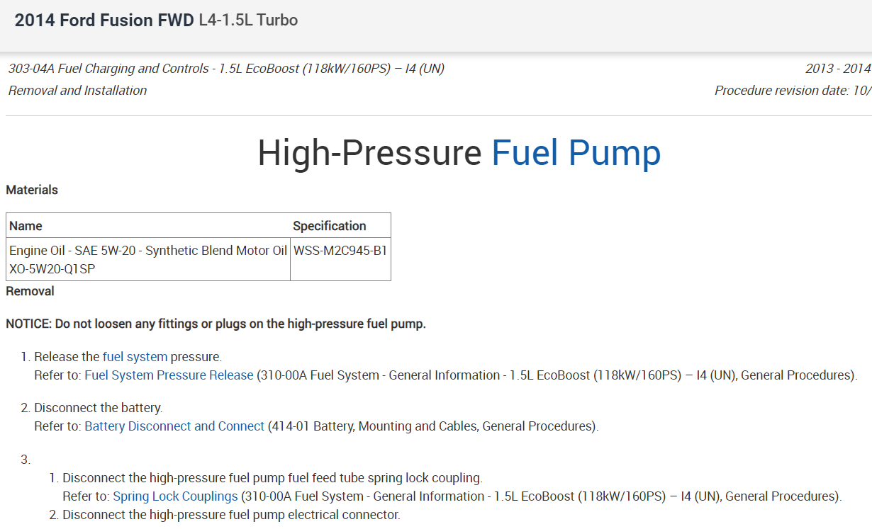

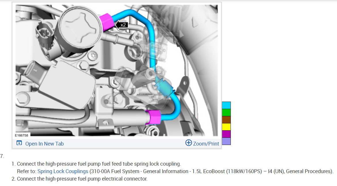

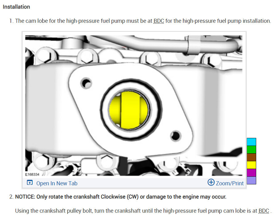

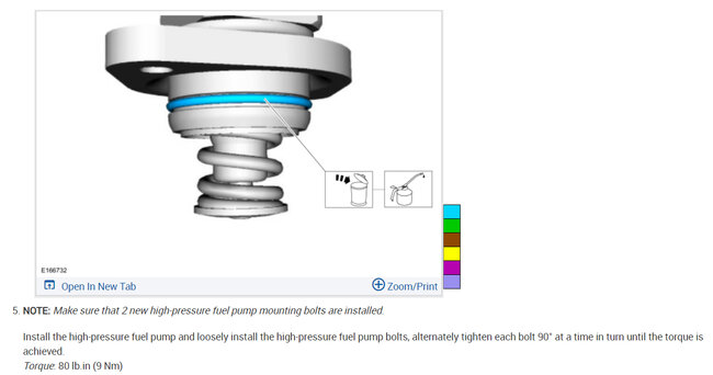

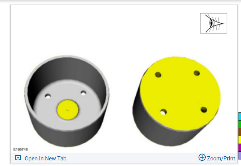

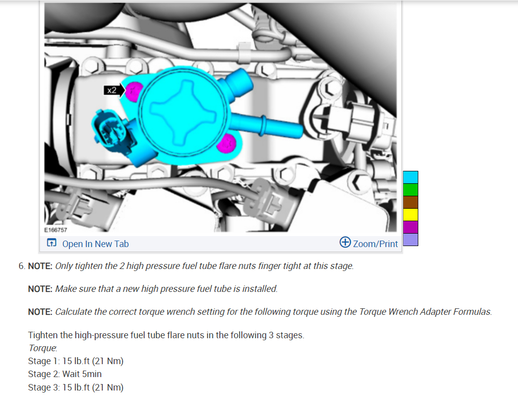

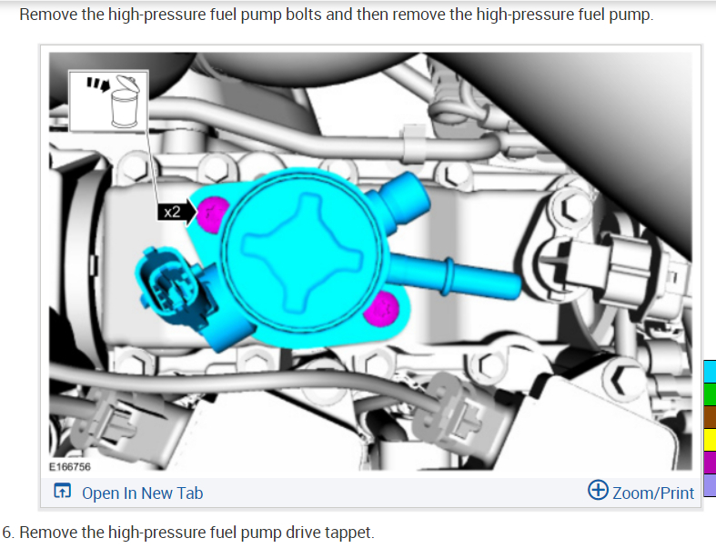

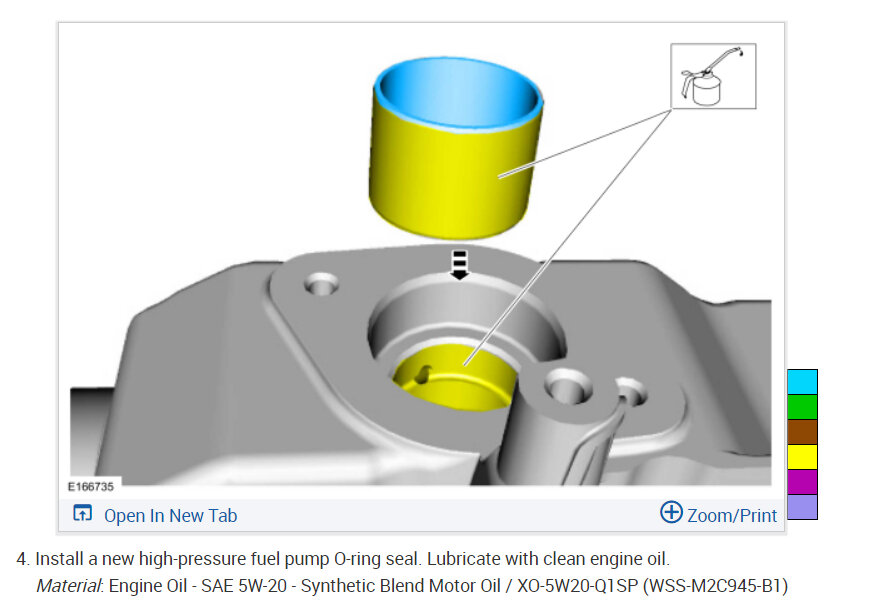

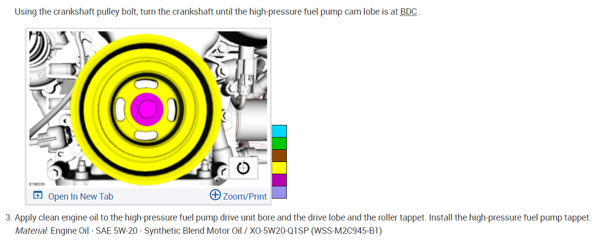

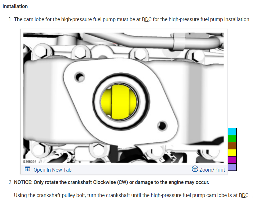

That is a little premature, but it happens. here is how to replace the high-pressure pump in case you need it or want to see how the job is done. Check out the images (below). Let us know how it goes.
