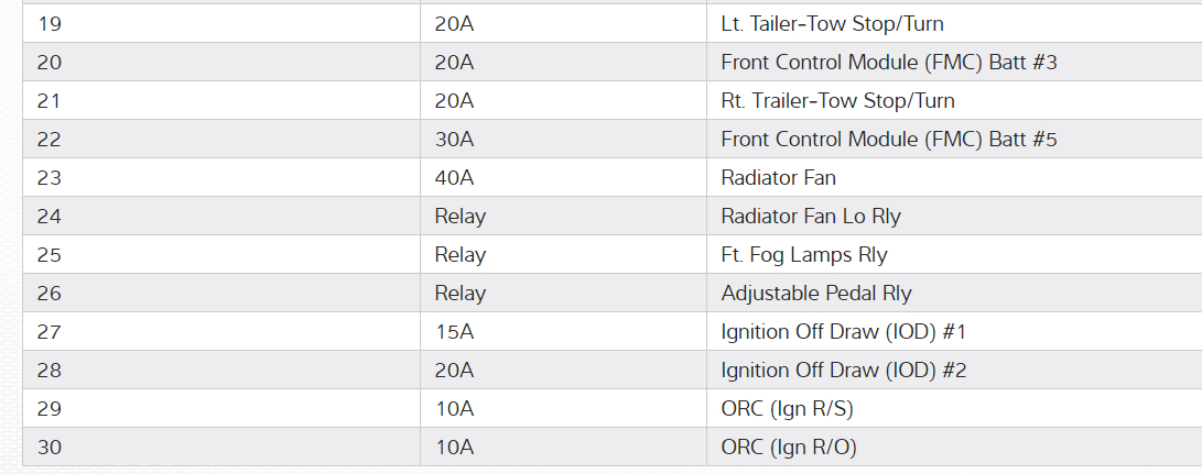

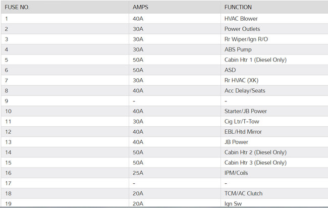

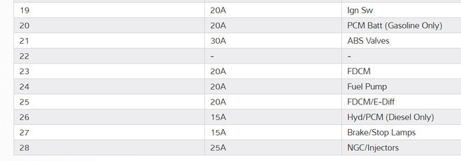

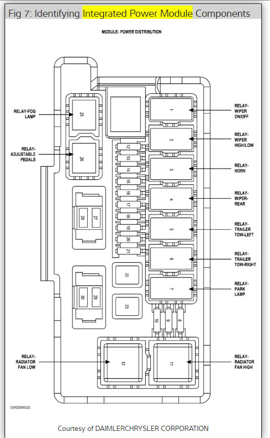

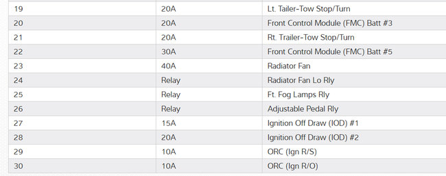

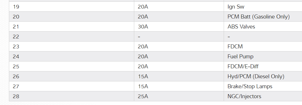

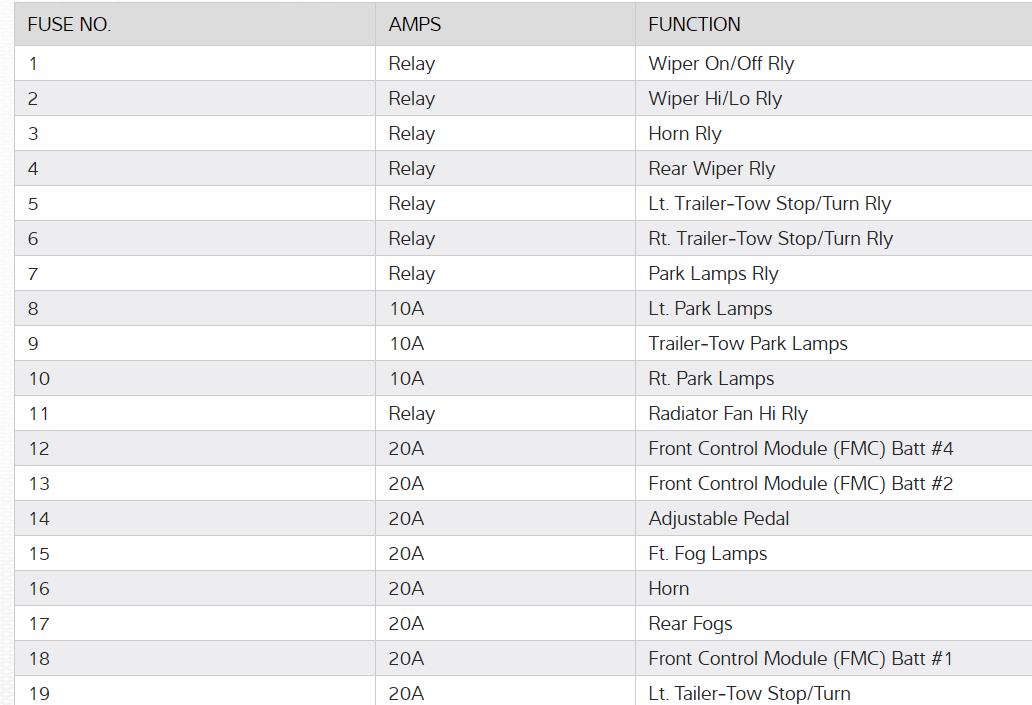

Hi Chad, thank you for using 2CarPros. Here is the fuse location is it because your key fob isn't working? This guide will help check the fuse with the fuse ( #14 and #18) location in the diagrams below.
Check out the diagrams (Below). Please run this test and get back to us.

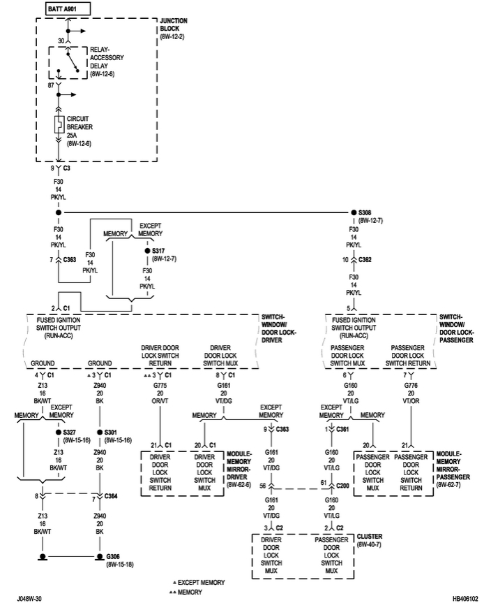

Here is the wiring diagram for the key-less circuit. This circuit is on an auto reset circuit breaker so if nothing happened I would test for voltage on both sides of the breaker to make sure it is good. It should be located in the fuse box under the hood.
Let me know what you find, Rich
