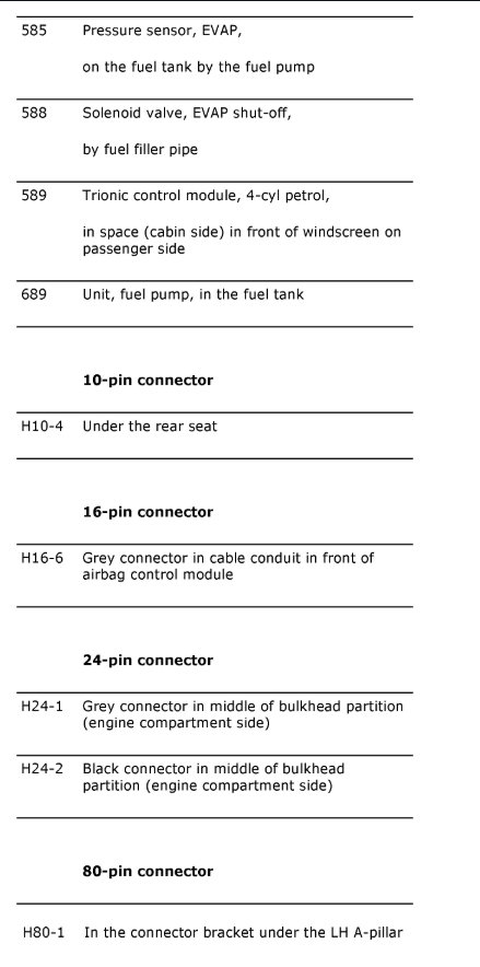

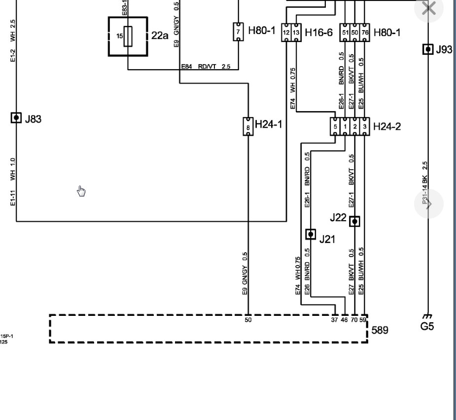

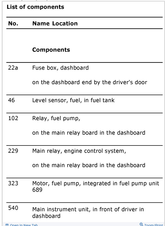

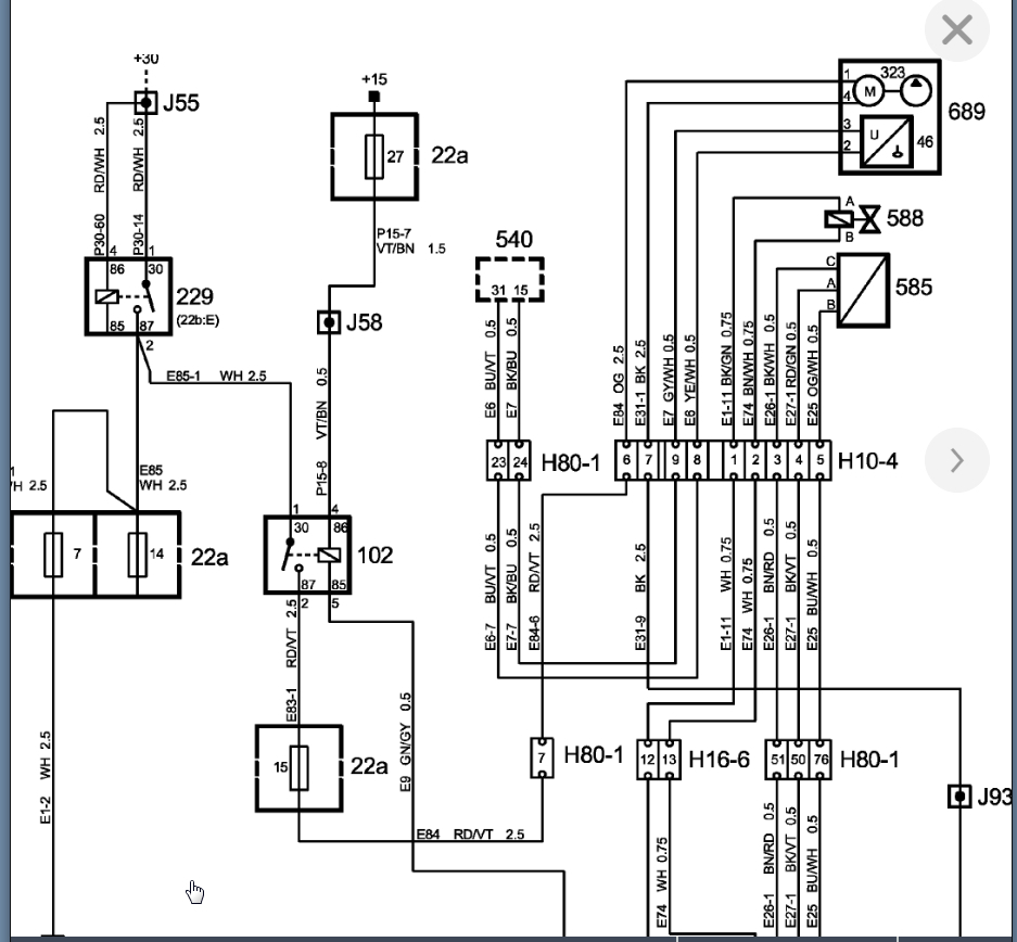

trying to find out which fuse and relays govern the fuel system and locations.
Sep 19, 2019 at 8:11 AM
I attached the components of the fuel system. Unfortunately, they only have a diagram and the a description of where each are. It does not give a location view.
Let me know if this is not enough and I will see if I can find something via a Google search. Thanks
