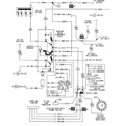

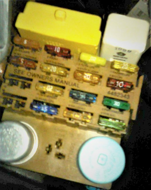

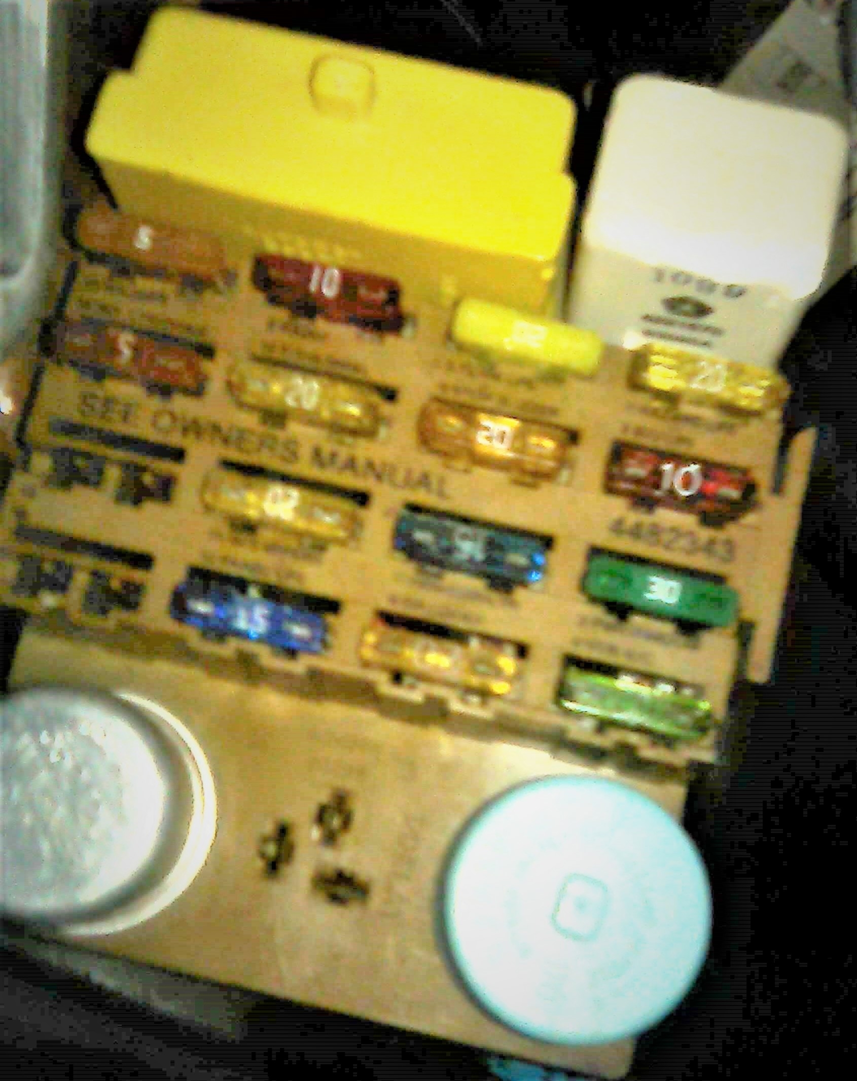

I just bought the vehicle listed above. The taillights and dashboard lights were not working so I checked the fuses and replaced the burned out 20 Amp fuse in the#5 slot. The dashboard lights came back on but then the headlights stop working,although my brake lights, hazard lights, heater blower, turn signals, radio, windshield wipers, continued to work and also my instrument panel lights came and door buzzer. I cant find a headlight relay.I rechecked the fuses again and lost my radio and door buzzer although the fuses are all new.
Apr 29, 2020 at 4:18 AM
Good afternoon,
I attached a wiring diagram for you to view. You will need a test light or voltmeter to some testing.

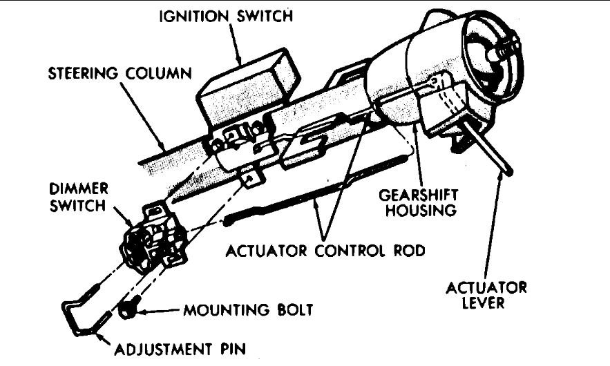

We need to see if power is going to the headlight switch.
Then we need to see if there is power to the dimmer switch.
Let me know when you have the equipment so we can continue.
