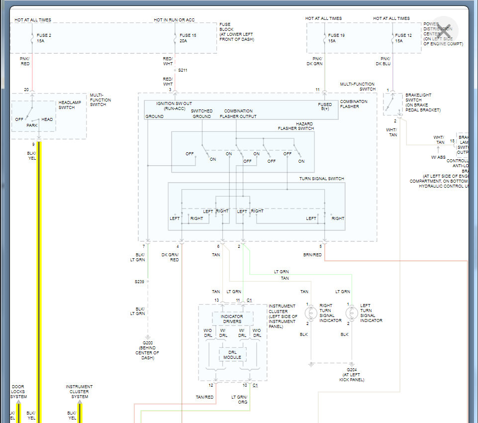

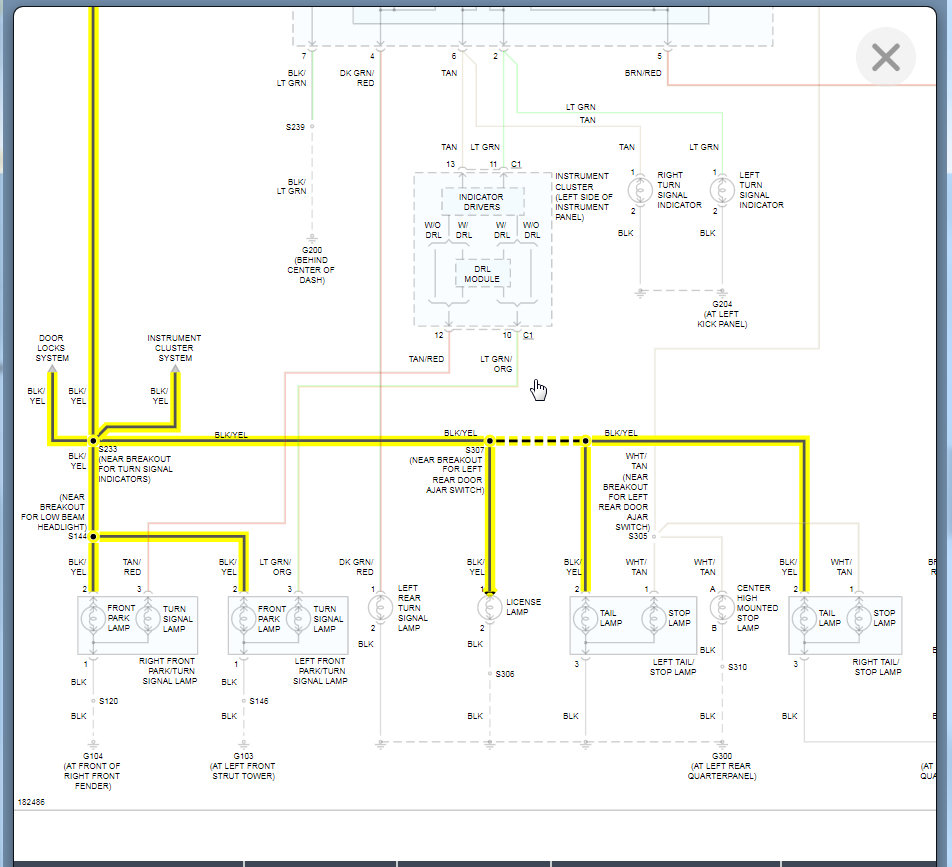

I cannot find my tail light fuse. My tail light doesn't work but the brake light does. I just need to find which fuse it is so I can check it.
Jun 1, 2021 at 4:09 AM
There is a fuse for this but this is for the multi function switch.
I would suggest testing the voltage from the switch to find out if it is functioning. However, if your headlights are working then the switch is working.
If the tail lights are the only thing not working then I would check for voltage at the lamps and then backtrack through the system until you find the voltage. There is a splice that I suspect may be the issue but let's start with this and go from there. Thanks
