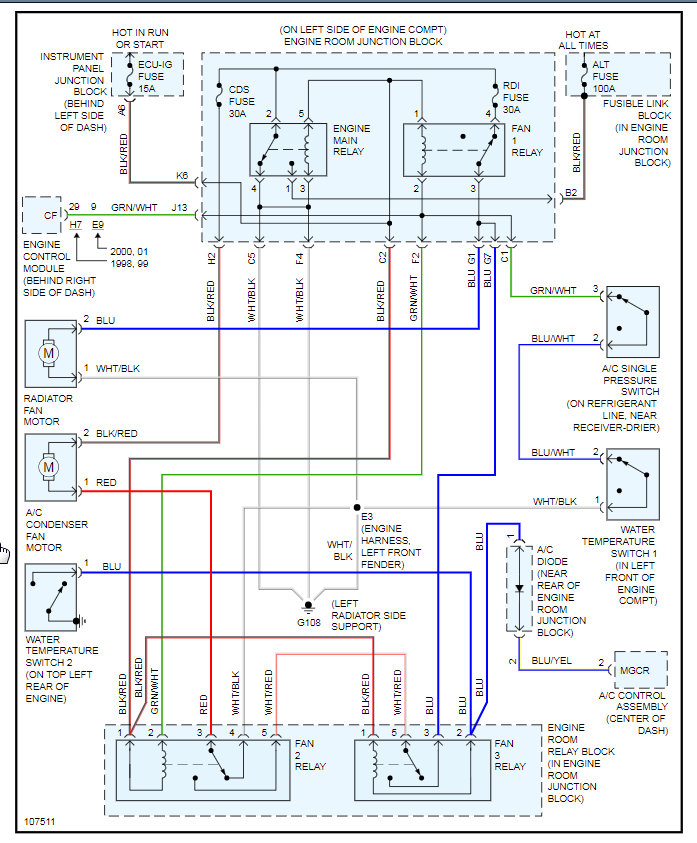

Cooling fan will not shut off.
Nov 14, 2020 at 2:13 AM

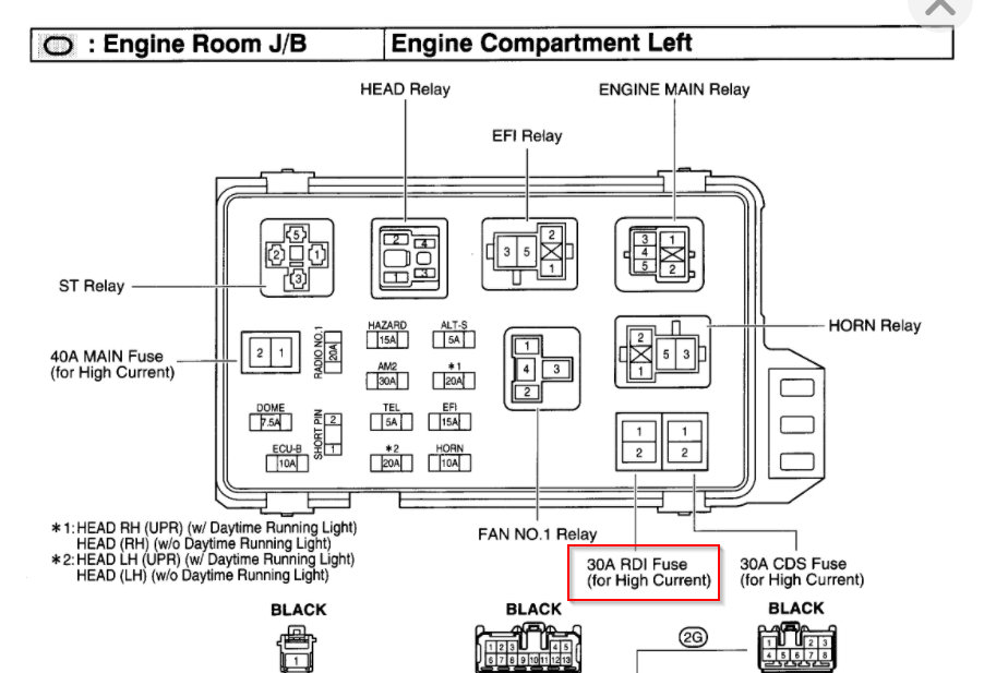

You have a couple to chose from. I would pull the RDI fuse which is illustrated on the attachments.
Clearly you have a short and it may just be the relay so you may want to try and replace that first and that may fix the issue. It is the Fan No 1 relay. Let us know if you need more help.
