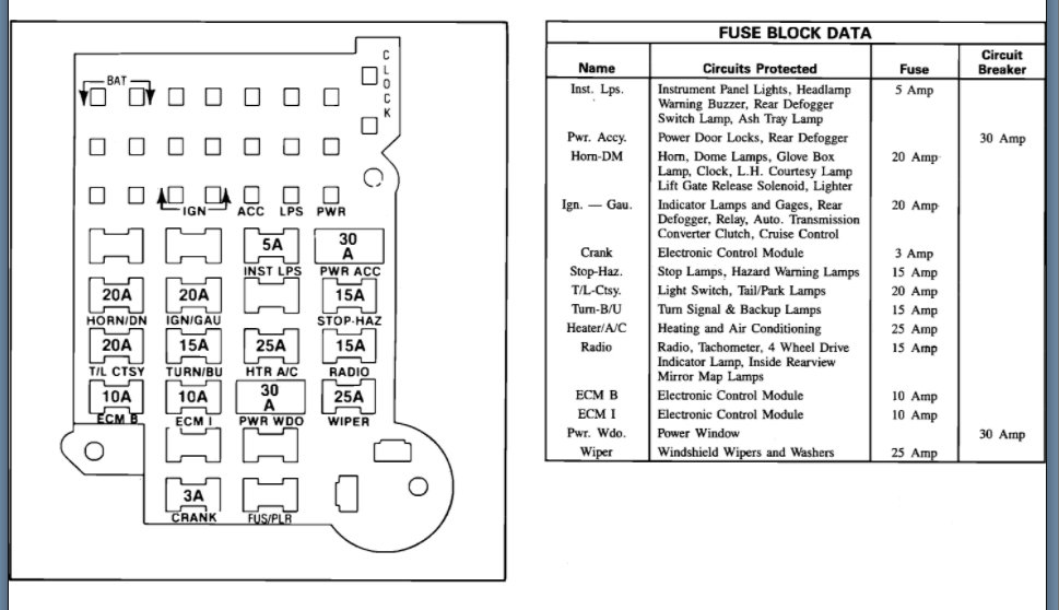

I am trying to check my fuses
1988 GMC S15
190,000 MILES • 2.8L • V6 • 4WD • MANUAL
JASONL77
  • 12 POSTS

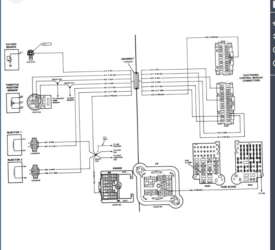

I’m having some issues with my injectors not spraying and I am trying to check my fuses. None of my fuses are labeled and I’m needing help to figure out exactly what’s what. The truck is turning over but the injectors aren’t spraying at all. They’re getting power.
Jul 3, 2021 at 7:46 AM

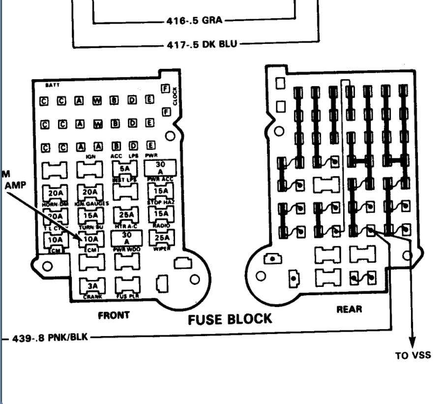

I am attaching the info below but it looks like they run off the ECM 1 fuse.
Here is a guide that will help with testing and replacing fuses if needed:
Please run through this info and let us know if you have other questions. However, if the fuse is okay, I suspect the PCM itself is the issue unless there is other info to go on.
Thanks
Jul 3, 2021 at 11:38 PM
