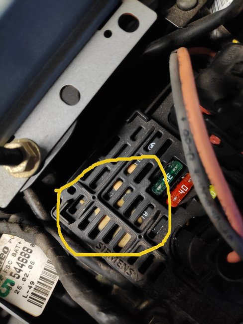

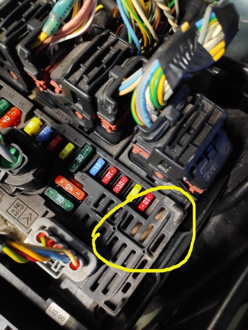

Hello, I have the car listed above petrol with auto transmission. The problem I am facing is that the car works properly, but most of the fuses don't get voltage in both engine bonnet and under the steering wheel fuse boxes. Autopilot is not working,heated seats are not heating, rear wiper is not working, I diagnosed the car with OBD Bluetooth scanner tool and there is the code P0410 which in my opinion is the Air system as it also shows in the scanner, so I checked the fuse for the air pump which is also not getting voltage. I am not in my country and living abroad where it's so hard to trust mechanics. I would like to fix things on my own in general and I don't know where to start since I'm a bit nerd with electrics. I thought of checking the relays but I don't know which relay is my target.
Also there is weird thing in engine bonnet.the fuse box. I am adding the image of it but It's like some plastic melted and dried there. I checked it with screw driver, I could push it but nothing more. Any clue is appreciated! Thanks in advance.

The does look strange over the fuse panel. can you remove the plastic cover and see what it is? Upload a new picture of it? Also it does sound like the ignitions witch is not working correctly. Please let us know what you find.

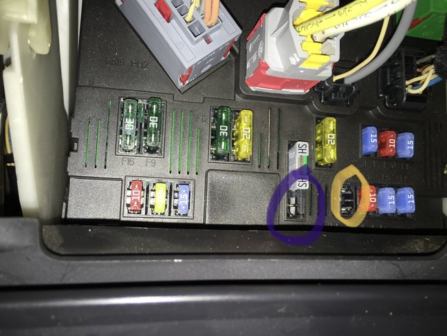

Hey Ken, so I did the test only in the cabin part under the steering wheel fuse box with ignition on and I noticed that some fuses did actually get the voltage and some others remained asleep. The one that I marked with yellow (its 15 amp, took out the fuse to test with ohm) is still numb. Next to it red 10 amp did light the tester after I turned ignition on. But I noticed one more thing that where is the blue mark on the left had voltage but there wasnt anything in there, I just checked with the tester pen and it has voltage. What kind of fuse should I put there? Because there wasnt any fuse in there since I got the car. Tomorrow Im going to test the engine compartment and gonna update you. If you know anything about that empty spot I would very much like to know.

Thanks for the image. it looks like the fuse places that are empty are for accessories that are not used or featured in this car. Can I ask does the engine start and run?

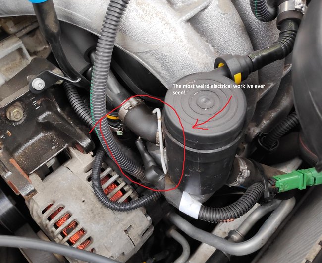

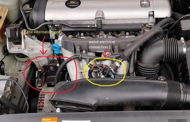

Hello again. Sorry It took me long time to get to my car because of work. Well I didn't have to go through all those suggestions you have given because me and my friend have noticed that my car doesn't have Alternator!! How cool is that? Turns out that the dealer just took it away from the car and did some electrical ticks. (I'm assuming since the car runs normally and doesn't give any obvious symptoms of absence of the alternator such as not cranking etc.) We did notice two more things and I'm going to add image here to show you guys. Its very weird electrical connections in front of the engine (I will mark to show you) and I'm assuming those are the the tricks. I know you guys are not familiar with Peugeot but I thought you would still know much more than I do :)

Now that I noticed again I might be wrong about alternator. On second image there is that copper colored solenoid with silver cover down there, is it the alternator? If it is, then what should be in that spot I marked? I'm devastated.

You are okay, that is the alternator it could be where the AC compressor goes though.

HAWAI1907, your car can't run well without the alternator otherwise known as generator. The sport you marked as alternator sport is pooling sport and in some Peugeot model, which is where the steering pump is located to be driven by sapient belt. However, this model of 407 has an electromechanical steering pump ( to your left, close to radiator expansion container) Your alternator is right that device you see with copper wires inside opposite the electromech pump. Once again, no gasoline or diesel engine vehicle can run without an alternator.
