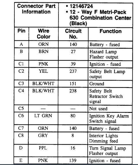

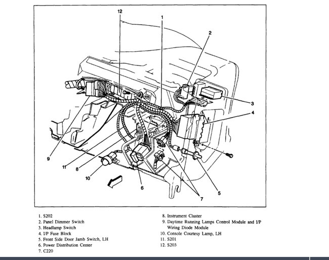

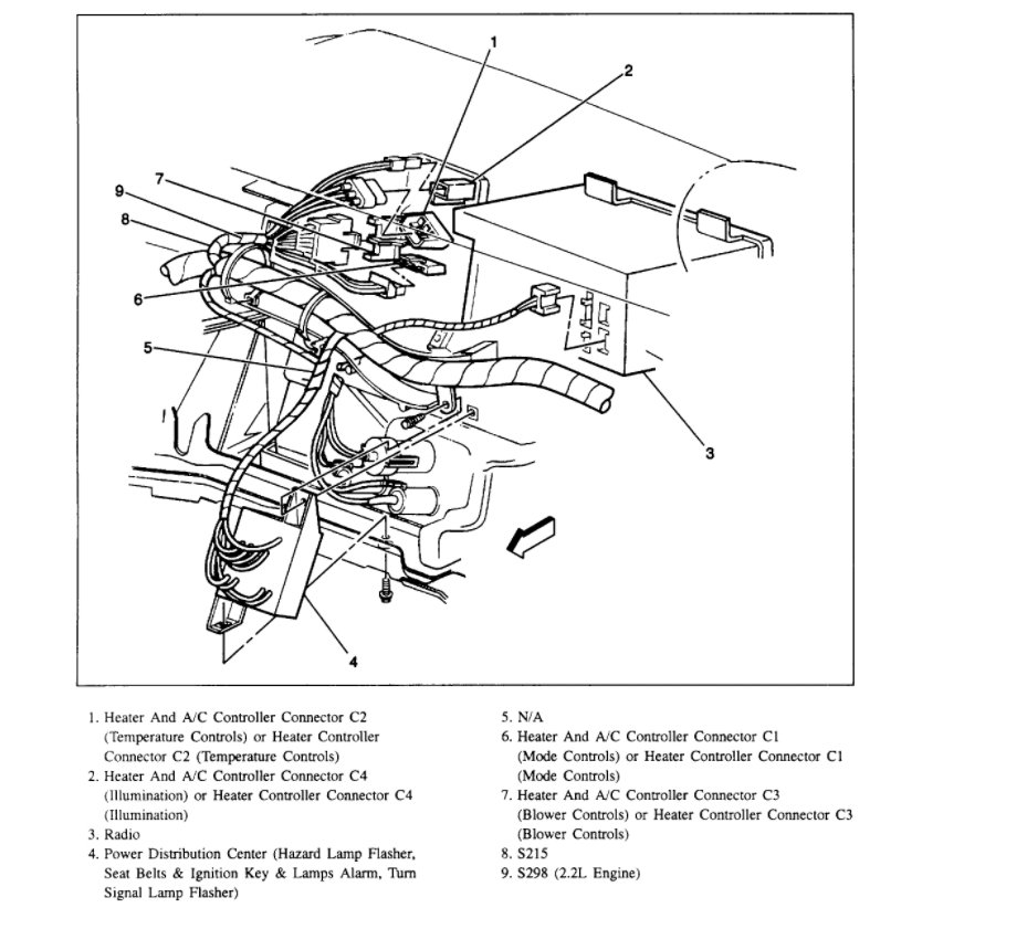

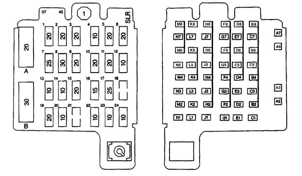

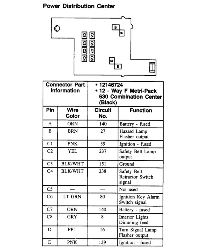

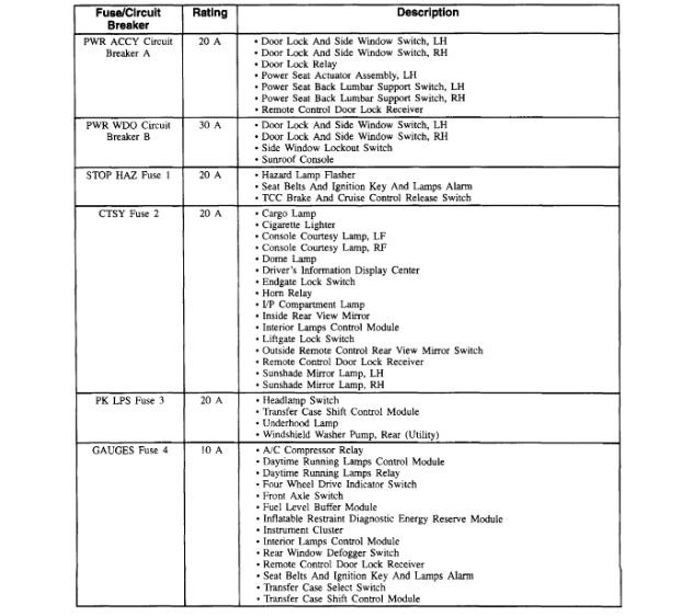

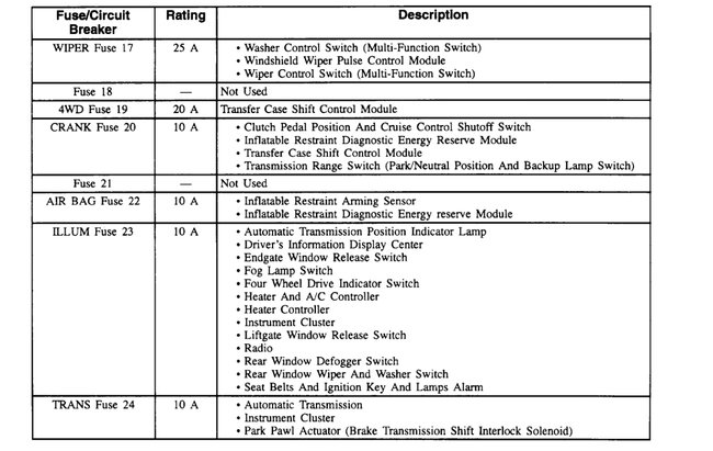

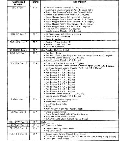

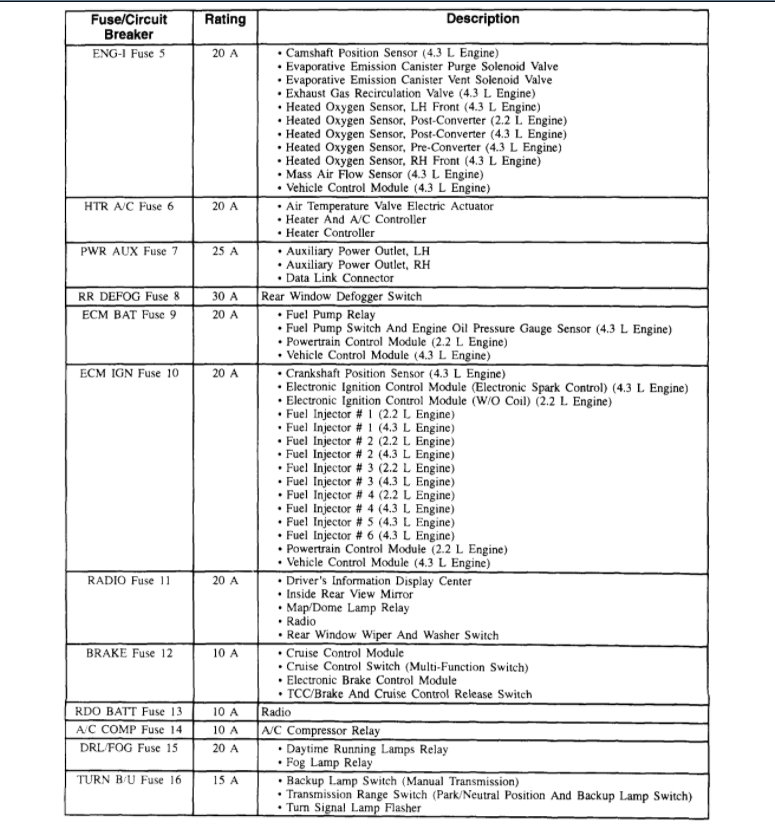

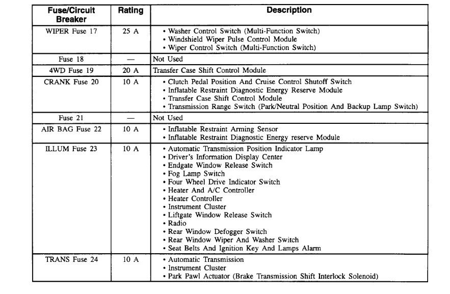

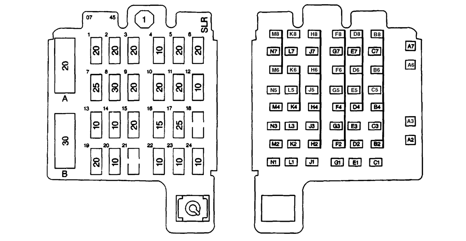

Can you help me with the fuse box diagram inside the truck and under the hood if any?The truck didn't have a manual for it when I got it. Can you tell me what number goes to what and what amp of fuses? Thank you

I have included the information that you requested in the diagrams down below. I hope that this helps and have a Happy New Year.
Thanks,
Alex

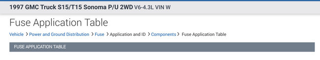

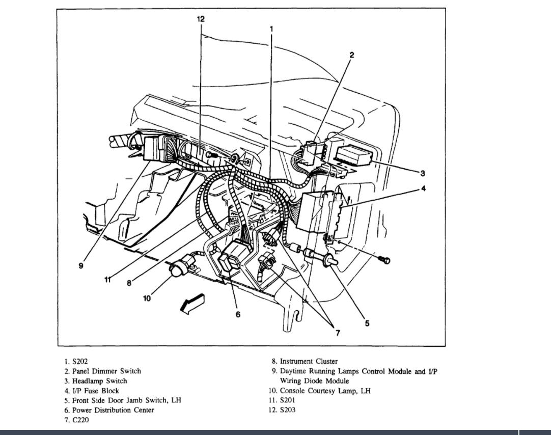

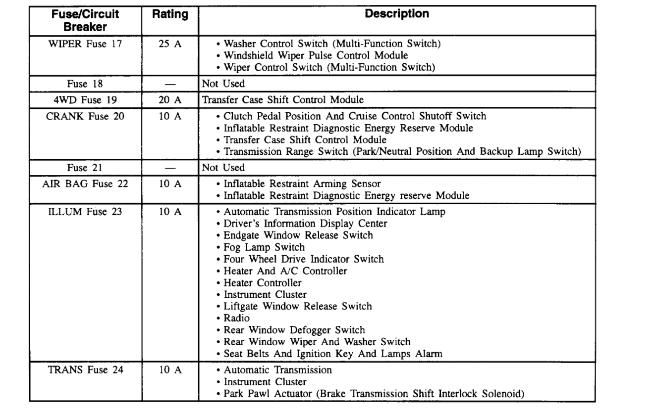

Good afternoon,

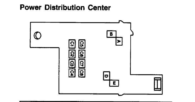

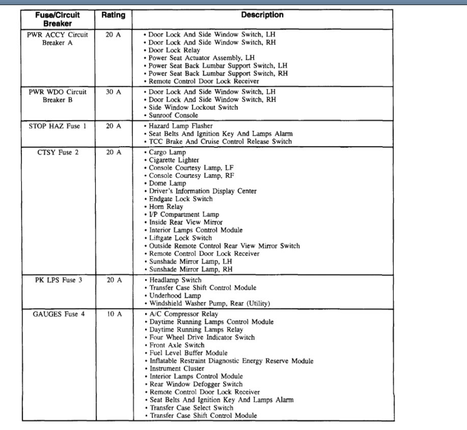

I attached the diagrams for the fuse box as requested.
