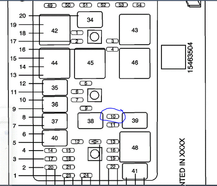

Was using air compressor connected to cigarette lighter and compressor stopped. I plugged in cell phone to check and it didnt charge. I checked all 10amp, 20amp, 25 amp fuses but none were popped. I was told to check fuse # 10 so I extra checked that one but it looked intact.
Sep 18, 2020 at 2:09 AM
Good afternoon,
I attached the fuse box diagram for you to view. Check the fuse I circled. Use a test light and verify power to both sides with the fuse installed.
It is a 25 amp fuse.
Sep 18, 2020 at 3:07 AM
BOCHANO3875
I don't have a test light so I pulled the 25a fuse at #10 and saw it was not popped. I even put in another 25a fuse and still no power. My manual says #10 is "Aux" so is that the right fuse location?
Sep 18, 2020 at 3:42 AM
Correct, you need to test for voltage at the fuse with either a voltmeter or test light. You may have a bad fuse box.
