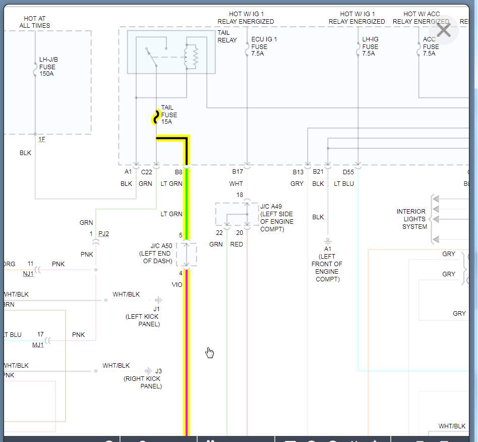

License plate light fuse?
2017 TOYOTA TUNDRA
30,000 MILES • 5.7L • V8 • 4WD • AUTOMATIC
JLOWERY214

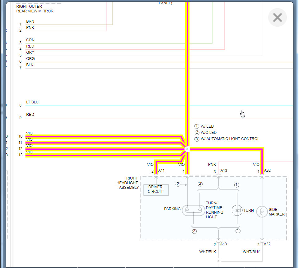

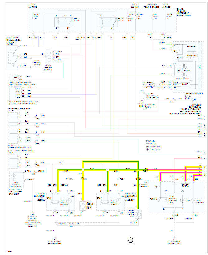

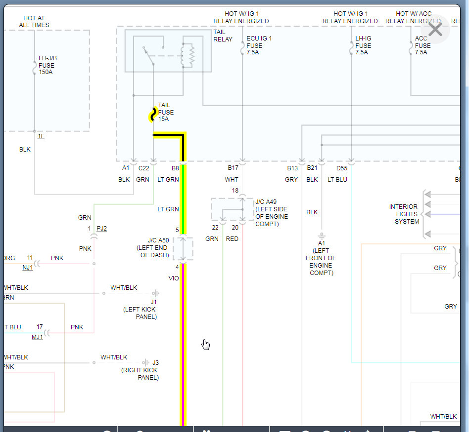

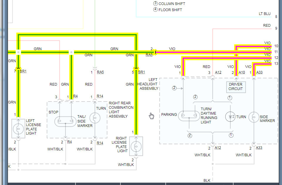

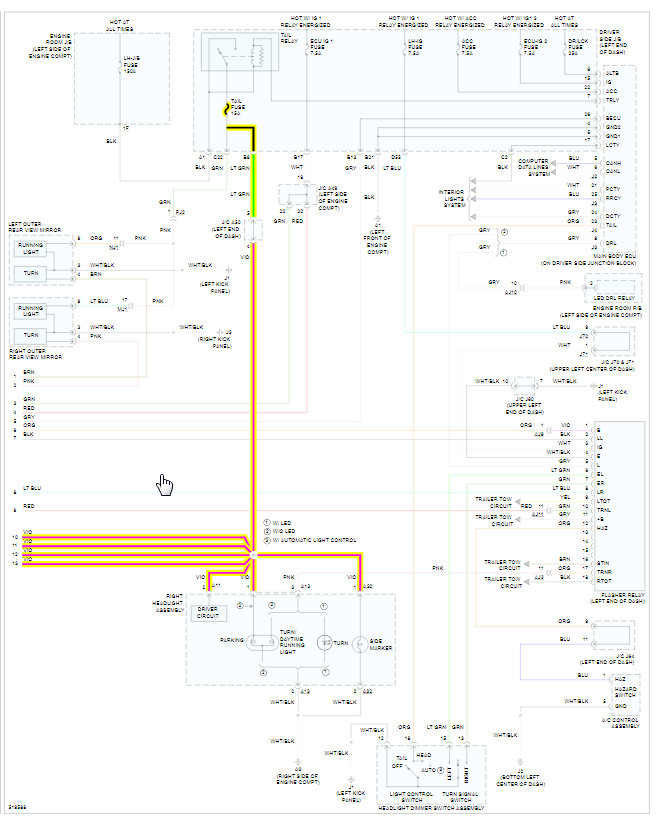

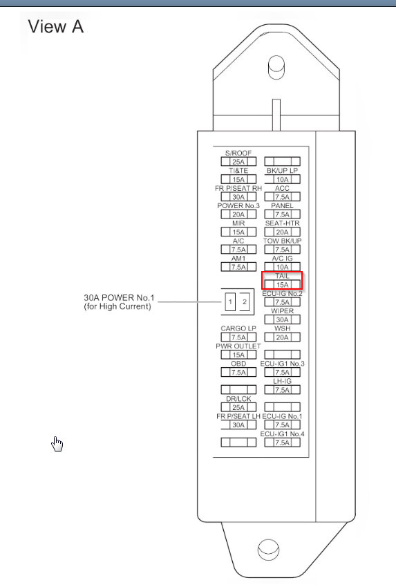

License plate fuse location?
Aug 10, 2020 at 10:56 AM

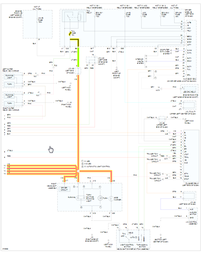

I attached the info about this fuse. It is actually a shared fuse with the taillight system. Check out the diagrams (Below). Please let us know if you need anything else to get the problem fixed. Let me know if you need more info. Thanks
